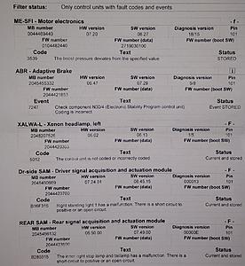

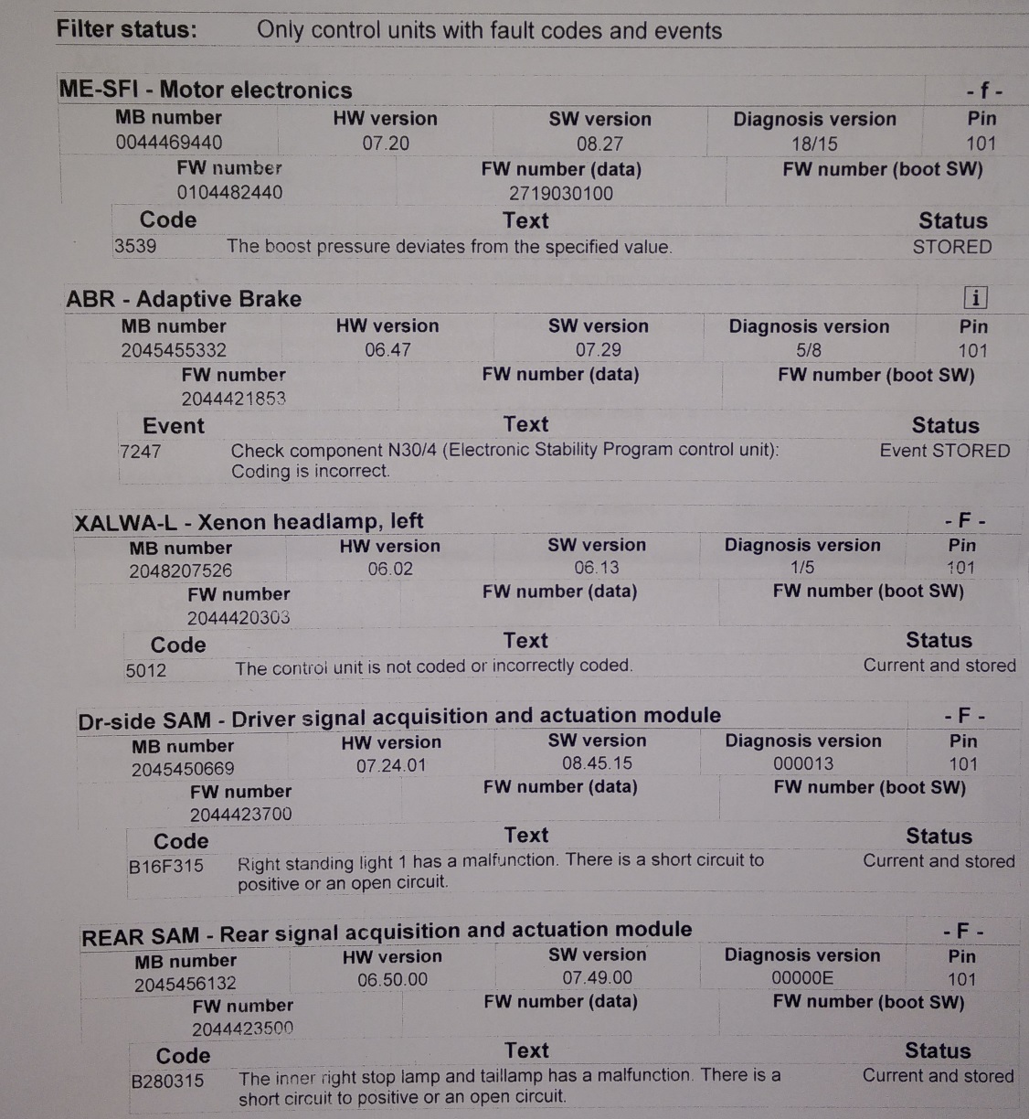

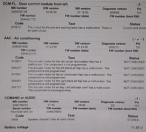

I checked the error codes of my car because I have some problems: (attached pictures)
- When I start the engine there are error on 2 lights (1 right parking light & 1 right tail/brake lamb) << both are working on the car, but sometimes the right parking light don't light at first time.
- When I stopped the car and put the light switch on "0" sometimes the 2 lights that mentioned above are switched on even if the car is completely off.
-On idle, almost all the small lights inside the car is flickering, but are normal when moving or when on battery. (I hope it is not alternator)
I attached the report.
any advices?

Check wiring, maybe you have a bad ground contact somewhere? Or modules going bad.
How did you read those codes?

From a workshop (outside dealer)
He checked the fault codes and printed the report for me
I'll check the wires by my self, let's hope we found something.
