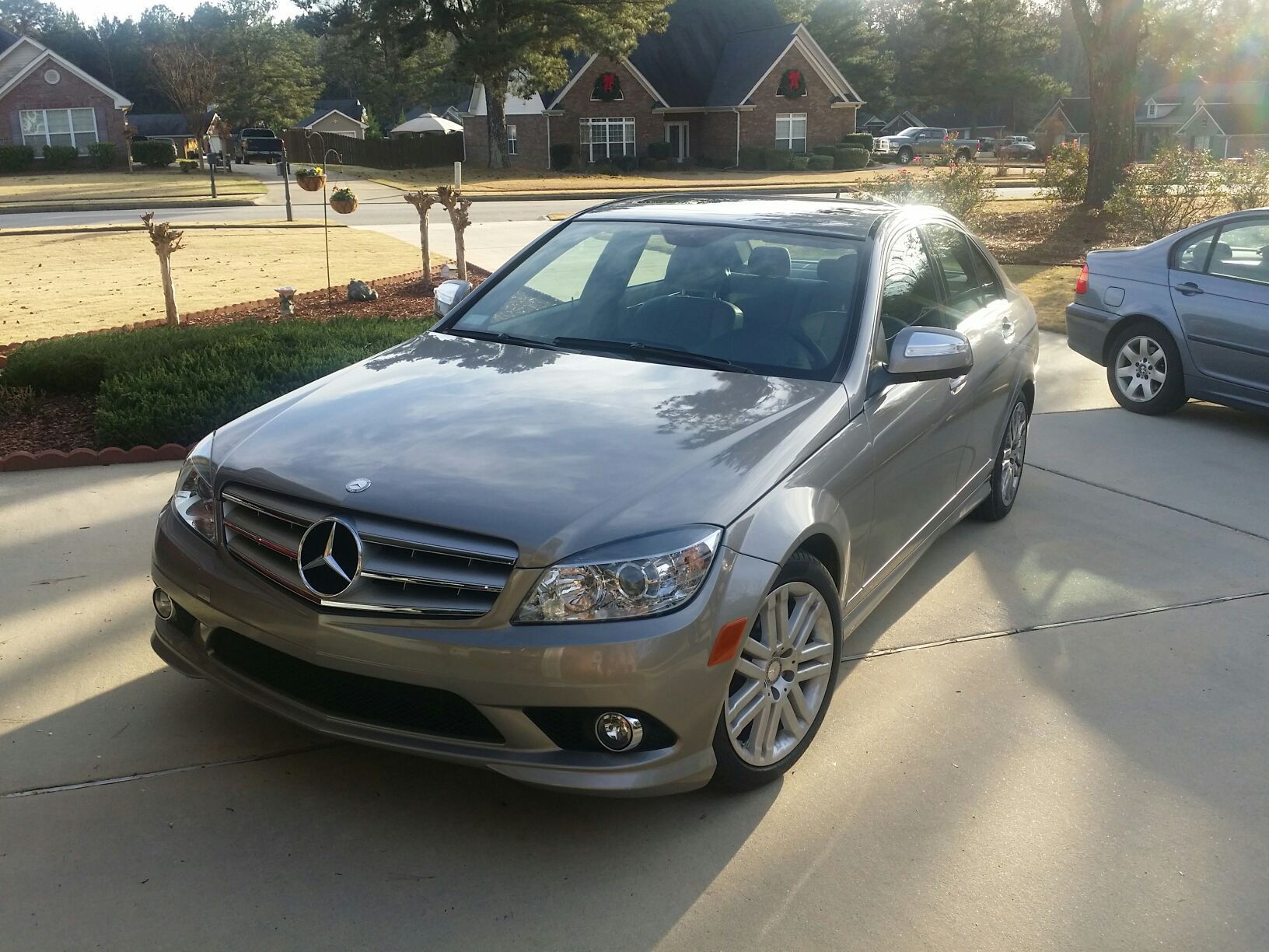

Thanks for any help. I also included a picture so everyone can see my new car! So happy to be joining you all!
