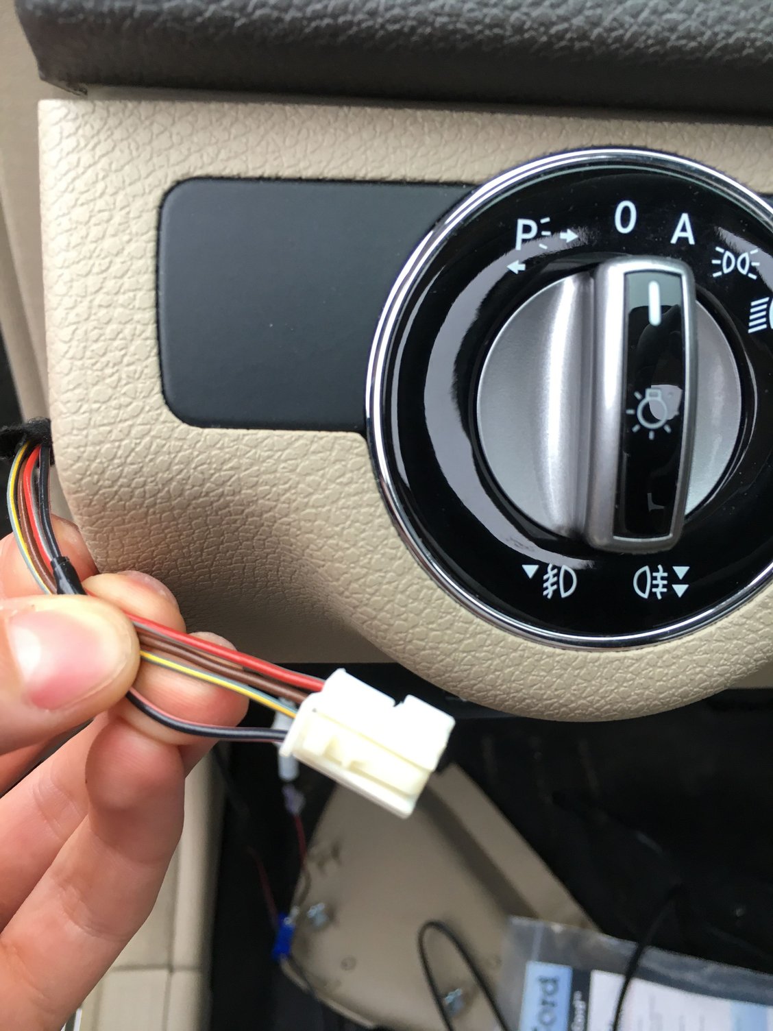

Hello im looking to hardwire radar on my c300 2010. Can anyone tell me which of these wires from the side light switch i can tap into

Figured it out, its the red one to the extreme right in the picture

Is that red one a constant power on wire?

It comes on with key at 2nd position. It powers the light switch so its on whenever the light switch is on. I havent had a problem so far. It seems to be constant as long as car is on
