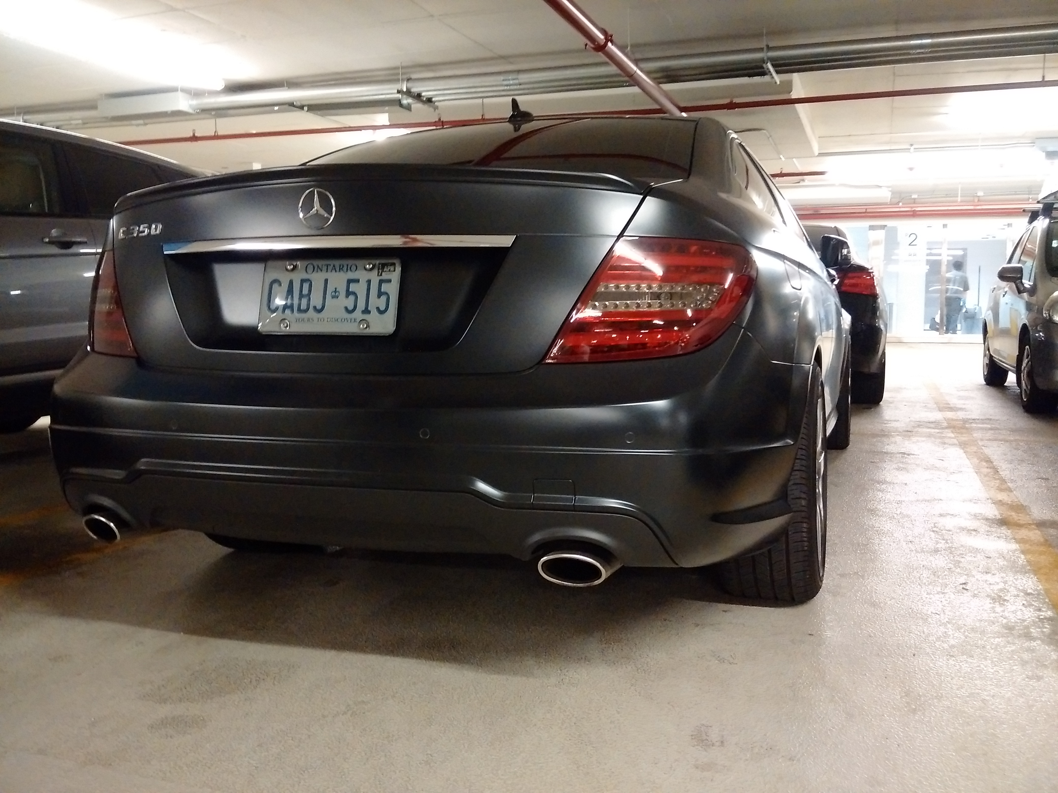

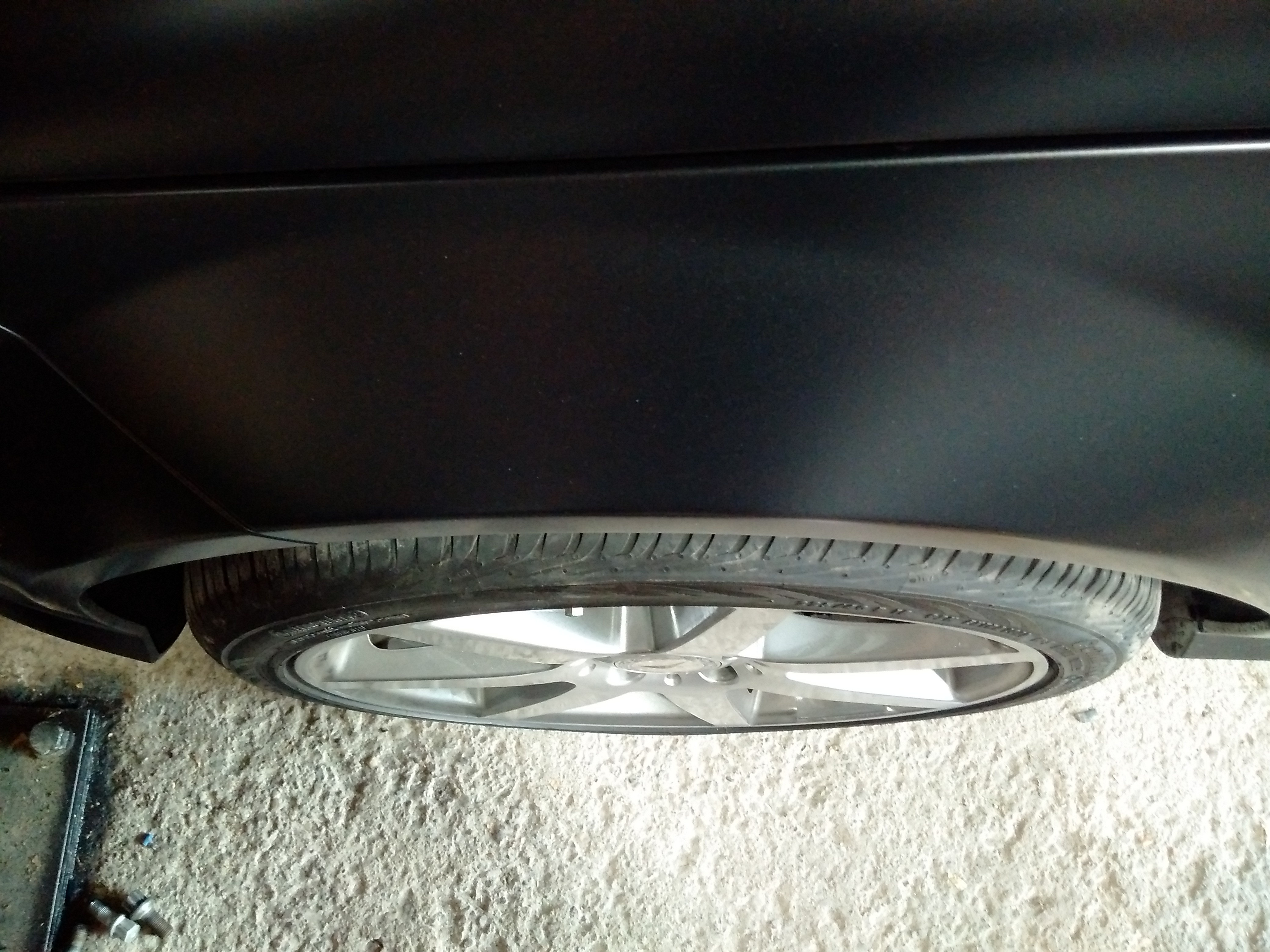

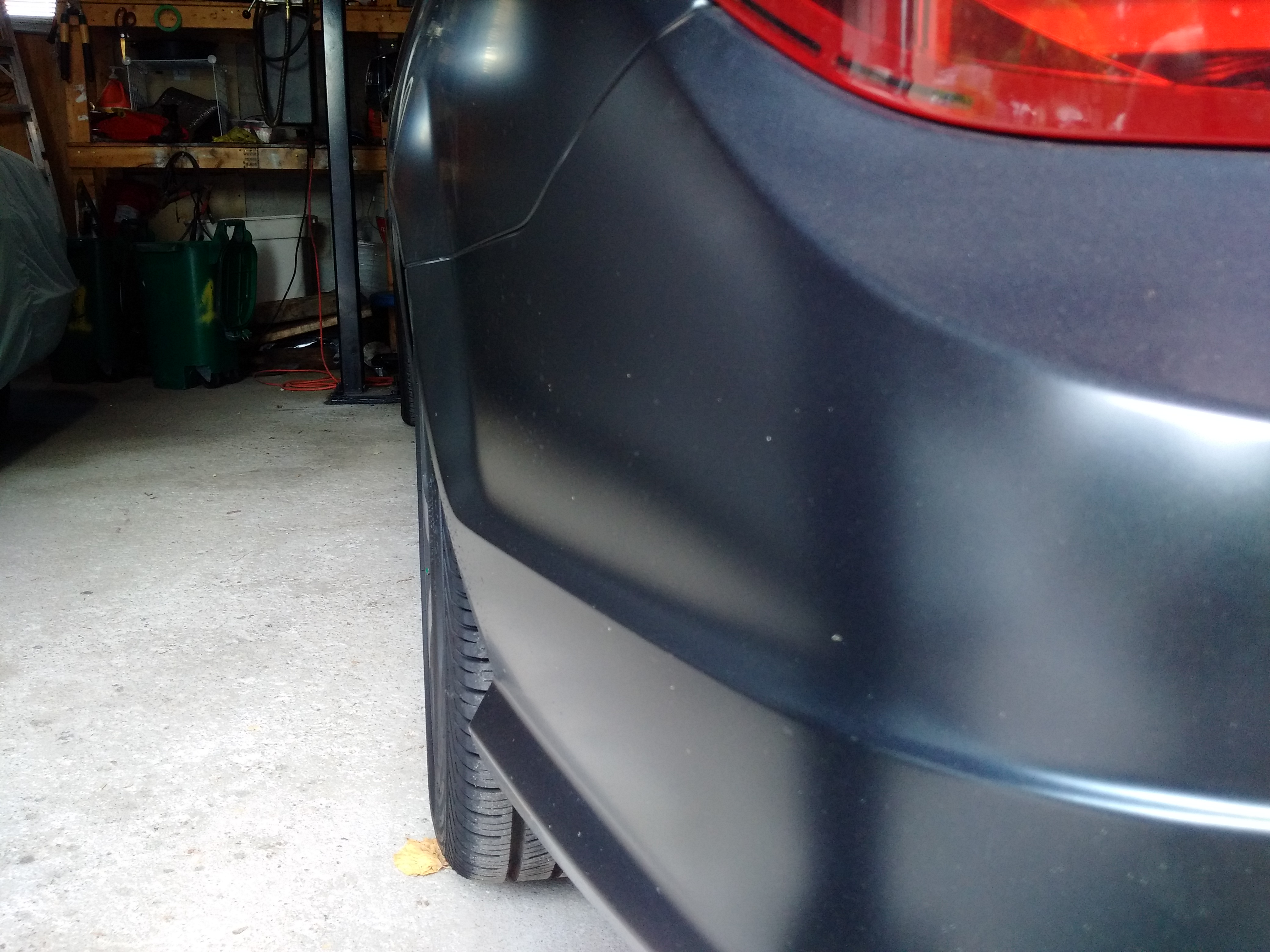

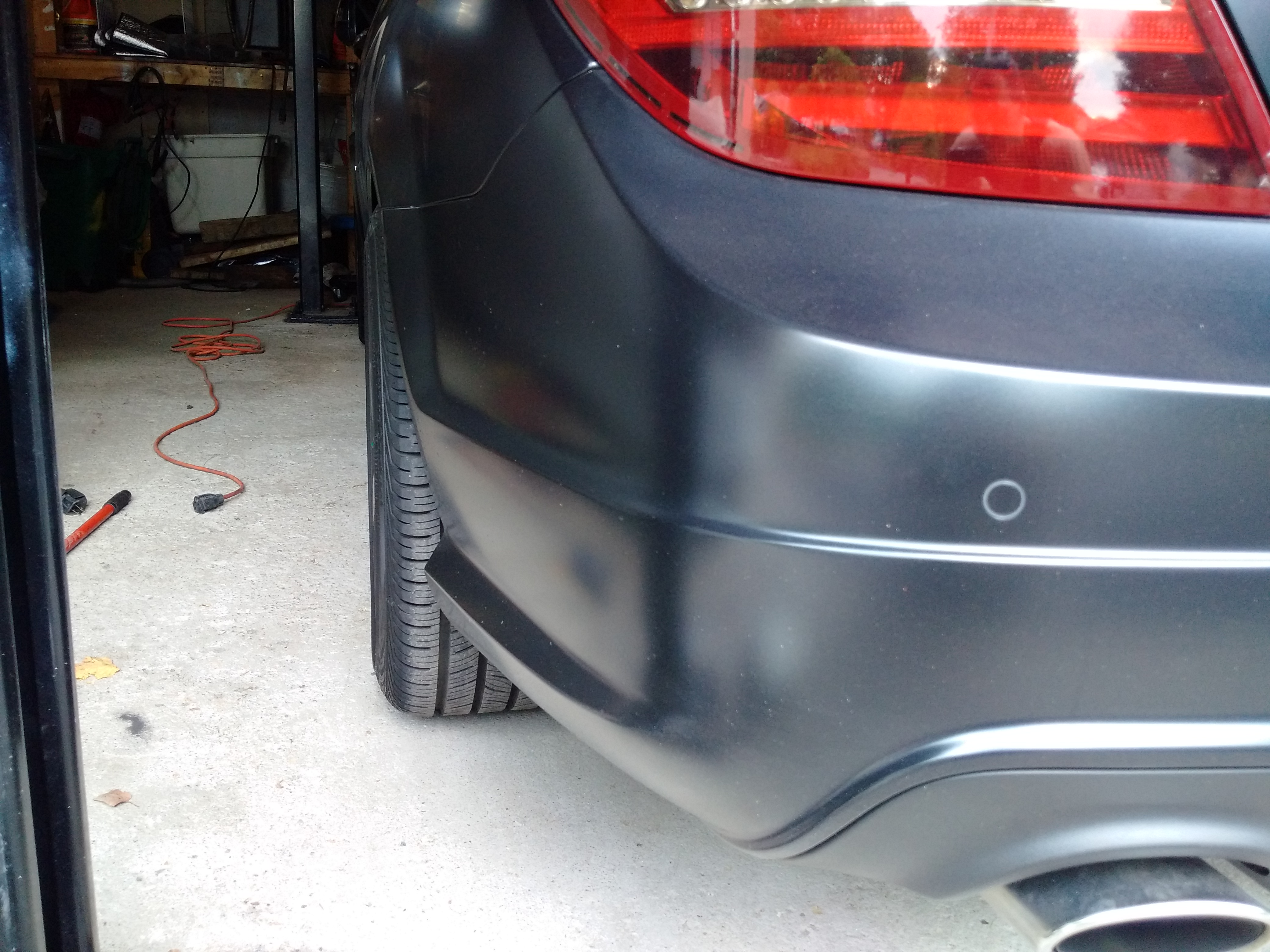

Hi,
I went with 20mm in the back and 10mm at the front.
It gives it more aggressive stance and with the H&R springs on their way it should sit properly, the way i want.
yes, i did went with proper lug nuts for each spacer.
Few pics.

Nicely done.

Looks good now, but I would worry about rubbing once the springs are installed. You have to remember stock struts and springs have a lot more travel than a stiffer coilover setup. I'm probably going to do a 5/10 spacer setup wth my H+R Super Sports.

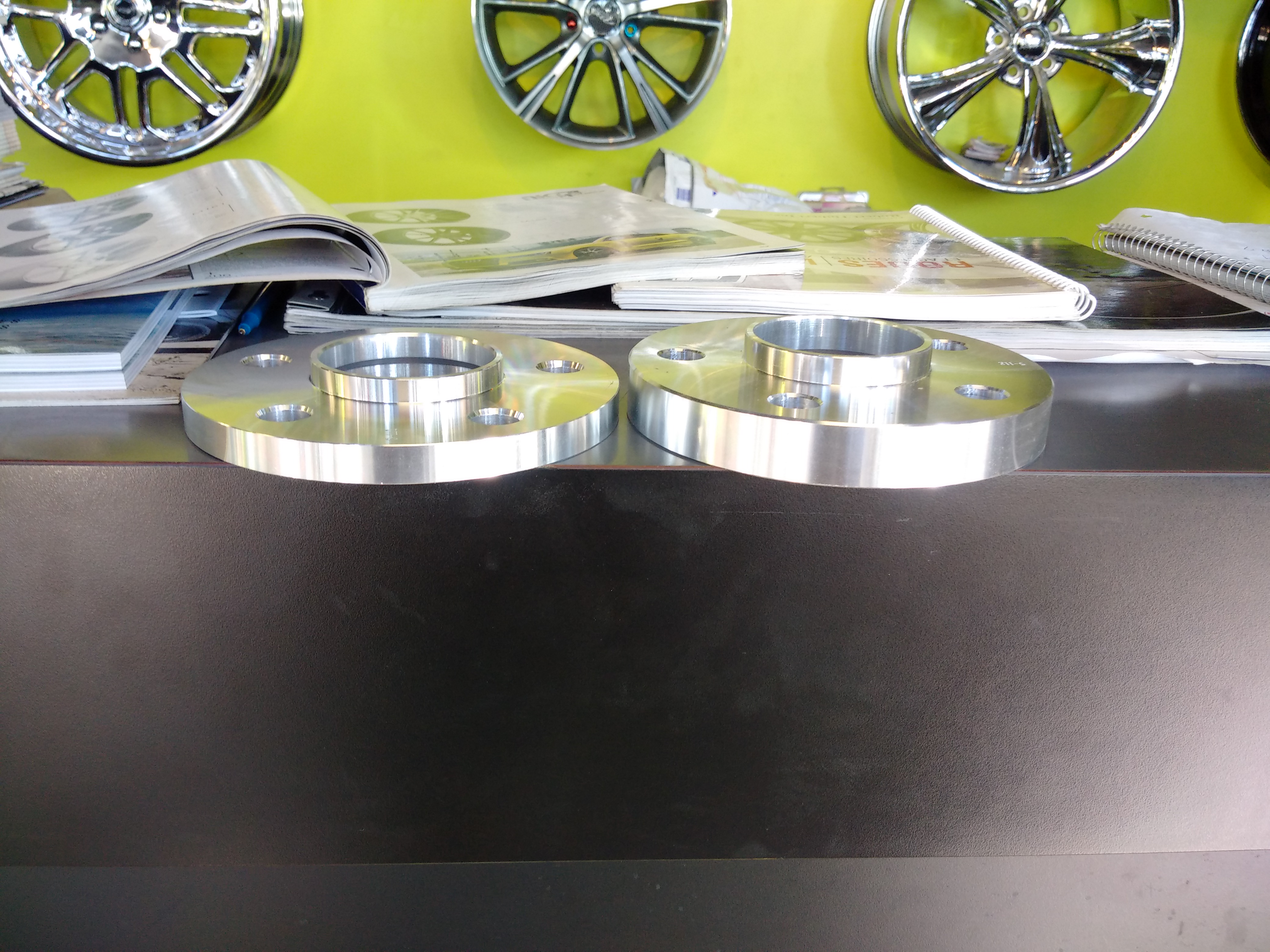

Yes, once I install the springs the truth will come out.
I'm willing to roll the fenders for the look
Here are the spacers

I've rolled fenders on my last 4 cars. I'm not rolling fenders on a Mercedes. The paint eventually starts cracking around the roll and eventually makes its way to the outside of the car/fender.
