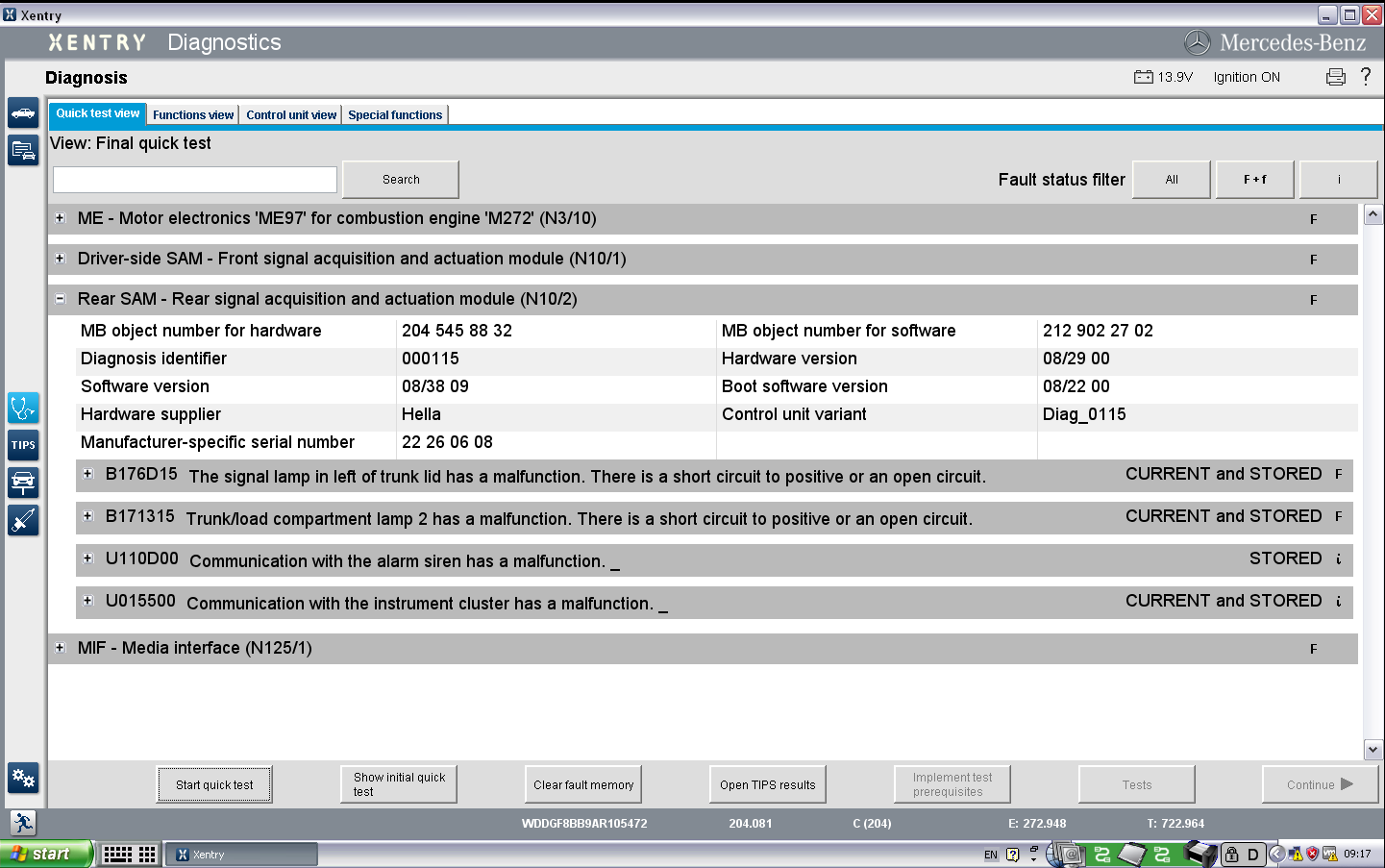

Friend of mine had a guy jump start his 2010 C300 because he left his lights on. The other guy car must have had issues cause he had multiple system fail/short and I need help figuring out if this is likely dead fuses, control units or something else.
These are the 4 systems having problems attached.
Thanks.
Attached Thumbnails Electrical problem after jump.-capture3.png   Electrical problem after jump.-capture2.png

Checked every fuse with a multimeter and they were fine. Disconnected the battery completed for about 20mins and after putting it back on the failed systems came back online. The only problems were 2-3 burned bulbs, he lucked out.
