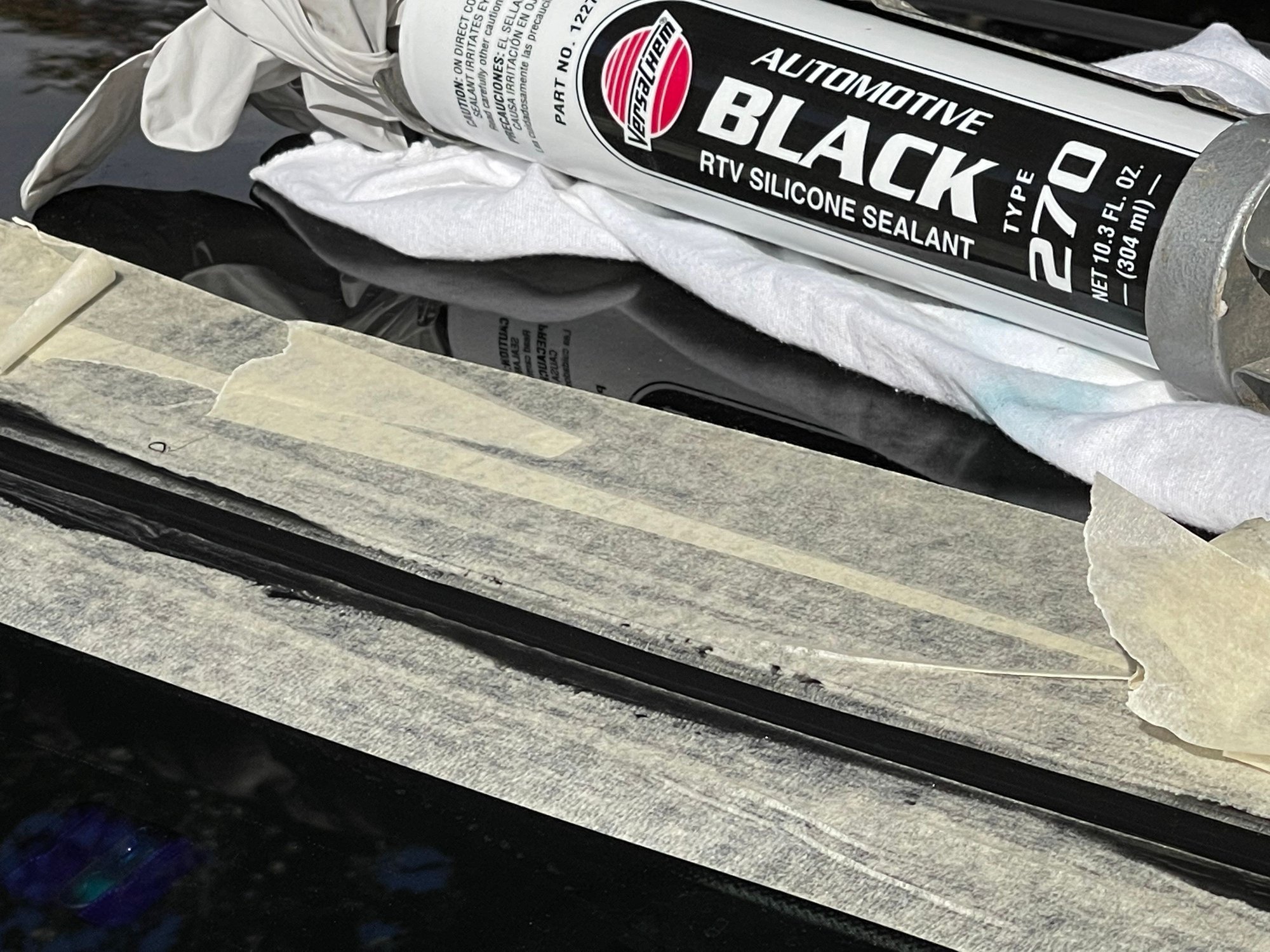

We had another bout of rain here in Southern California last week. My (ghetto) electrical tape fix seemed to work. I can confidently say the leak was coming from the windshield seal and not the sunroof drain. The location on the inside of where it was wet also confirms my suspicion.
So today I used some black automotive silicone sealant and filled up the gap where the windshield meets the vehicle frame. Hopefully this permanently resolves my leak.

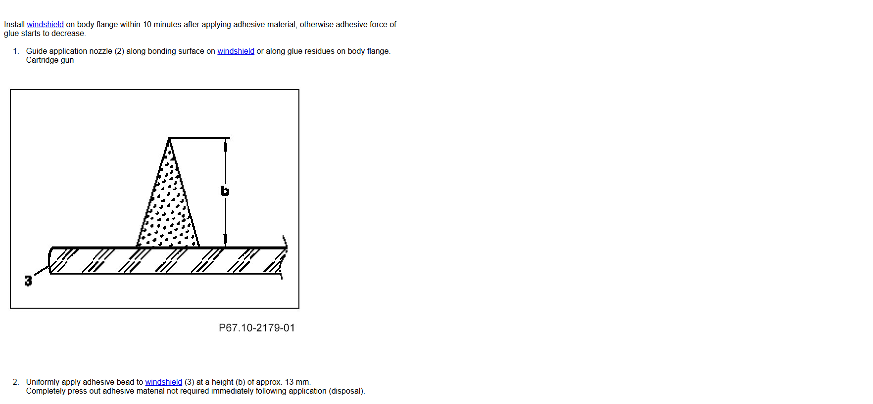

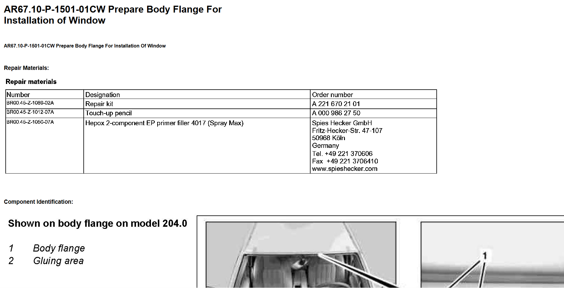

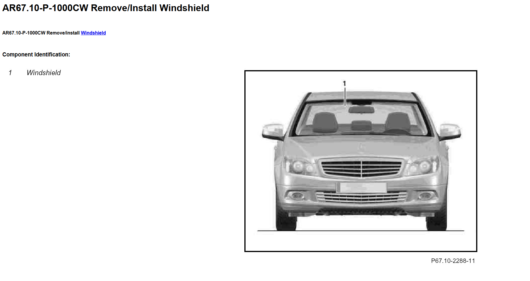

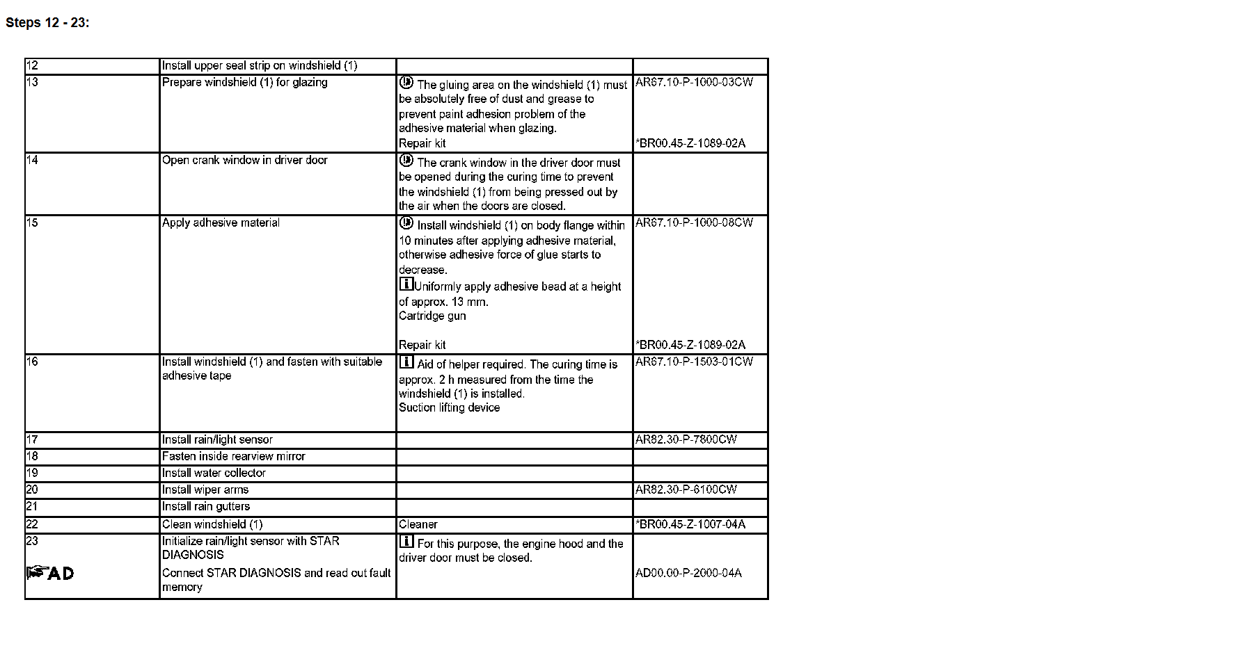

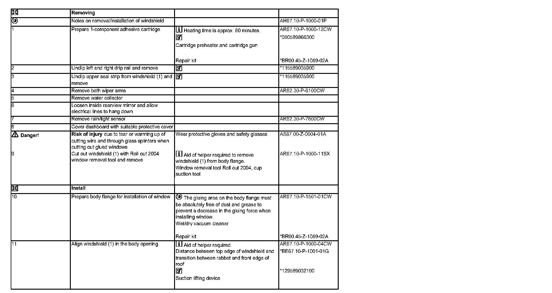

Seems like something that can be done diy:
Not sure which specific MB sealant they use now.
