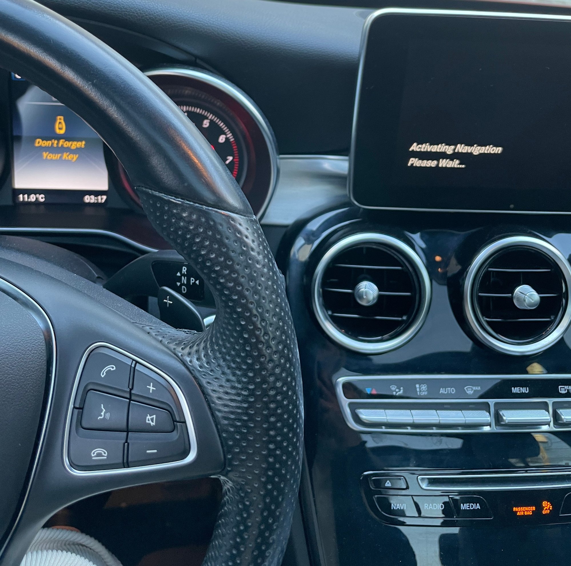

hi there! in the off chance you see this, I’ve had an issue with my nav for a year. It’s been stuck on a rotating earth “awaiting navigation” for so long. It happened randomly one day during a back from local outing. Never any issues or anything. Dealer can’t seem to figure out why and keep saying a software update is needed but that I’m out of warranty? Anyway, I’m in Canada and have a 2017 c300 4matic sedan. If there’s any way you could send me the file as well, I’d be forever grateful.

ill be honest, I think between the two of us, I’m more confused and I’m not car savvy (though I’ve tried to research and troubleshoot the issue). I honestly don’t know where to start - I presume it’s the ntg5 but again, I can’t say. I wouldn’t know where to start in terms of knowing what to ask for for a unit repair or what that entails. Or even if I could do it by myself.
It either stays black or the screen has a rotating earth with activating nav going around. If I don’t exit the screen to media let’s say, the screen stays stuck on that nav screen until I turn the car off lock it and then after a few minutes, unlock and restart the car.

so if it helps I found that it’s NTG5/5.5 if that helps at all. Local MB said again, “you (meaning I) shouldn't have done a wireless update - we (local MB) can’t do much because it’s out of warranty and doing a software update can brick the system.”
Again, I don’t know what a wireless MB update is is, let alone how to do it; I never knew updates were needed until this problem started and I researched what could be at issue, if it’s even a nav update. Total loss right now
