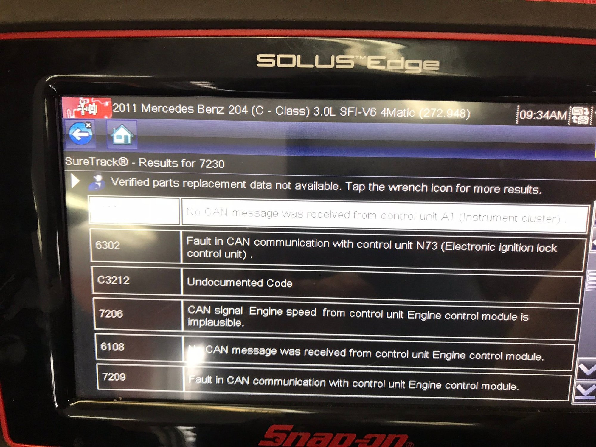

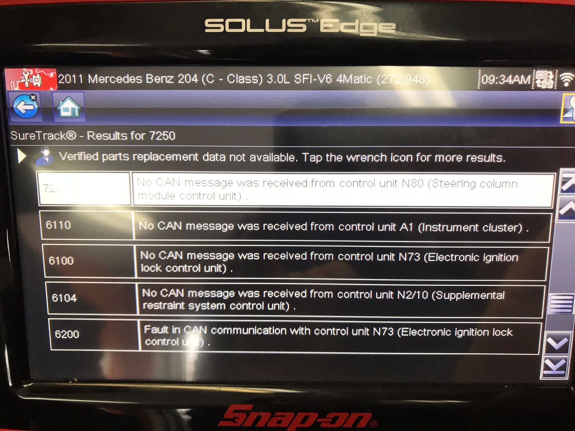

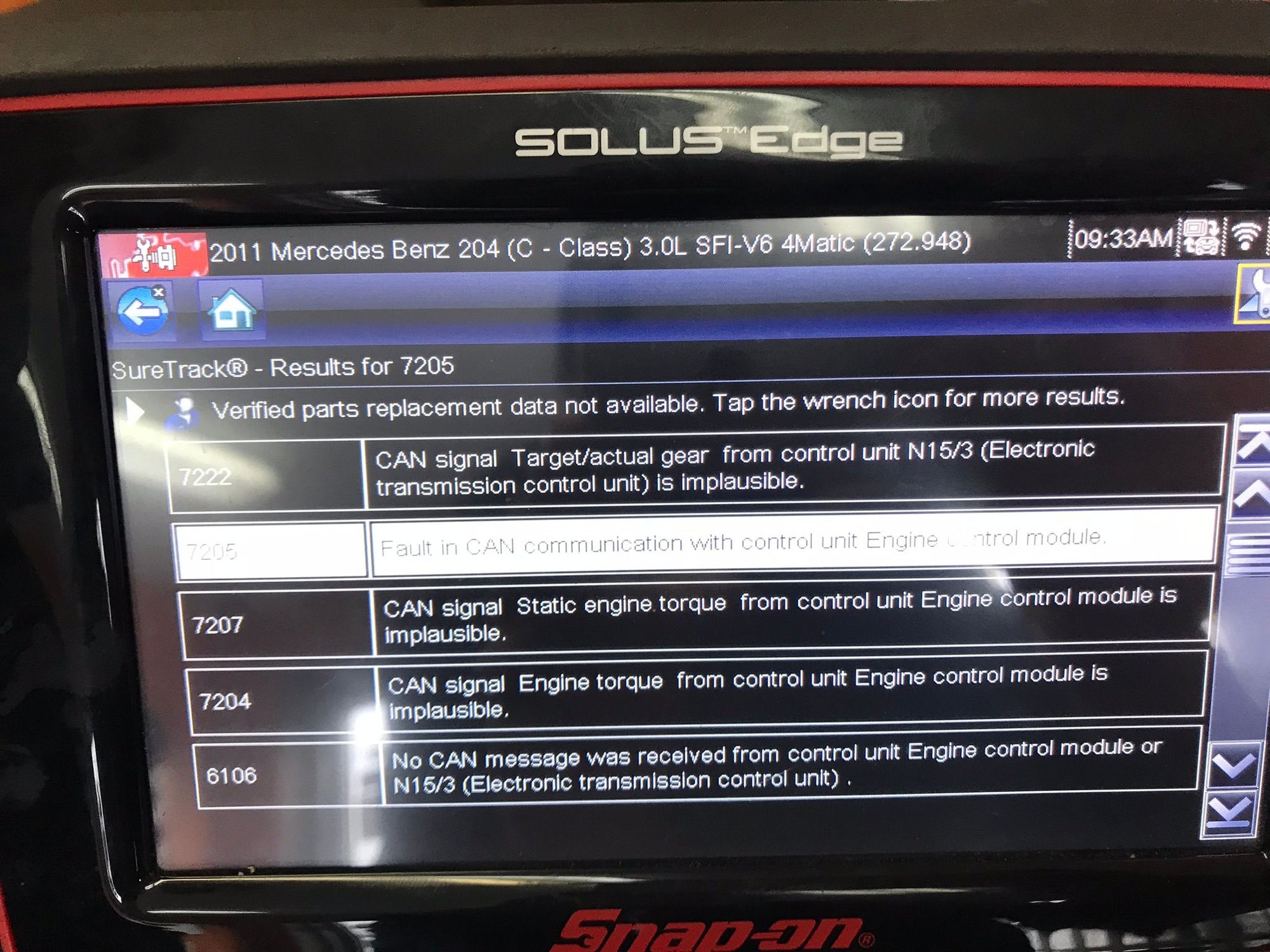

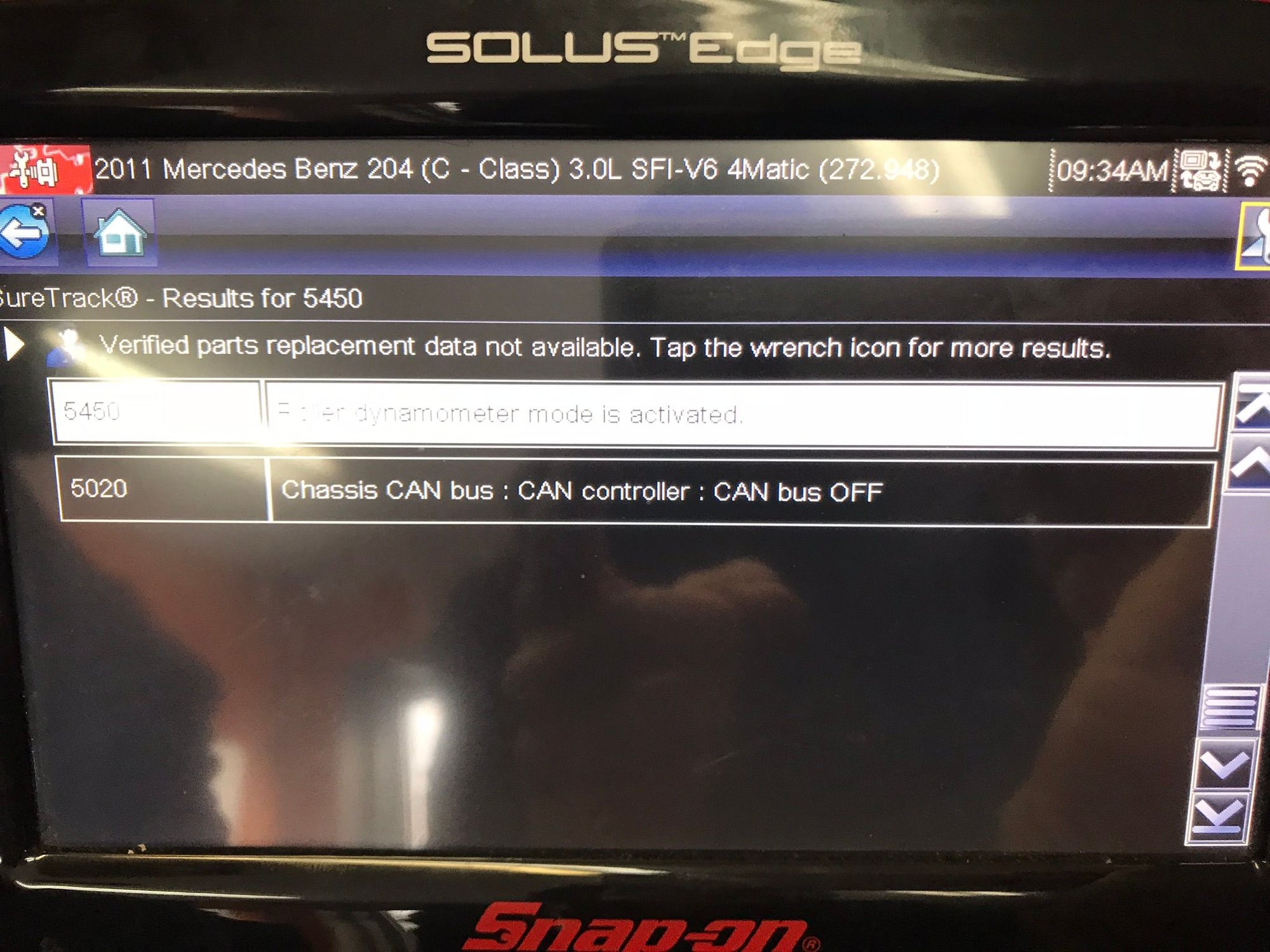

hey guys, went this morning to upload the fault codes since esp,abs flashing, speedometer bouncing, cruise control not working, tire Monitor fault... got thèse code , see attachement.

All the same codes comes back

140k , no title, clean, on our way back from restaurant on thé wighway last note, on thé exit turning right, 70 or so km/h , dry pavement no pot holes, all thé light came on all at once. Then running in straight line, was flashing on and of. Took it this morning to get the codes, hère i am.
note that i took the Can bus box on each side and no wear, water, damage has been seen.

Was the battery ever replaced? This "all Fault" can be normally linked to either a bad connector or a battery that is strong enough to start the car but has a low operating voltage. Other cause could be a bad alternator.
