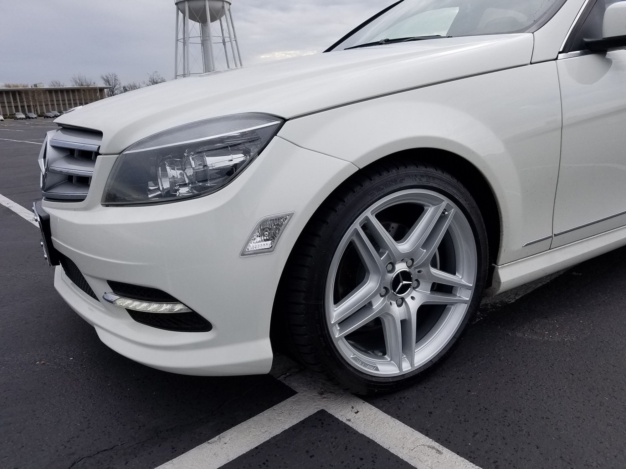

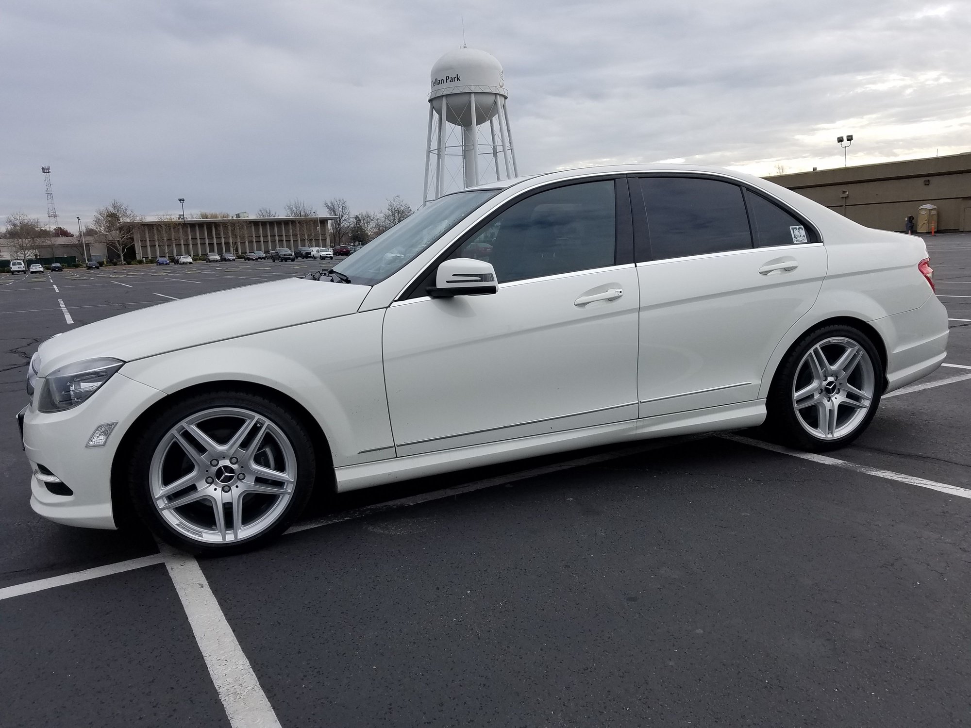

Originally Posted by 777benz
Front: 8x18 on 225/40/18 50mm offset
Rear: 8.5x18 on 255/35/18 54mm offset
Wonder why MB staggered this model.
I run EXACTLY this set up on my wife's C300, 18" AMG wheels.
Staggered for better looks and supposedly performance.
I run a staggered set on my S550 as well. Actually, all my cars have staggered set up, so did all cars I owned in the past. My daughters BMW 330i has a staggered set as well.
NO 255's in the front!!!!!! I think the 225's are plenty wide on the front.
