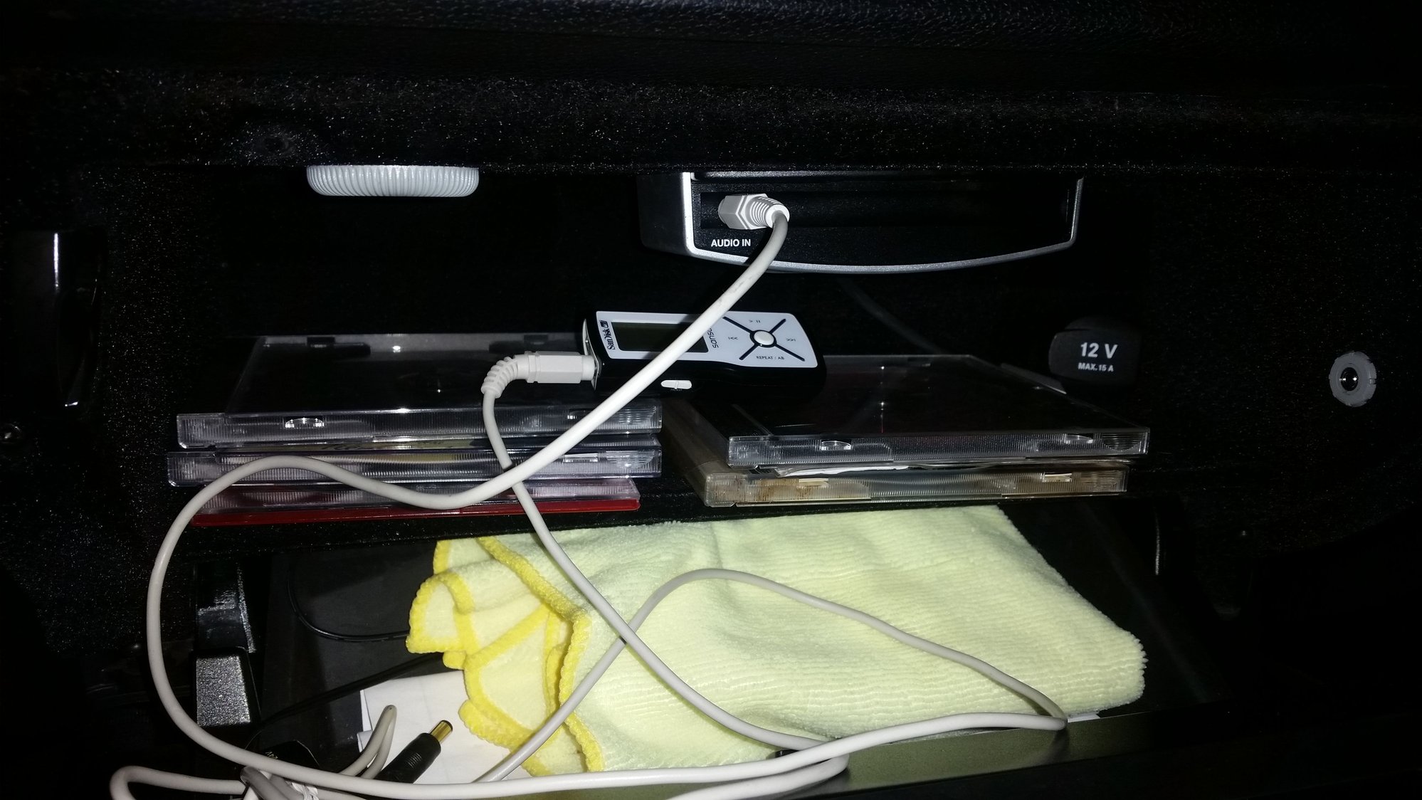

Were you able to select AUX before installing the 10.25 screen? Do you have an audio port in the glove box?

hi, I have an AMI port only, so several adapters for aux, usb etc. I was able to select aux which appeared after first installing the screen. I disconnected it to hide wires etc and after reconnecting aux no longer shows. In the engineering menu it is showing audio aux on, but greyed out to select. Hope this info helps.
