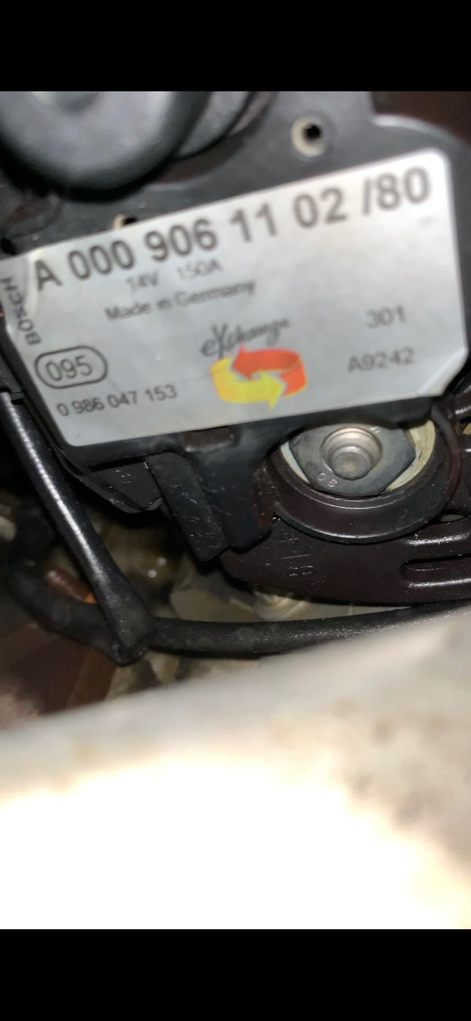

thank you all for all your support, i replaced the alternator and problem fix.
some of the issues i ran in to just in case anyone has this problem.
1. Radio would power off during driving time, it will not power back on unless you restart the car.
2. "ABS and ESP currently unavailable See operators Manual " message will come on just before it starts loosing horse power.
3. Car will die and jumping the battery will start the car again.
##Note# there was a voltage regulator on the alternator that i could have bought for about $95 but the use part at the junk yard was $60 and it worked.

Curious how easy or difficult it is to replace the voltage regulator? Do you have to take the entire alternator out of it? The nut shown on your picture would represent a problem if the entire unit is not taken out of the car. I took a good look at my voltage regulator yesterday, it's a very tight spot on a 2008 C300 Sport.
