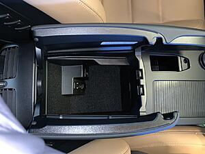

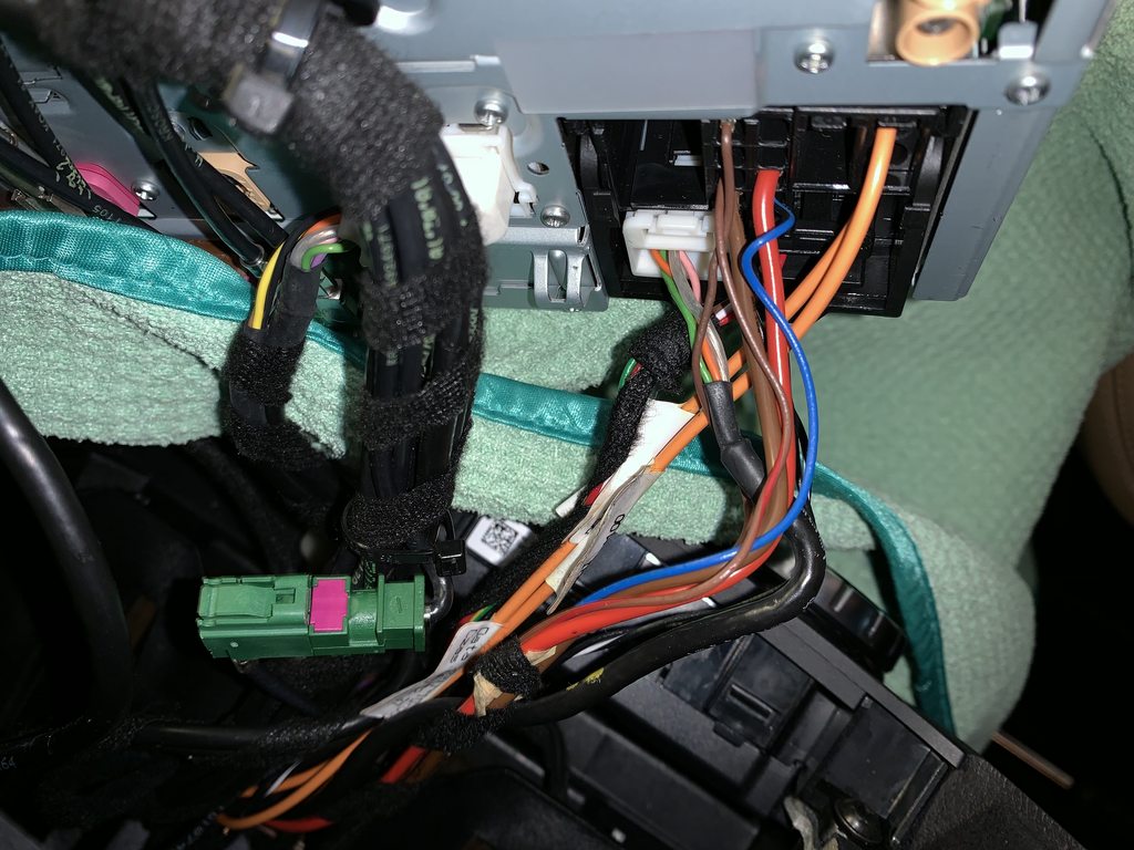

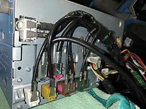

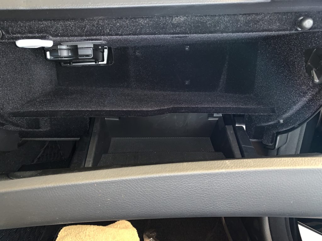

I have a 2011 facelift W204. The car is originally from Japan, so it is has a different COMAND NTG unit than Euro/US. It has AUX in the menu and I am able to select it. But I can't find the AUX-in cable anywhere. Not in the glove box, not in center console(only USB and a strange other connection of some kind). Any ideas??

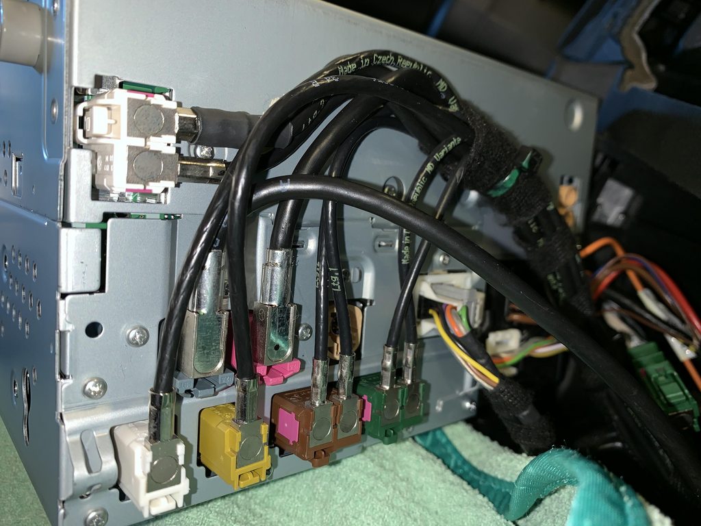

I have also removed the COMAND to see how it looks at the back. Anyone who knows what to look for here?

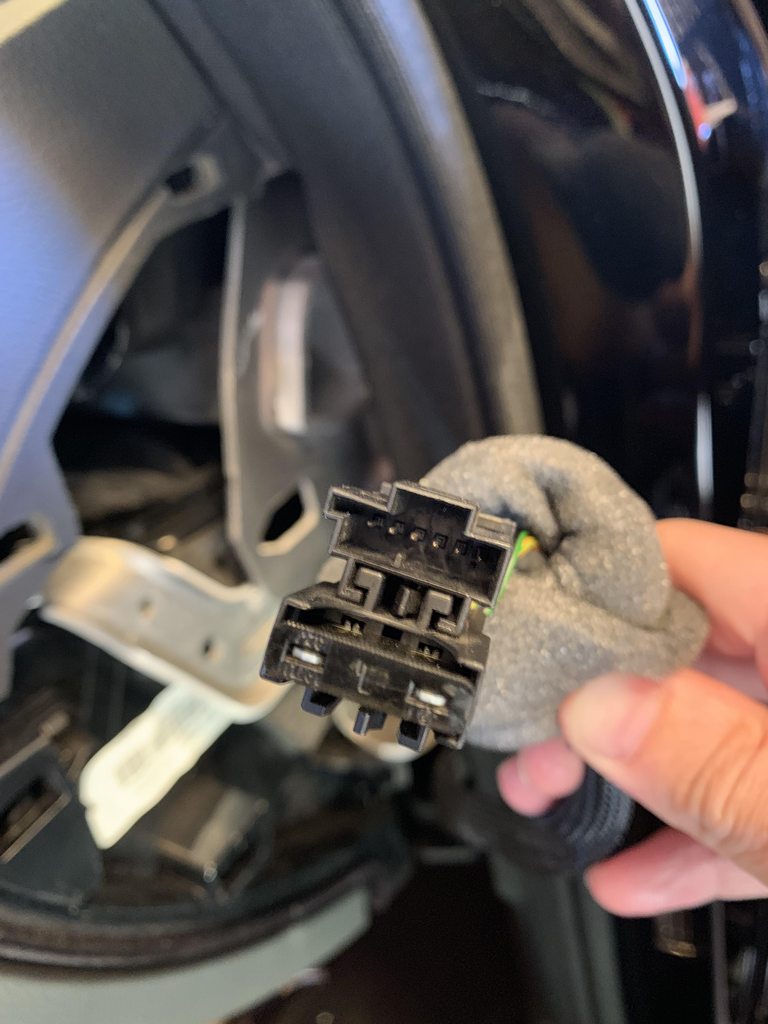

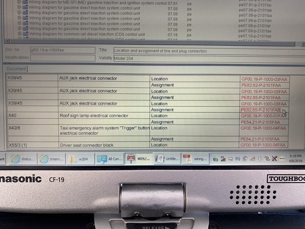

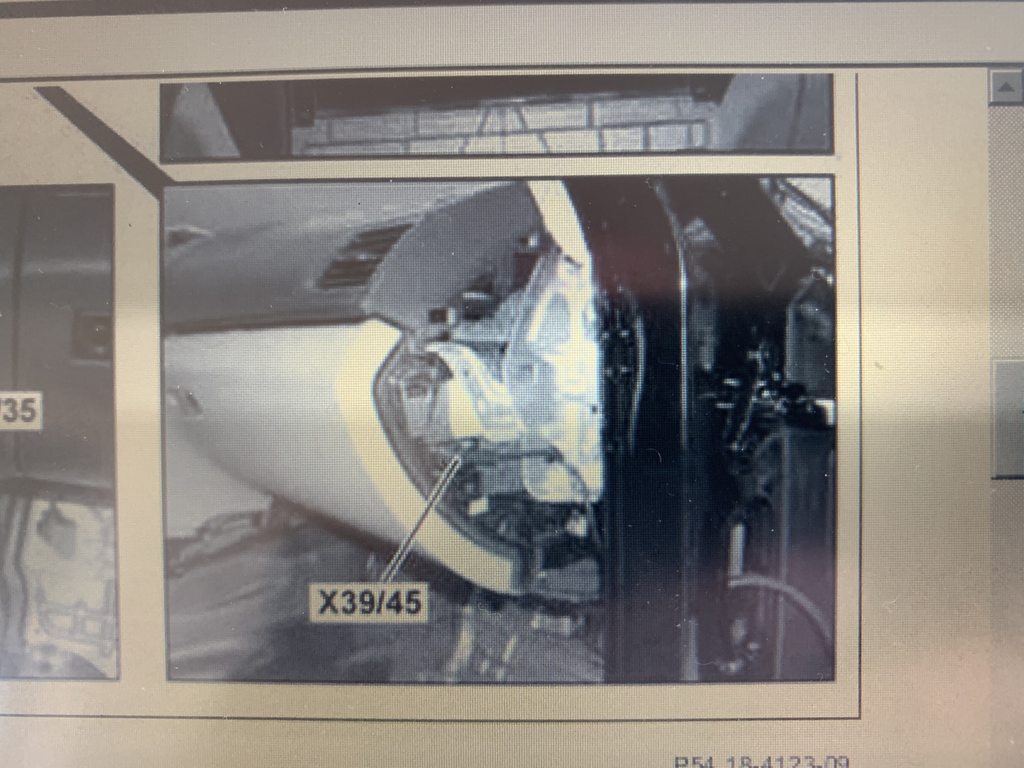

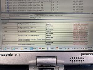

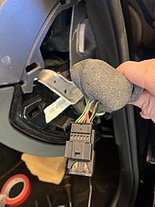

Ok - I managed to find that the AUX connector for my car is called X39/45, and should be located in the dash far right against the passenger door. So I remove the cover on the right side of dash and I find a loose 6-pin connector with a 1 amp fuse built in to it. Is this the correct one? That is the only thing I could see in there at least. And if it is, what wires shoud I use, if I need to adapt this into a 3.5 mm jack female connector? As far as I know there are only 3 wires in a 3.5mm jack?
