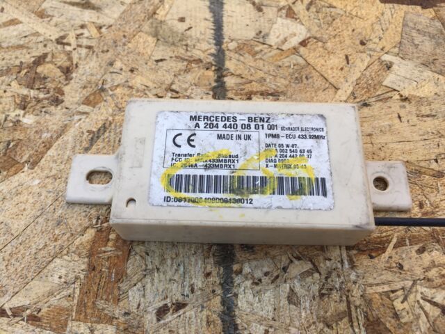

2012 C300 TPMS Control Module/Unit Location "TPMS Monitor Inoperative" displayed.
W204 TPMS Control Module/Unit is located in the trunk under the spare tire. See picture. Clipped in the new one, "TPMS Monitor Inoperative" message disappeared.
is it in the same location for c300 2008
