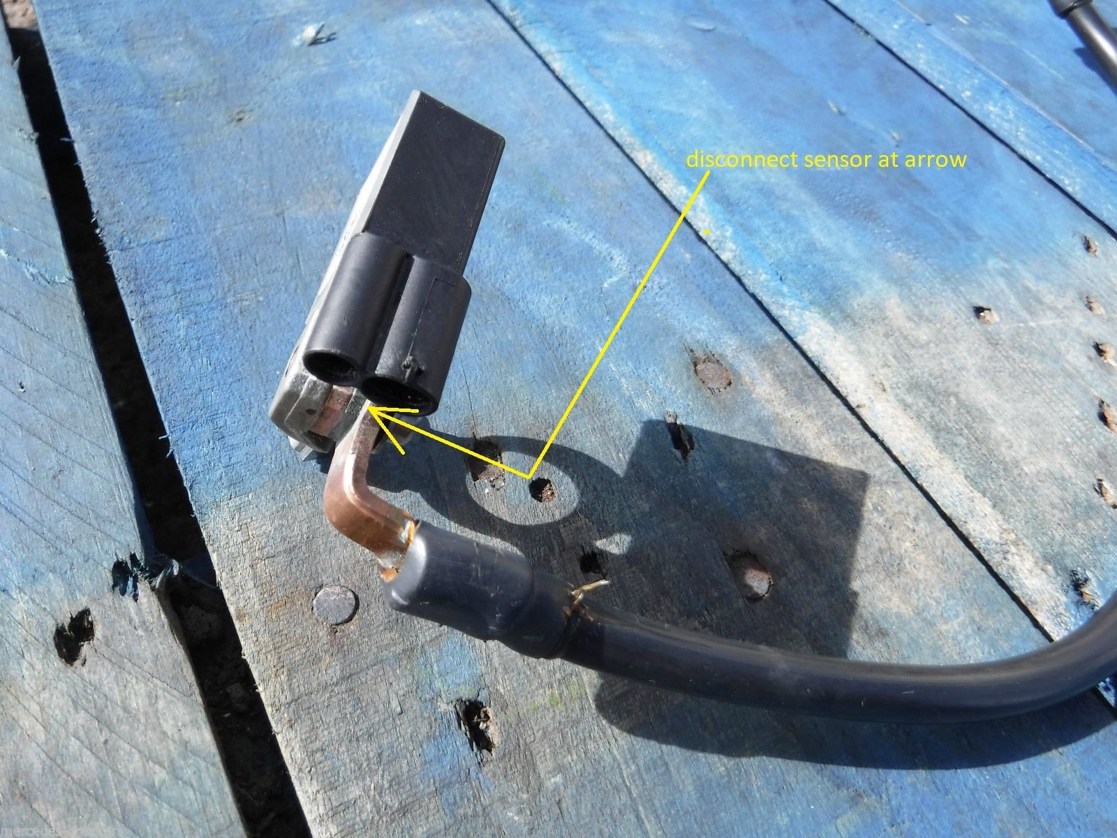

If you are set on using the stop/start system and outside of the warranty then it will cost to have it fixed, certainly if you go to main dealer for diagnosis, if you are not bothered then here is a simple way to deactivate stop/start, just disconnect the sensor attached to the negative rail of the starter battery, you will loose brake hold though but that`s all, other than that the car will run normally and show NO cel. I run a 2015 SLK and a 2012 C-Class coupe with this sensor disconnected, I just cannot stand the system. With this disconnect your battery will last much longer.
