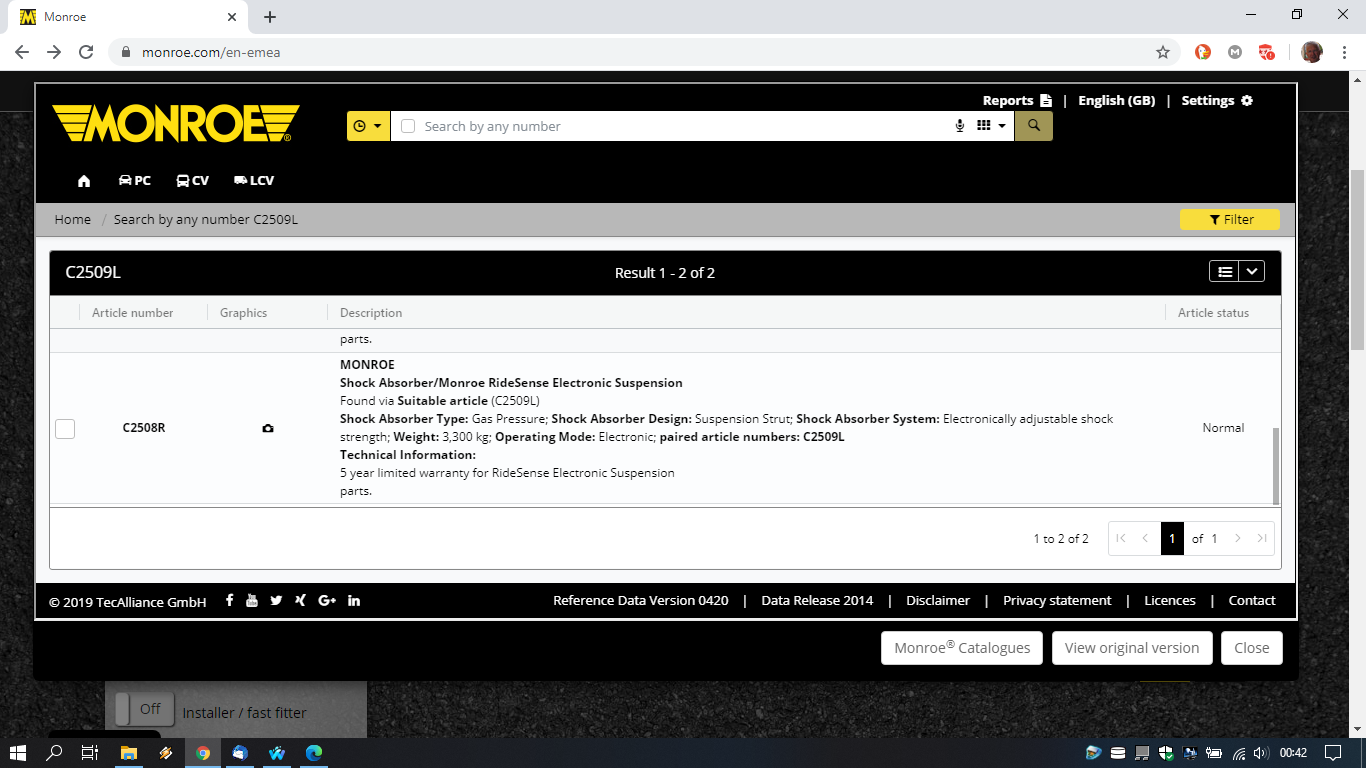

You're being ripped off : https://www.bestpartstore.co.uk/1085...shock-absorber

Good find - but I took his C350 to mean he is in the USA. I cannot locate this part anywhere in the USA? Looks like C2508R is right and C2509L is left.
Yes, the struts are handed.
Now the OP knows that they are made by Monroe he should be able to chase down a supplier in the US, assuming you are correct re. his location. You can get C350 CGI in Europe too :-))

The Mercedes Shocks/struts are made by Monroe. The model number for front is C2508L and C2509L. Model number for rear is C1510 and C1511. They are about half the price.
