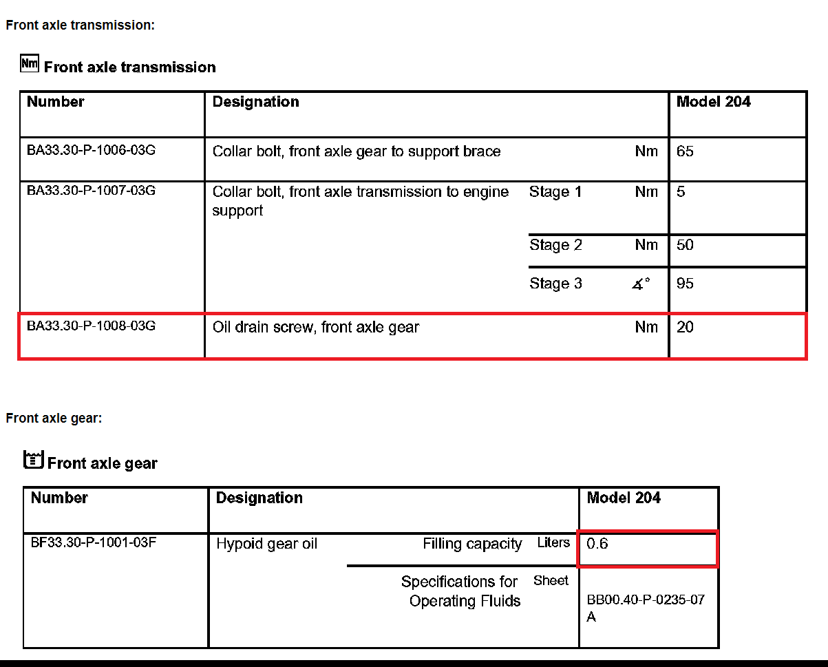

I serviced the front and rear differentials in my 2010 C300 4matic and will add and confirm some things.
Front differential is 0.6 liters of fluid all models. Pump in the new fluid, using a new sealing ring on the drain plug. Torque drain plug to 20nm. Sealing ring part# 007603012102, which is the same for the transmission drain plug.

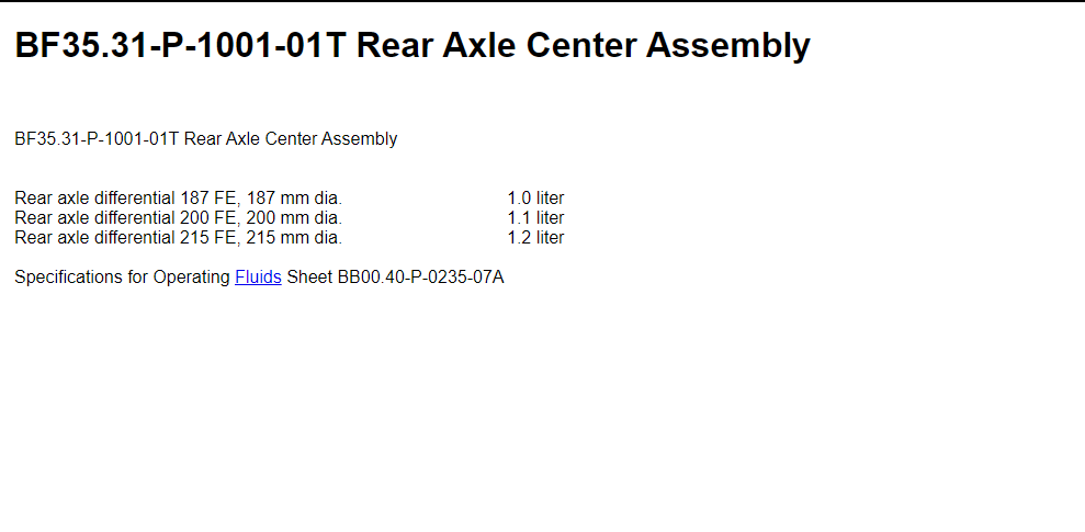

Rear differential is typically 1.1 liters. Though there are 3 listed. Fluid replacement is pretty straight forward. The instructions do mention using a sealant on the drain plugs when re-installing.
I bought two bottles of the Febi 75w-85 GL5 gear oil and that was enough to do the front and rear differentials. I used Febi since it meets the MB specs and I can get it locally no shipping charges.

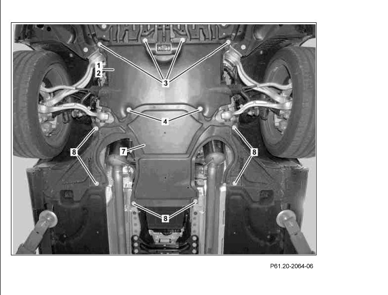

Also the torque spec for the undertray screws is 17nm / 12.5lb ft..
