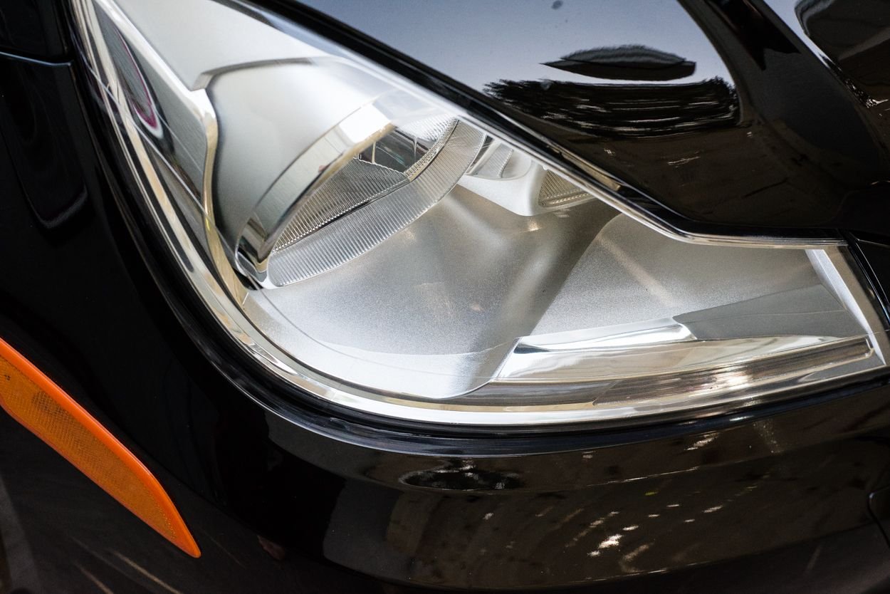

Got the car back - $7,500 later, they did a really good job - with one exception. The headlight they ordered did not match the OEM headlight.
Apparently they come in a light silver and a "black" which is more like dark grey (I hope). So they have ordered the other headlight.
Can anyone confirm that the correct name of this OEM headlight is in fact "Black"
Bright silver - replacement
Dark grey - OEM

Repairs look good, the replaced the headlight with the correct "black" headlight housing, now there is just a new AC humming sound that was not present before the wreck, so taking it back. This is exactly how it sounds, especially on humid days.
