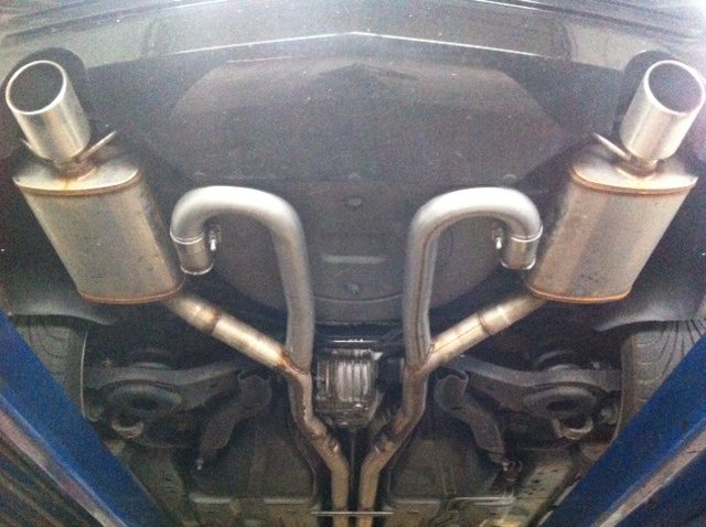

The Maganflow mufflers went on today.... I already had the X-pipe mod. The drone at low RPM's is ridiculous.
Advice? I've read H-pipe, or stock res? A little bummed at the moment, maybe I'll get used to it? Not sure though tbh.

Where is your x pipe located ? More towards the rear of the car or is it closer to the cats? You can have some custom j pipes welded next to the mufflers, that usually fixes drone without changing the overall sound of the exhaust.
