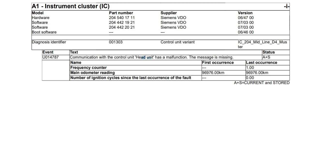

Hi. DEAR FRIENDS.
I have this kind of problem on my car.
Who can help me?
Thanks.
Best Regards.

The radio is working but screen not working, and when screen not working on the stereo unit Bluetooth function is not working and on the steering wheel some buttons not working or not active and on the cluster GPS, Bluetooth and media functions not working.

check fuse 11 in the front sam its a 7,5 amp fuse
