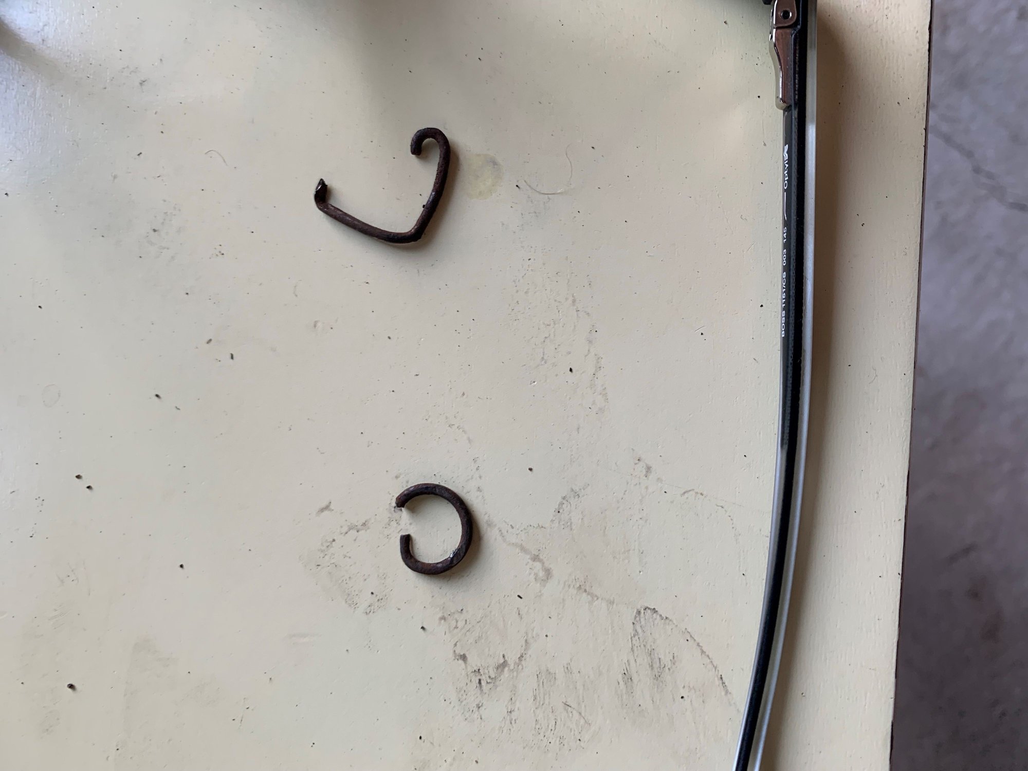

Thanks for your input! I decided pull the wheel off again, but this time I removed the caliper to get a better view of the situation. This was what I found:
I contemplated taking off the rotor off but decided against it since it was most likely still holding the parking brake mechanism in place. Rather, I was able to pry out the broken pieces that were scraping against the disk. The good news is that the noise is now gone and the parking brake still works, though I'm sure most of the car's weight is being held by the other side. I know I'll have to take it in to get fixed properly, soon.

That's ugly! Glad you found the root cause of the noise. One of my older cars that was used in Iowa on salted roads had drum brakes. The rear drums were rusted solid to the axle shaft and required a wheel puller and a sledge hammer to remove on the very 1st brake job. You may save your sanity by referring the work to a pro shop.
