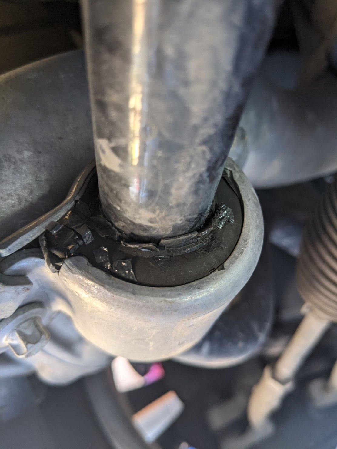

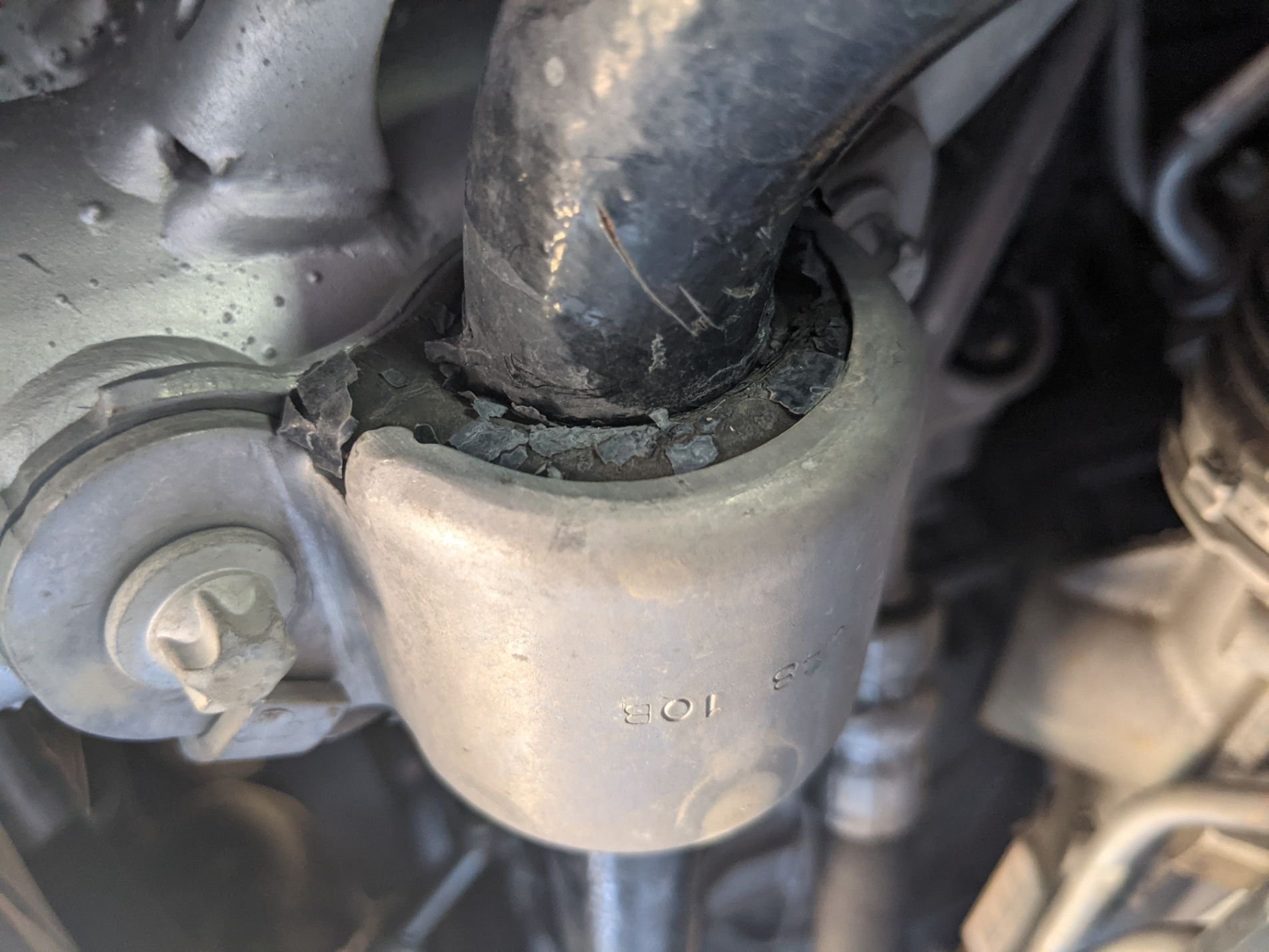

New to me 2011 with 40k miles, Doing the B service myself and noticed the stabilizer bar bushings look wonky. Like they might've had a plastic coating that's flaking? These look normal or time to replace?
Side one
Side 2

They have that coating on all the bushings. Keeps the rubber surface from oxidizing, particularly as it sits on shelves waiting to be installed or sold. They crack in usage, but that’s fine. Keeps bushings soft until you drive it off the lot. And depending on climate and usage may not even start cracking until years later.

Good deal, thanks for taking the time to respond and clarify! Not something I've seen before

Side note, sleazy dealerships will often use that as a reason to recommend replacement. They’ll take pictures, even point it out in person. If you didn’t know any better you’d agree with them. Had that done to a couple neighbors who asked me for a second opinion.
You’ll see that on axle shaft boots, steering boots, bushings and even some hoses. I wouldn’t worry about it.
