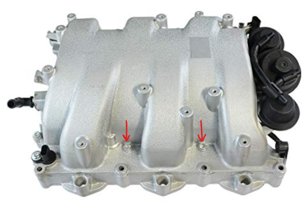

The highest point where said oil leak can be observed is on the 2 torx screws indicated by the red arrows in the reference picture below:
Not sure if it's possible to leak from there. The intake is constructed from 2 pieces of aluminum cast bolted together. I'm wondering if my intake manifold has a bad seal between the 2 parts.

Clean and see if its not just residual oil before you remove the manifold for nothing
