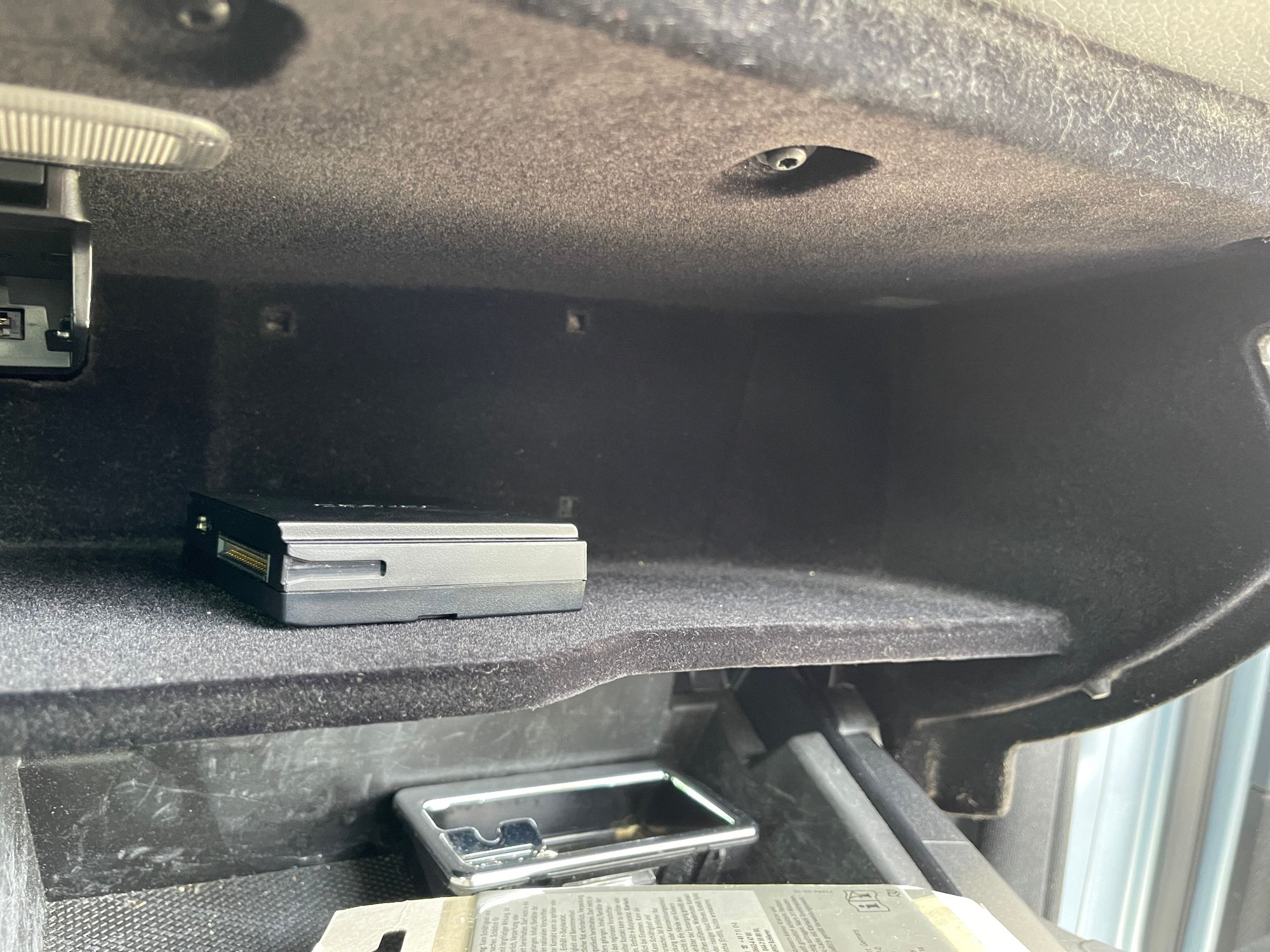

in the dash glove box, all i have there is the navigation/map module. its located in the same location where i've seen [other mercedes vehicles] have the MMI port. i removed the module but the port is not the same as the MMI port. totally different.
Could this have been the MMI port.... but they reconfigured it for the map module?

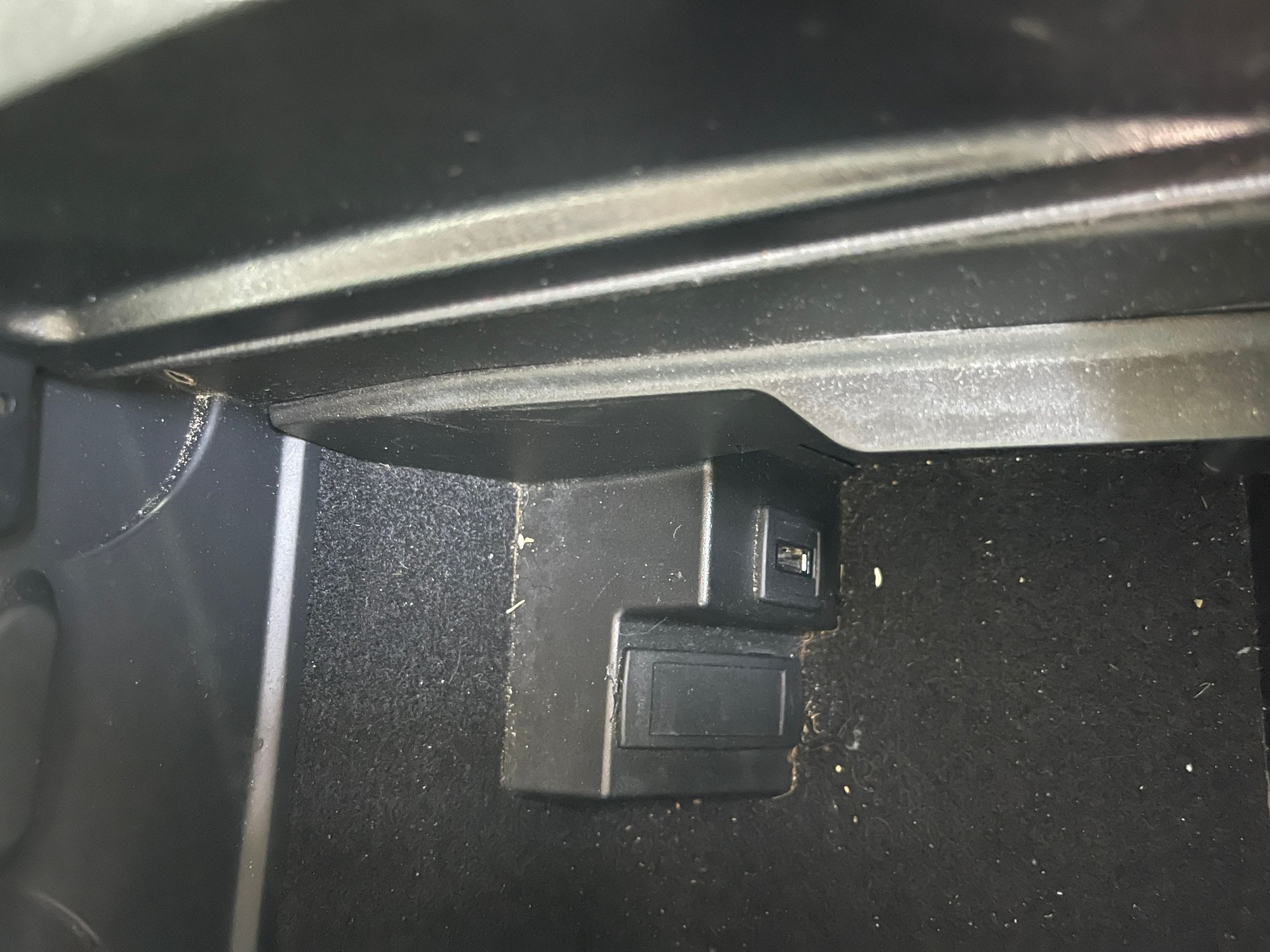

Strange. In my experience, the Navigation module is built in the back of the head unit. Would you be able to send a picture of said port? Any chance this is an aftermarket module?
Not an aftermarket unit. US models have the Becker Map Pilot (by Harman Becker) which is in the glove box. Cadman has the coupe and I have the the sedan version of the same car except, for some reason, he lacks the AUX and/or MMI connector.
That’s got to be buried all the way down in the original build options.

pics attached... dash glove box and console box. wasn't sure how to reduce the size.
