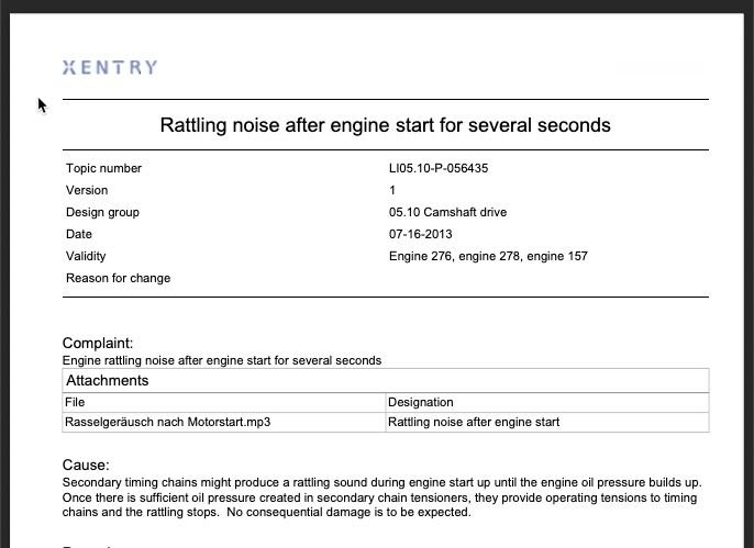

Could that be the infamous timing chain tensioner problem? See below.

Get the Service Bulletin here.
