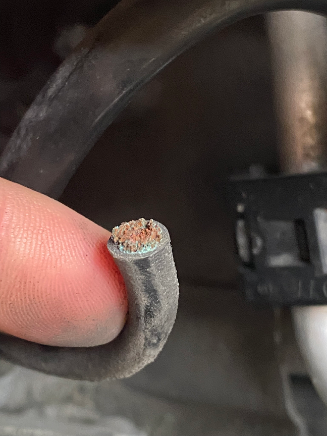

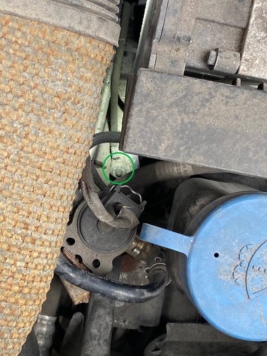

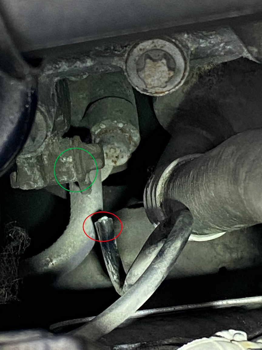

Yesterday i saw this grounding cable was broken:
Could this broken cable be causing those electrical issues?

yes

As an aside, pictures show what seems to be a lot of corrosion...live in area with winter salted roads or chance car was flood damaged ?
Indeed, I use this car only for winter driving and i live in Quebec. Lots of salty roads here

Is ground cable that broke connected to engine and frame...?...had a problem in old BMW where motor mount failure allow motor to rock the ground cable good enough to point of near complete break. The oxidation on your cable may be enough alone or with cable "wiggle". Just a thought.

One side is still connected to the frame, the side going to the engine has broken off completely at the terminal . I will repair it over the weekend and report back
