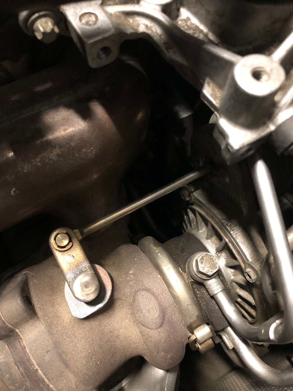

Does the waste gauge in the C250 turbo 2012 Open and close while idling if pressed on the gas pedal?

Nope....,volume of exhaust gas at idle, or at lower RPMs for that matter, not sufficient to produce corresponding compressor side volume/pressures high enough to open waste gate, assuming waste gate intact, not "flopping in the breeze".
