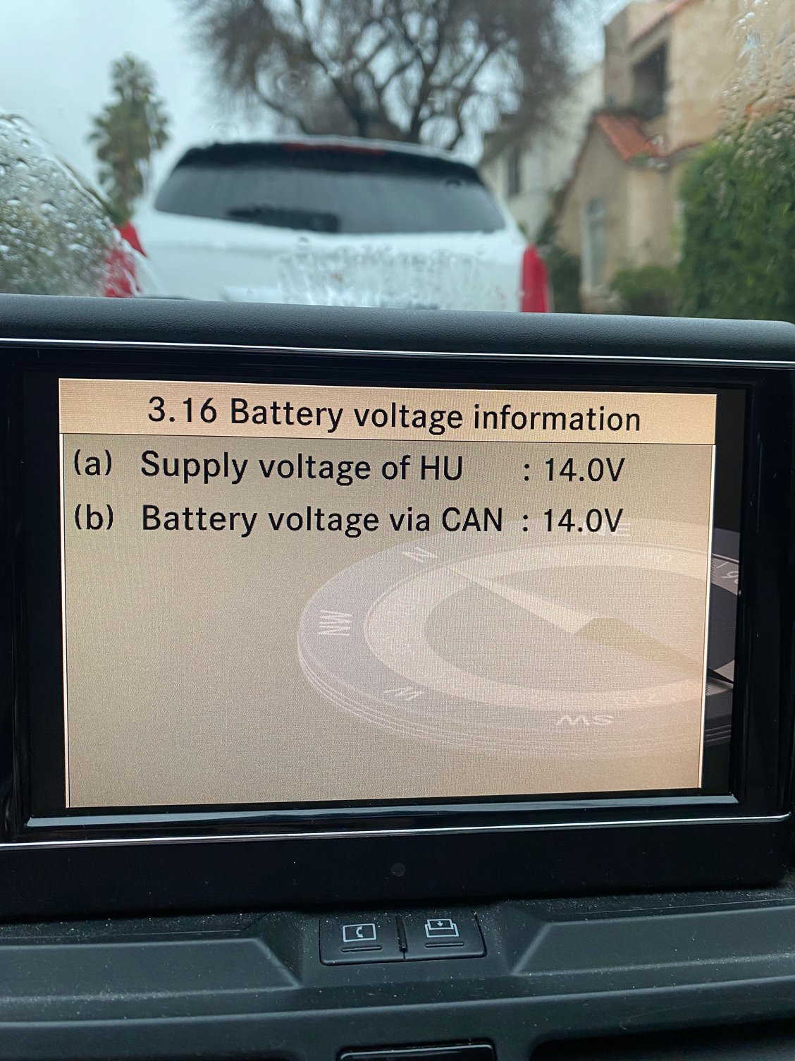

I don't have that unfortunately. I was able to access some info using the engineering menu
I still don't the battery warning on startup. Must be a ground or short issue..
Car off with radio on
Car running with radio on

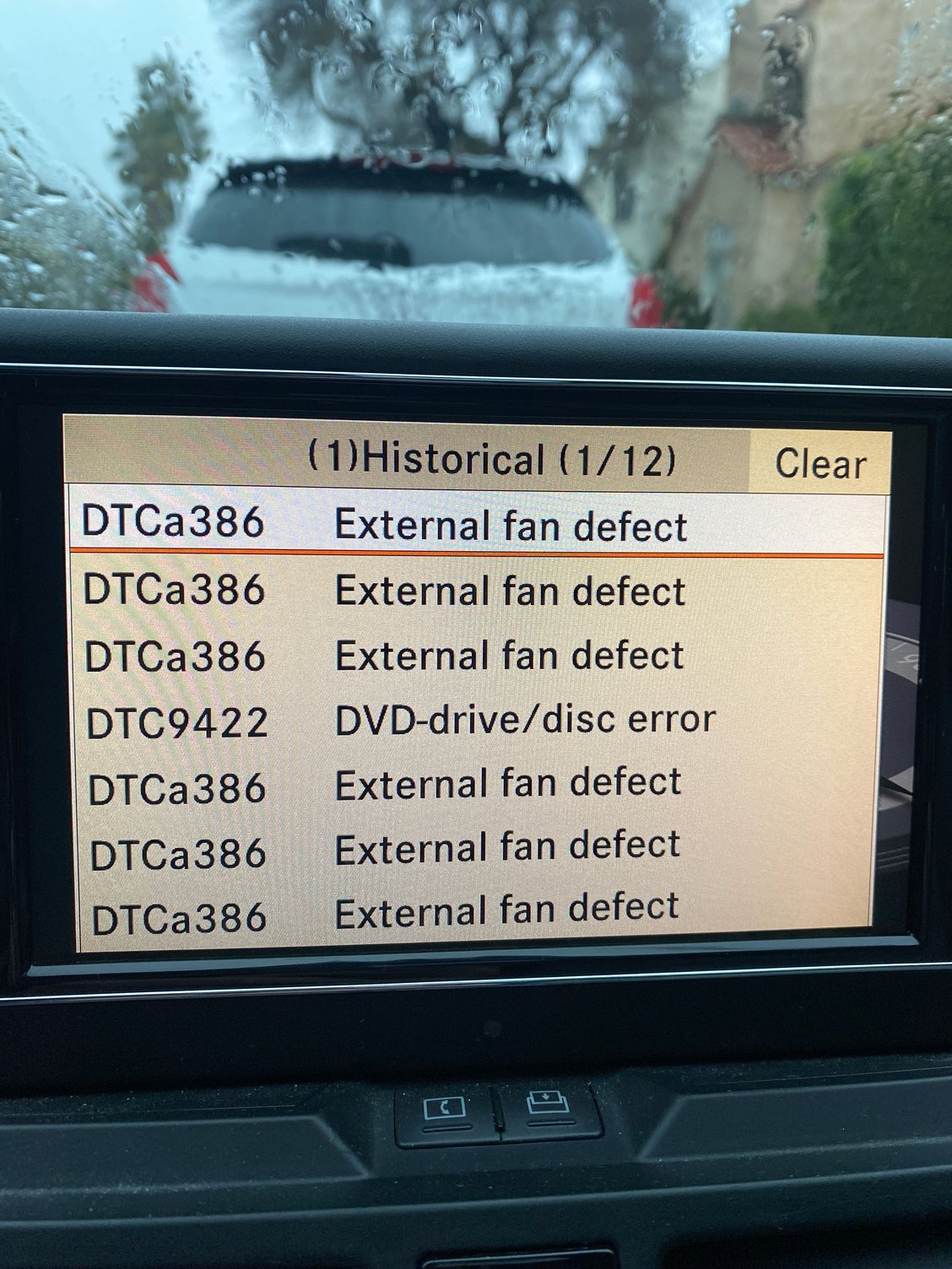

Other Errors
I also found these errors. Might be left over from old battery. I will clear them and see if they come back. Probably related to the command itself...
