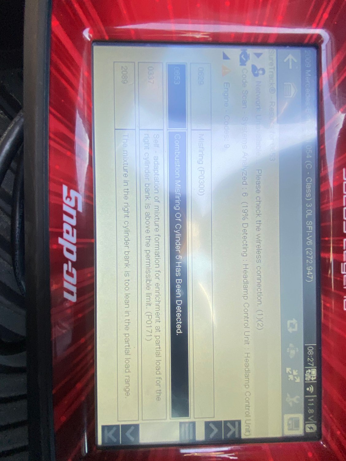

I’m getting the code p0171 on my 09 c300. I’ve recently changed the coil packs which somewhat helped because my car was misfiring terribly and I thought that would be the fix I needed but I’m still getting the same codes and from the scan tool I use it says cylinder 5 is misfiring which it shouldn’t be. I’ve changed the sparks plugs when I first got the car (10 months ago) so what could it be. I’ve read stuff suggesting it could be the fuel pump or fuel sensor. I forgot to state that the cylinders are running too lean. Can anyone give me any advice?

Quick search shows it may be mass air flow sensor, try cleaning it.
Also could try swapping #5 coil pack with another. See what happens.
