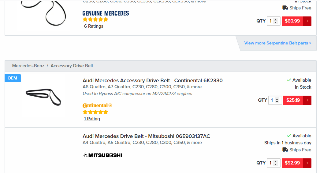

They seem to sell a belt to bypass the ac.

wanna know whats hilarious i bought that the first time it was too short pissed me off for about 3 hours then it broke. I’ll order another though and we’ll see 👏🏽

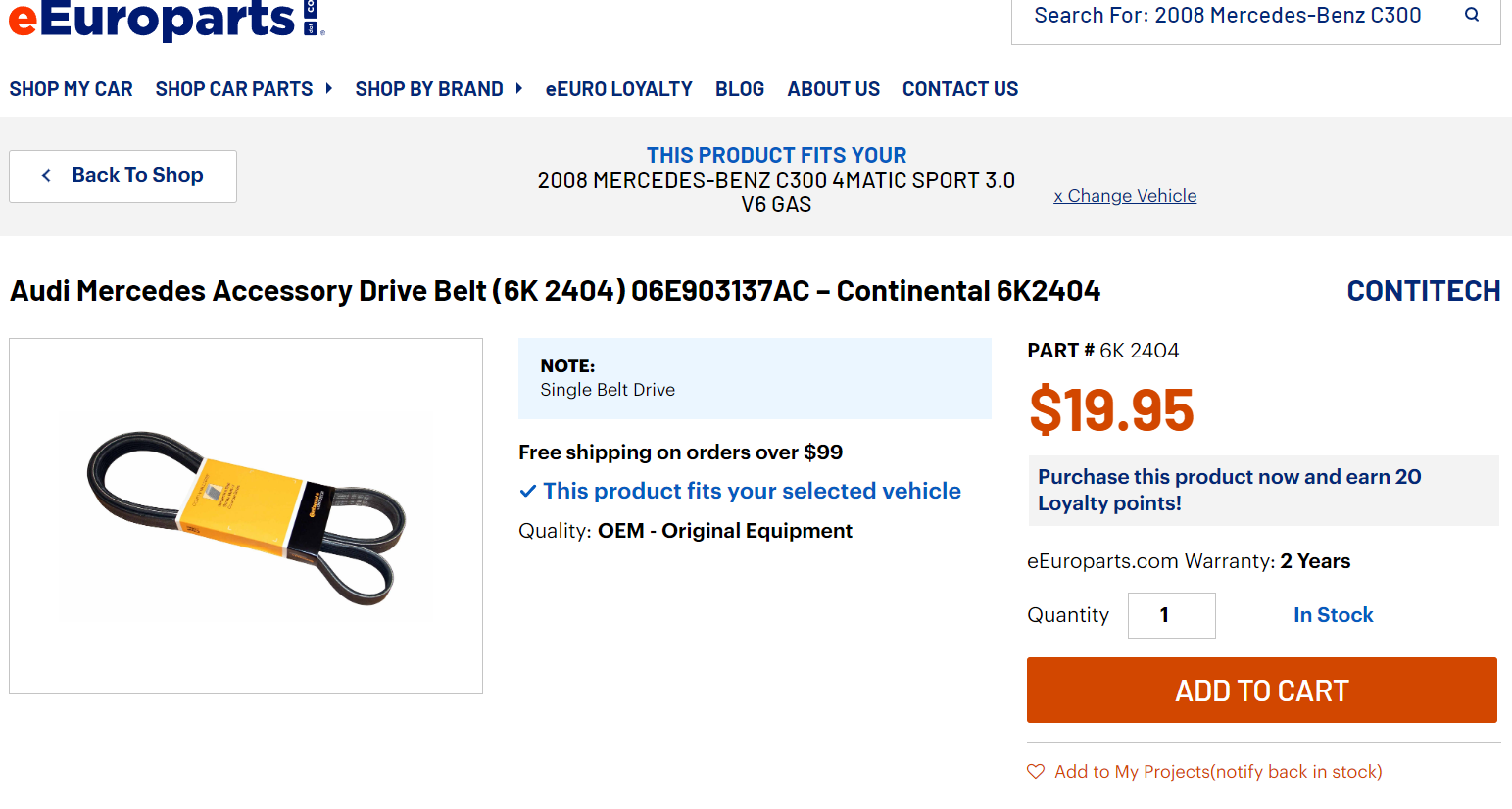

What size belt do you have on now? And when its installed is it showing within the marked lines on the tensioner? I have a 2404 belt. I remember someone recently had something like a 2390 and it was giving him issues.

I looked up that belt and looks like its a 2401mm belt. Tensioner markings:

Where is it lining up? Past the thicker line on the left = belt is short, towards thinner line on the right = belt is long/stretched.
I looked up 2008 Sport and came up with the same belt I got for mine. 2404mm. It is odd since the belt you say you have the master pro K060945 says it is 2401mm, which according to my operators manual is the size it recommends.
I looked up for the 4matic Sport, Sport gas and Sport Flex just to be sure.
Is there a printed label on your belt to make sure its what you ordered?
