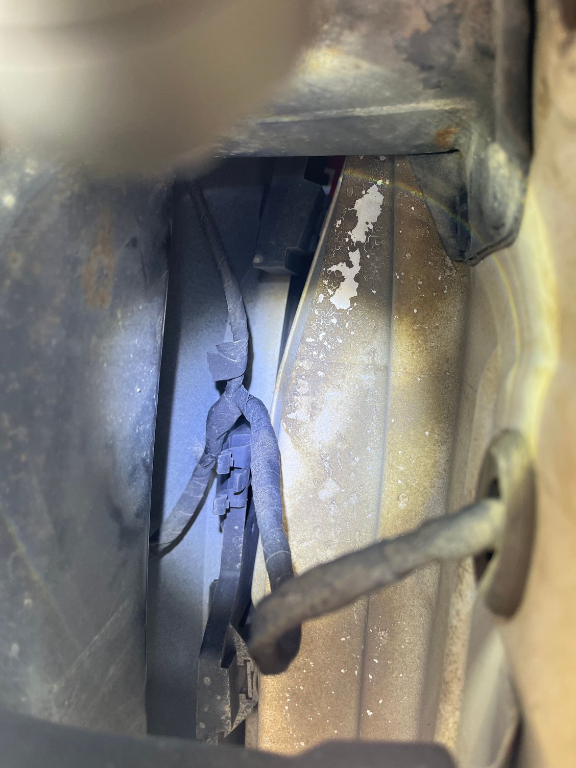

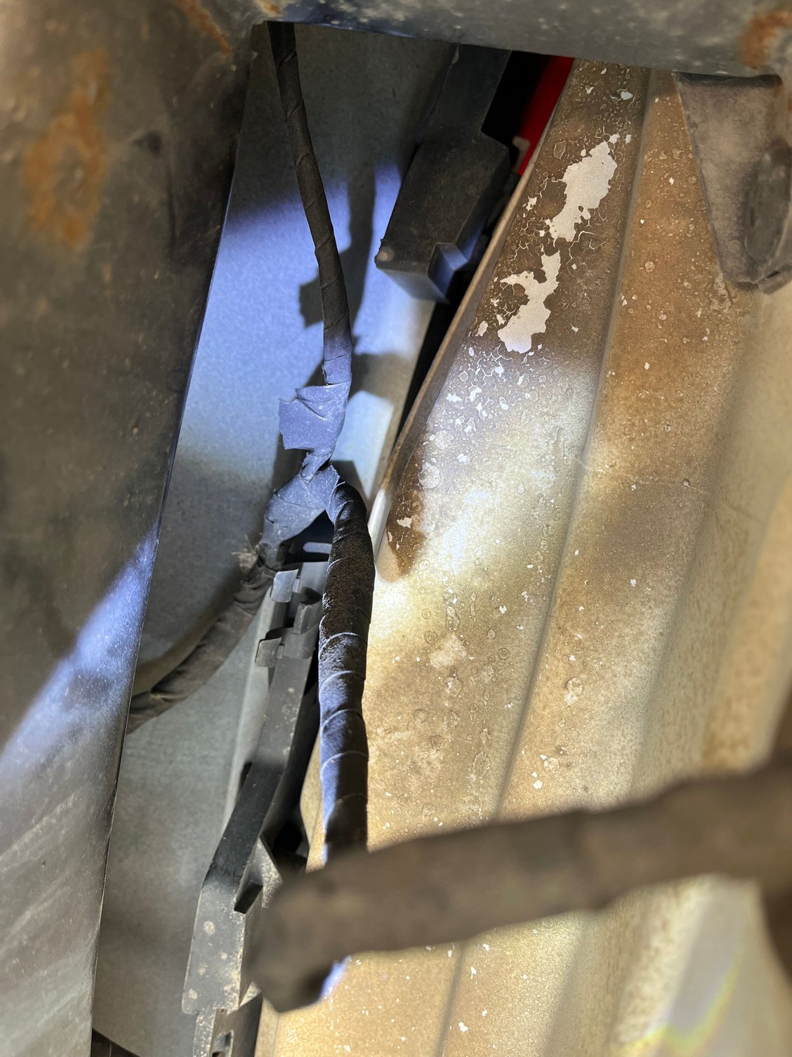

This may be a repeat as I couldn’t find first post. Blind spot warning inoperable. Read all I can, but can’t locate the module that is supposed to be under the passenger side of the vehicle. Attached is a picture of the underside.. Am I blind?

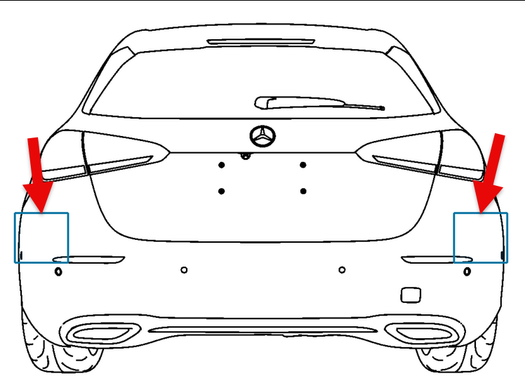

TimC300's Avatar
Joined: Aug 2023
Posts: 3,742
Likes: 1,137
From: MA Coast
Should be on the bumper rear passenger. Part# 430 in the diagram.

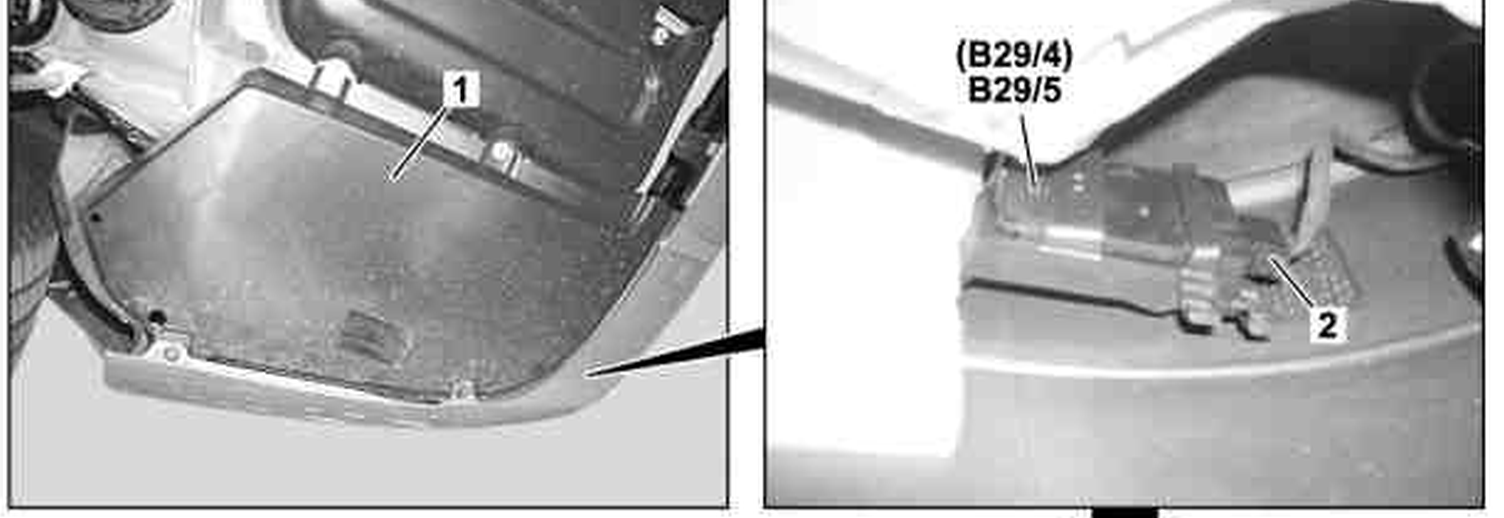

JettaRed's Avatar
Veteran: Army
iTrader: (1)
Joined: Nov 2016
Posts: 7,847
Likes: 3,498
From: Maryland
There is a cover underneath the rear fender between the wheel and bumper that needs to be removed. It looks like the bumper cover can stay on. The instruction document is AR54.71-P-0100CW.

Old Oct 13, 2023 | 06:05 PM
TimC300's Avatar
Joined: Aug 2023
Posts: 3,742
Likes: 1,137
From: MA Coast
Mine doesnt have that feature so I cant say for sure. But from seeing photos of other Mercedes im guessing it should be right in the corner, look up and should be behind the metal heat shielding for the muffler. Just follow the wiring from the sensors in the bumper, should lead right to that module.
