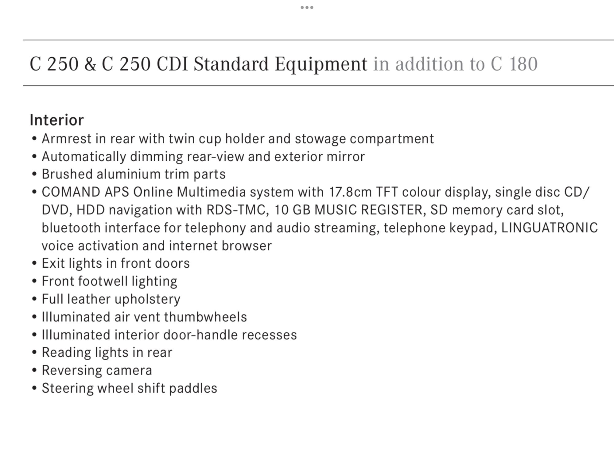

Here in Australia, that’s standard equipment for the C250 over the C180…
