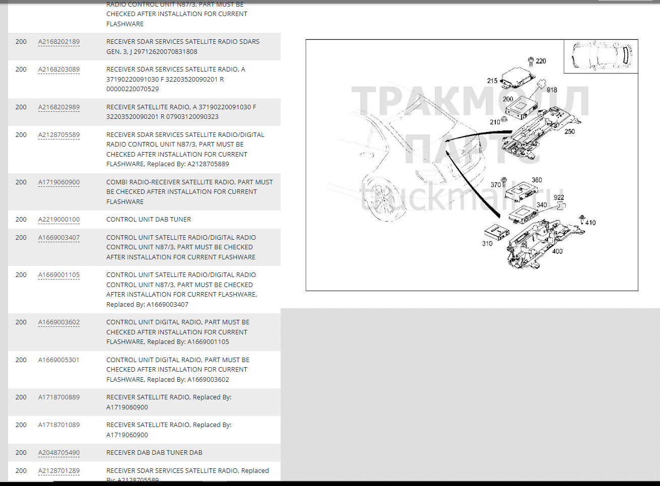

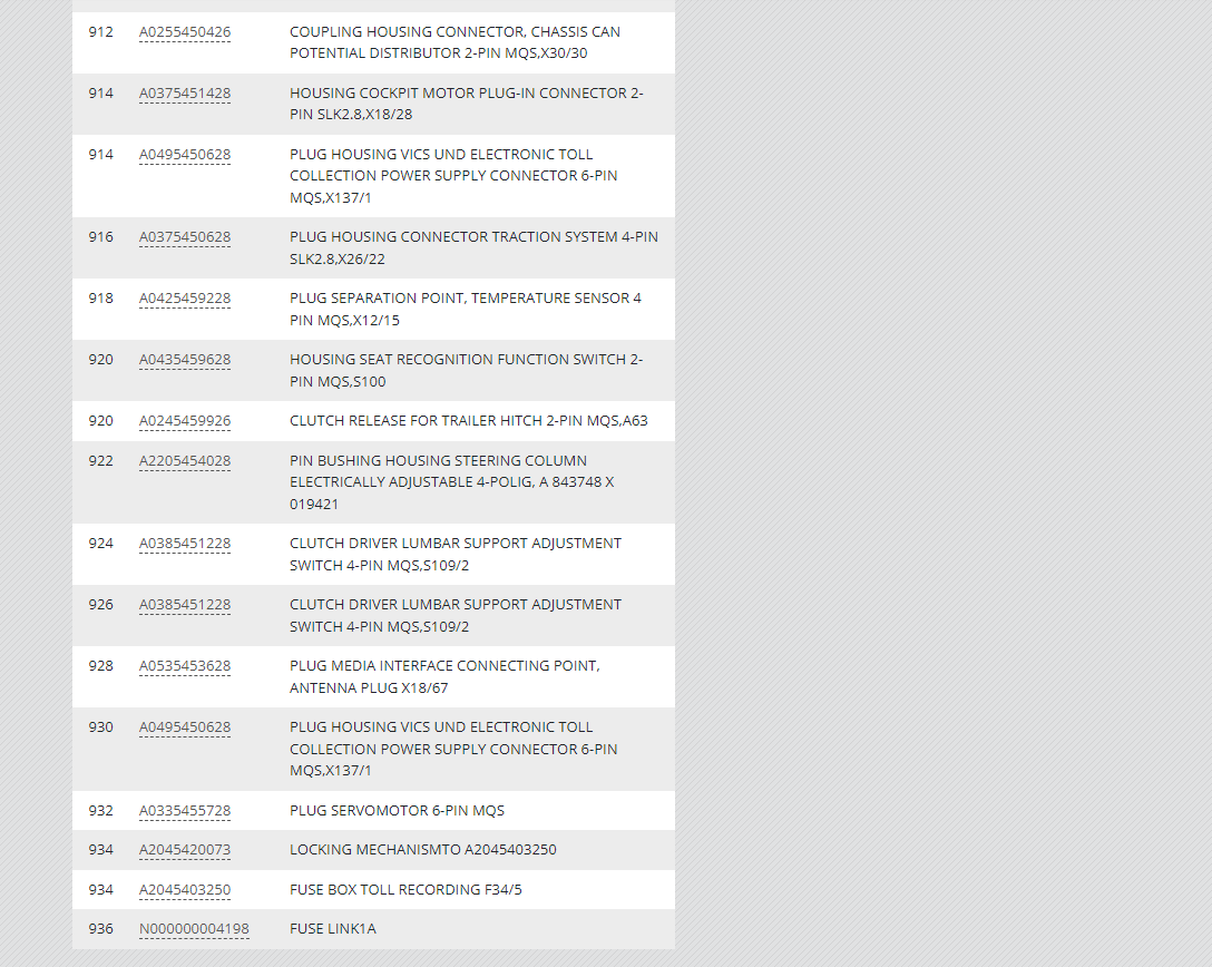

Wonder if it may be a connection issue in the wiring harness somewhere. From diagrams it looks like the radio wiring harness goes from the front down the passenger side to the back of the car. Maybe the harness is in the door sill? Opening/closing the door messes with the connection.
Are the radio station pre-sets still saved? Not sure if you mean the pre-sets arent showing, or if it just takes awhile for the radio station to come in? Maybe an issue with the antenna connection.
