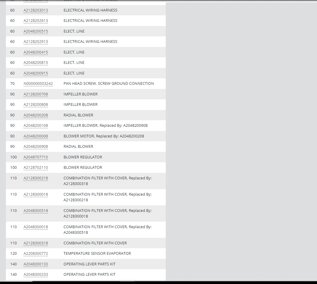

Heres a parts diagram for my 2010, if you post your vin I can get the ones specific to yours.
Part# 100 I believe.

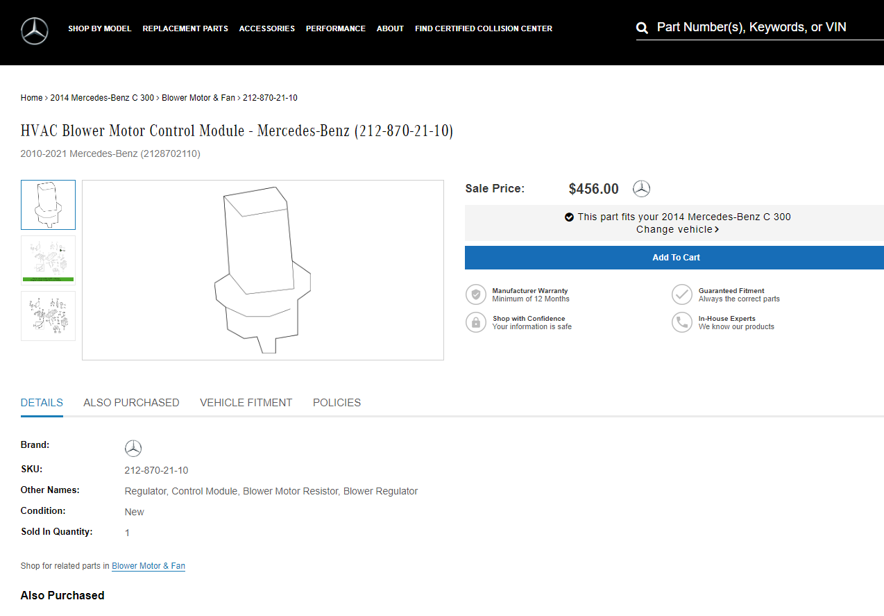

Looking up 2014 C300 4matic sport I come up with this:
The price is insane. I think I paid $20 for my Jeep resistor.
There must be a way to test the resistor, either using a scanner or even a multimeter.
