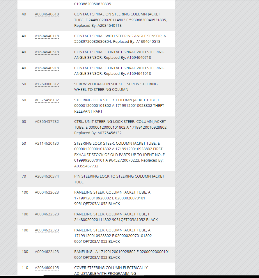

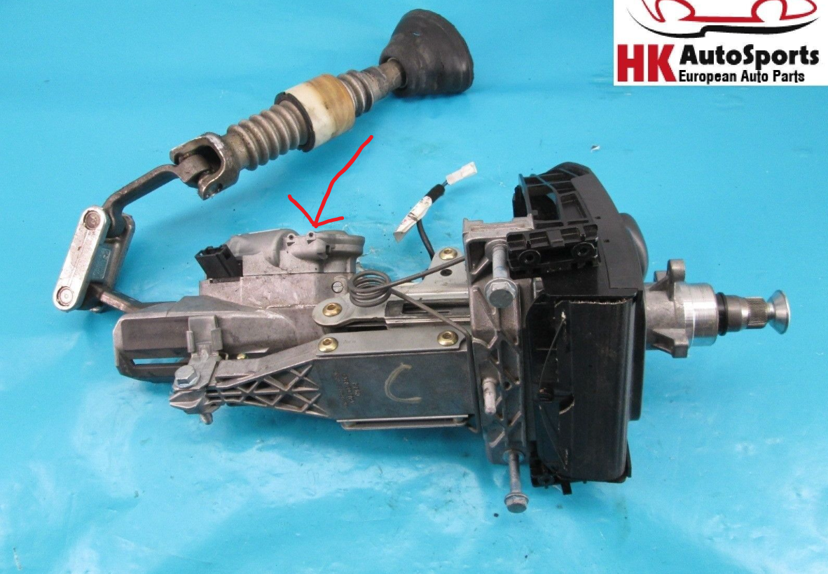

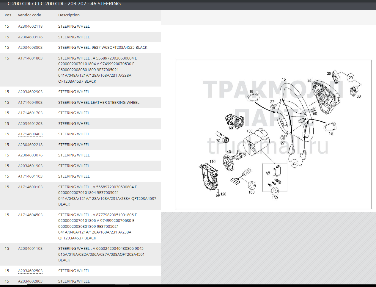

Not sure your submodel so I looked up general W203 steering diagrams and seems the steering lock in mounted on the column shown in the photo below.
Part # 60 in this diagram.
