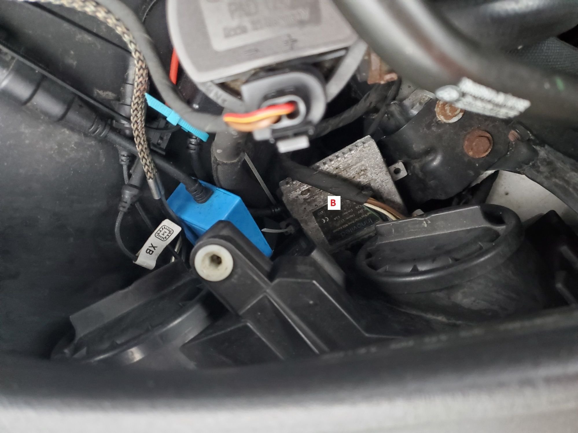

I just fit the ballasts where they fit with the limited room behind the headlights. Passenger side I zip tied it down on a bracket, driver I zip tied it to the ac line. I just did it quick when first installing and was going to clean it up but never bothered and has been like this for years now. I'm actually surprised the ballasts have lasted this long.
Driver side:

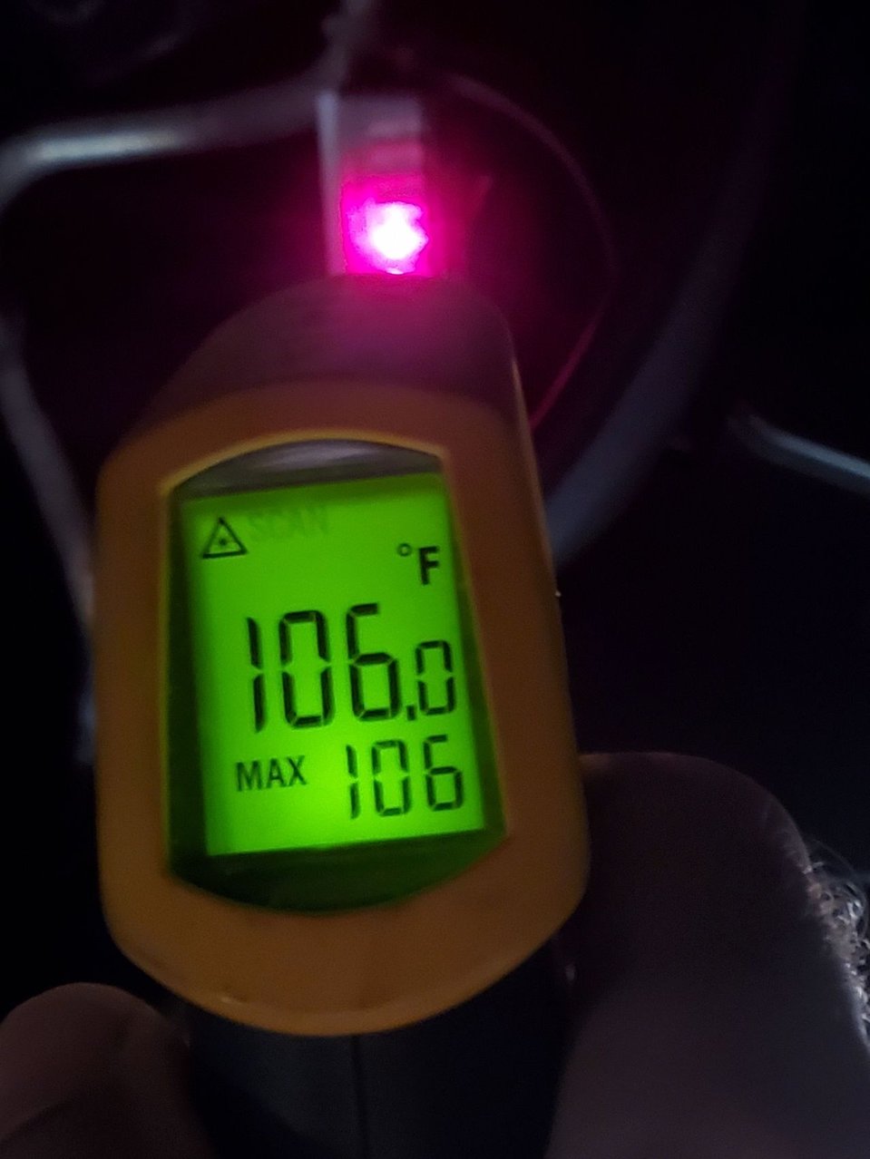

I finally remembered to see how hot the ballasts do get. Drove about an hour and got home and left the car running lights on while I took some temp measurements. Measured both ballasts and the blue boxes in the kit. And its the middle of summer and hot out.
Highest I got was 106 F. For comparison my computer monitor thats been on all day shows 98 F.
I dont remember any of my previous vehicles hid ballasts getting that hot and those were cheaper kinds. I do remember having metal resistors I installed for switchback led turn signals and those things got raging hot, def burn fingers if touched.
