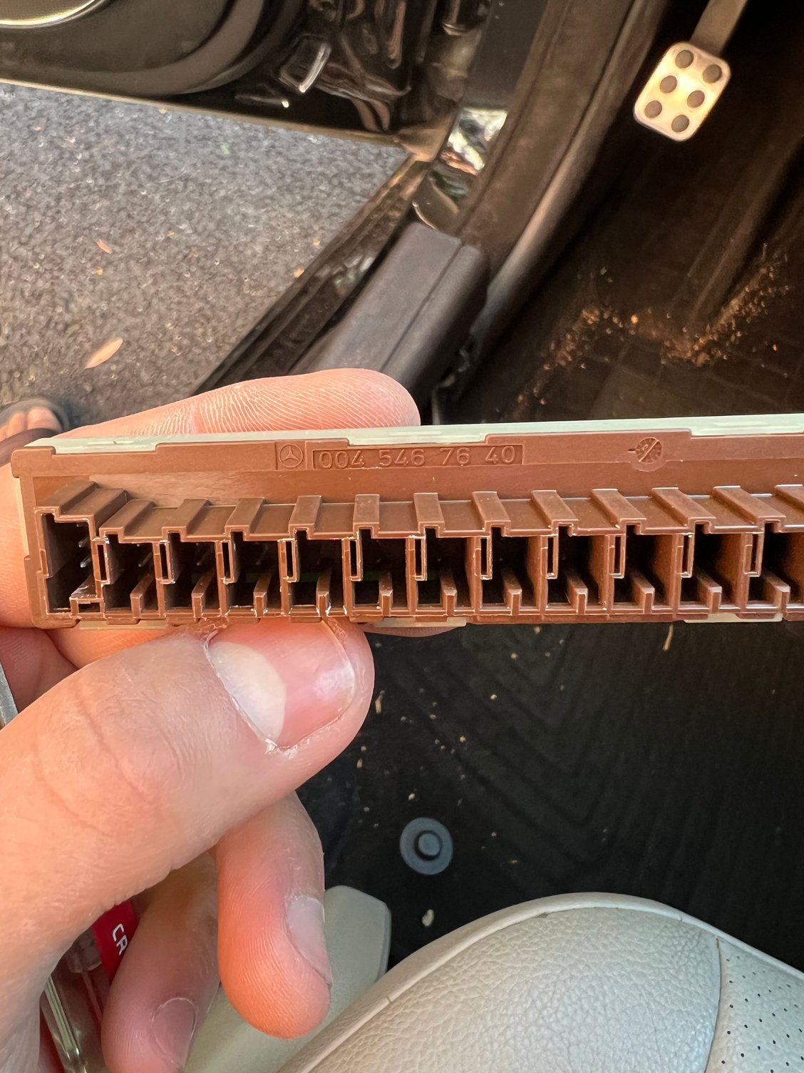

So i bought the car about a year and a half ago and didnt touch it for some time. Recently ive been doing work on it and found a lot of unknown issues from when i bought it ill give you the list of them. Windscreen is cracked, rims are not the correct lug pattern, pools of water in the floor pan prodominatly the driver side. Car was throwing muiltpule engine codes. the current issue im dealing with is that when ever i shut the car off the dash says my high beams all exterior lights are on if i go to start the car again the dash then illuminates the parking brake and high beams(head lights flicker aswell). ive replaced the two can bus distributors on the driver footwell aswell as thourghly cleaned each connecter on the driver and passanger side. Car still doing the same thing from before replacing and cleaning. Any sugestions or thoughts car need to be inspecting in 5 days

For the light staying on, this was a bad light switch for me which is common for the 204 and related chassis that use the same switch. There's also the issue of water ingress, which brings it's own shorting issues, which need to be corrected first and foremost. Then you'll need new (correct) wheels, replace the windshield, then on to the engine trouble codes. You probably won't make that 5 day deadline if we're being honest, so might as well take your time and do it right.

check engine light is on ive already replaced the components its throwing codes for code persist. i also got rid of all the water in the floor pan and blew out all connecters and front sam problems still persist loss of headlamp use high beam indicator on parking brake intermittent no crank no start

Have you seen videos on YouTube of replacing the canbus connectors in the floor pans? Looks like folks who had pooling water had corrosion on the connectors located in the footwell and replacing them helped with the dashboard lighting up like a Xmas tree.
