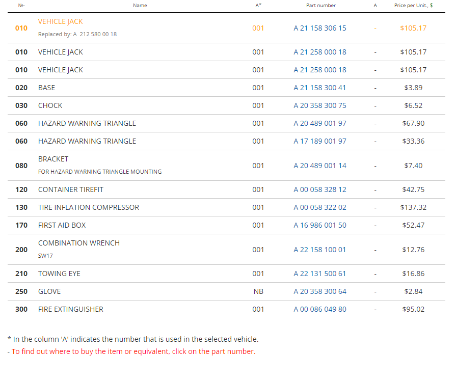

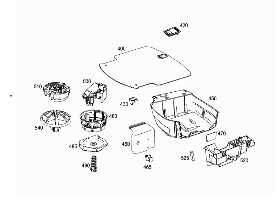

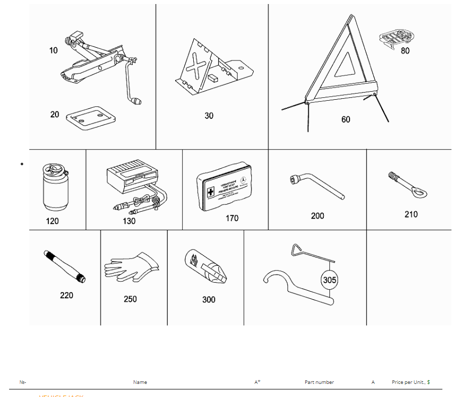

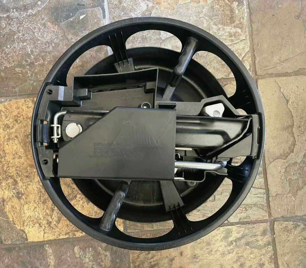

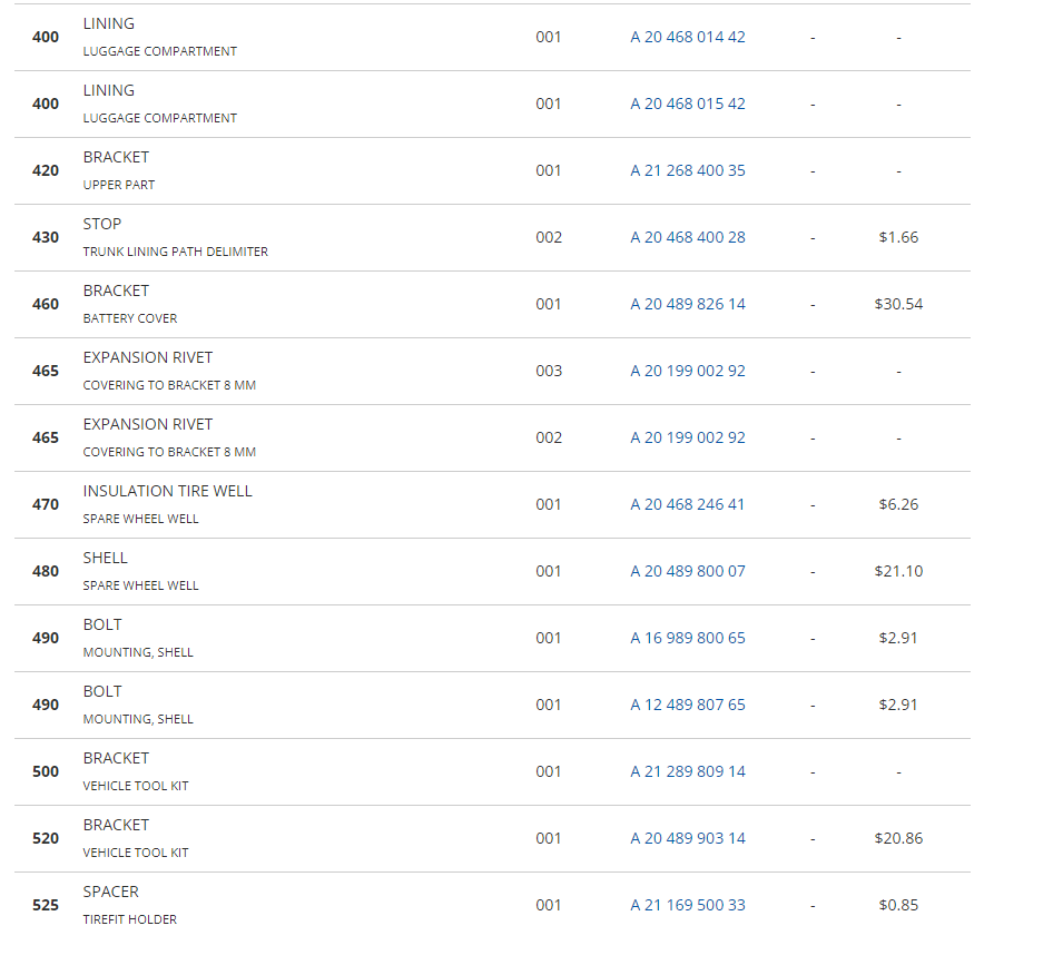

Would It be possible that a member could supply a picture of what’s in the trunk for the spare tire change, actually bought this vehicle recently and forgot to check. All I have is a jack and spare tire, no tools, wheel chocks or the ties down support. Or if someone has a part number list. Need to send a list to the dealer. Thanks

My W204 has the jack, wheel choke, tire iron, tow hook and Medical kit. I looked at kits on ebay and seems what they come with.

Heres the diagram showing the kit. #500 is no longer available but can look up what it has in it.
