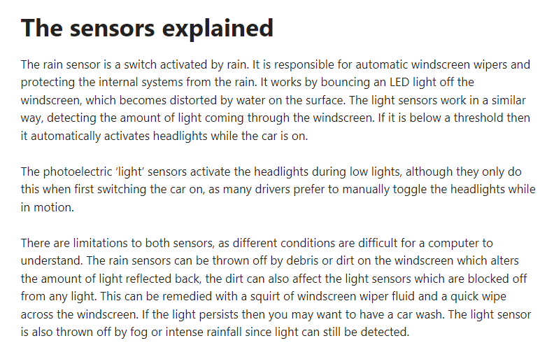

How do i check to make sure the sensor works? Can I spray some water to see whether the windshield wiper comes on?

Im not 100% sure but I believe the sensor is responsible for turning the headlights on when they are on the Auto setting. I leave my headlight switch on Auto and the headlights and tailights automatically come on when its getting dark or driving thru a tunnel.
Its also the rain sensor if your car has rain sensing wipers. I dont think my car has it, ive never seen the wipers automatically come on. It works by basically light reflecting back t the sensor when there is water on the windshield.
