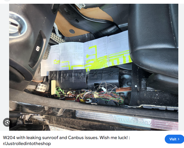

Did you find your floor board full of water anytime in the last few years? I got the same warning lights a few years after my driver side floor board was flooded after a bad storm (and due to dirty and clogged drain holes by the windshield) and turned out to be the canbus connectors being corroded. I swapped em out and am A-okay since!
But yes, like the previous poster suggested, any other warning lights? Error Codes? Messages ?
my dash would warn saying traction control disabled, speed sensor error, accelerator position sensor error, etc.

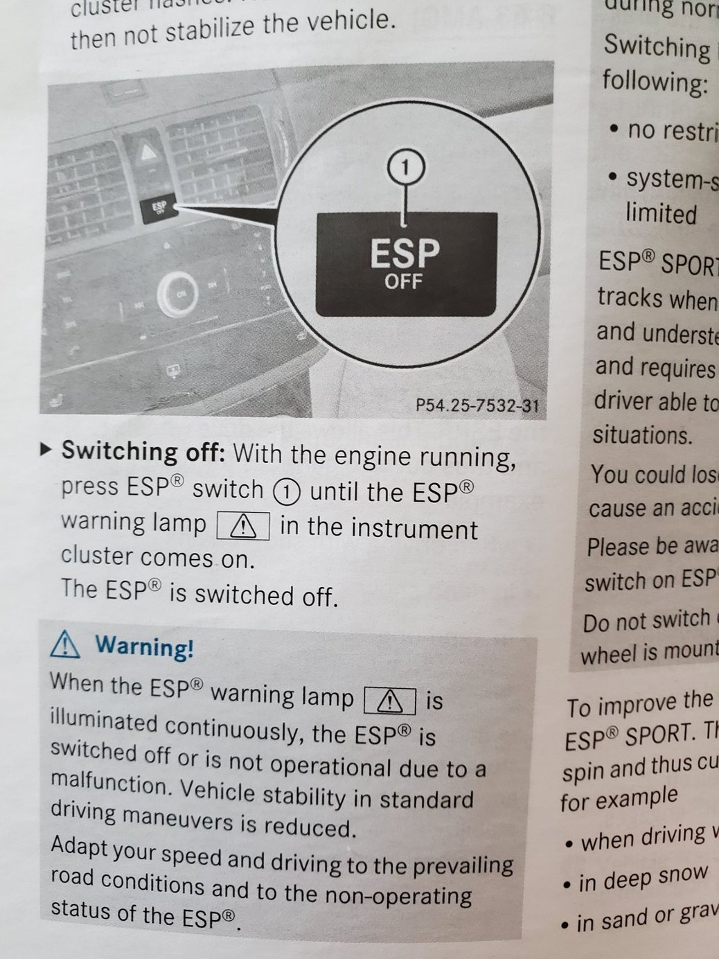

ESP button may be on your dash in the middle.
There is some information on what all the different warnings mean in your Operators Manual in the glove box. Just look up "ESP" in the front to see what pages its covered on. I was looking in mine in the Vehicle Status Messages In The Multifunction Display section. Mostly says to contact Mercedes but sometimes it may tell you what to check.

Heres an example of someone with water on the drivers side:

To turn the ESP off on some W204 models there is no switch, it's done through the selectable Menu in the Speedometer MFD (Multi Function Display).

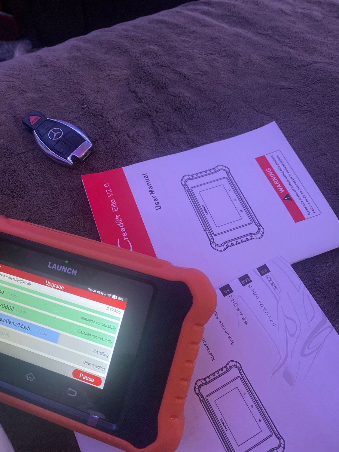

I bought the launch Creader elite V2.0 , going to test it out when there’s more light outside . I do not have that ESP button . I’m pretty sure it’s in my display where my speedometer is .

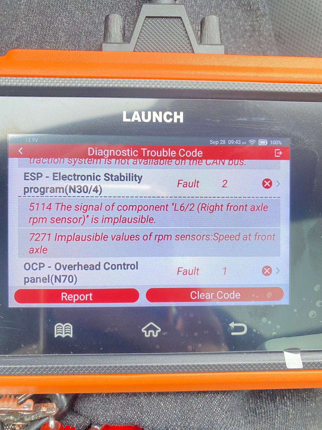

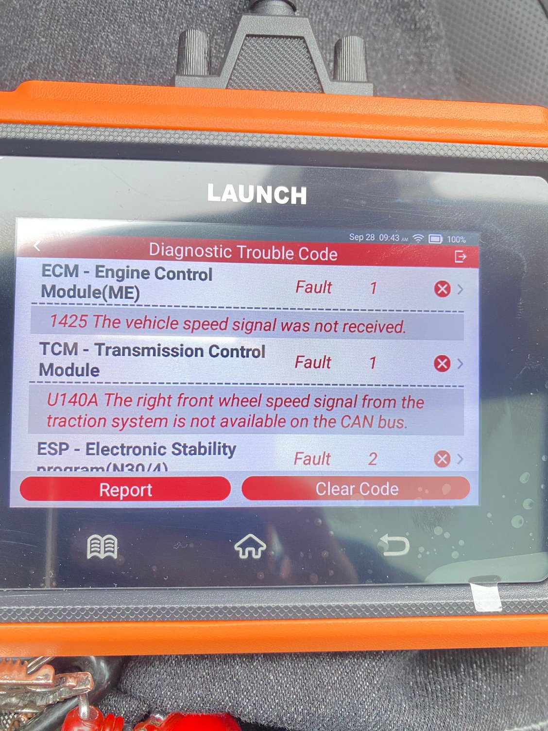

So I tried this scanner and it’s amazing I love it . I reset my codes and they went away . I drove it for 2 mins and then the lights came back on . Came back to my house and scanned it again . Only for these codes to pop up. I believe I know what to do , but for reassurance let me know?

Appears there is a fault at the front right (passenger) wheel speed sensor.
Do you have the old wheel speed sensors that you replaced on the left drivers side? May be worth trying to put that one in the right side and see if it solves the issue. Thats assuming nothing was wrong with the drivers side in the beginning.
In general I always save the old parts.

I fixed the problem !! All it needed was an official Mercedes sensor . Clear the codes with the amazinggg computer and boom problem solved . The computer is amazing , definitely recommend . My car is ready for inspection and should be able to pass once I get my tint removed lol. Thank you for helping me through out everything , I really appreciate it . This is my first car so it means alot
