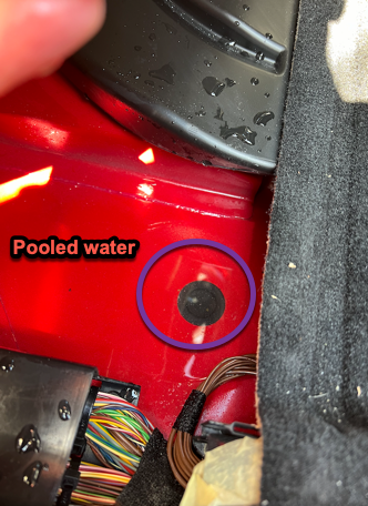

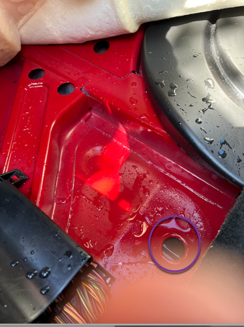

Hi , just had to replace the can bus under the floor for the second time . The first time no water was found in floor boards , second time a little water was present under driver and passengers sides .
so my question or hope is that someone here can help me with a list of potential leak points ?
i know the sunroof drains are a big one , I’m going to clean them out this weekend with compressed air , where should they drain from once clean ?
i changed the wiper cowl because it was rotten around the wiper arm (luckily no Sam damage)
any other locations ? Any tips ?

The sunroof drains drain behind the front wheel well liners. You may want to remove the plugs in the floorboards so water doesn't collect. The plastic trays under the car will keep water from splashing in.
