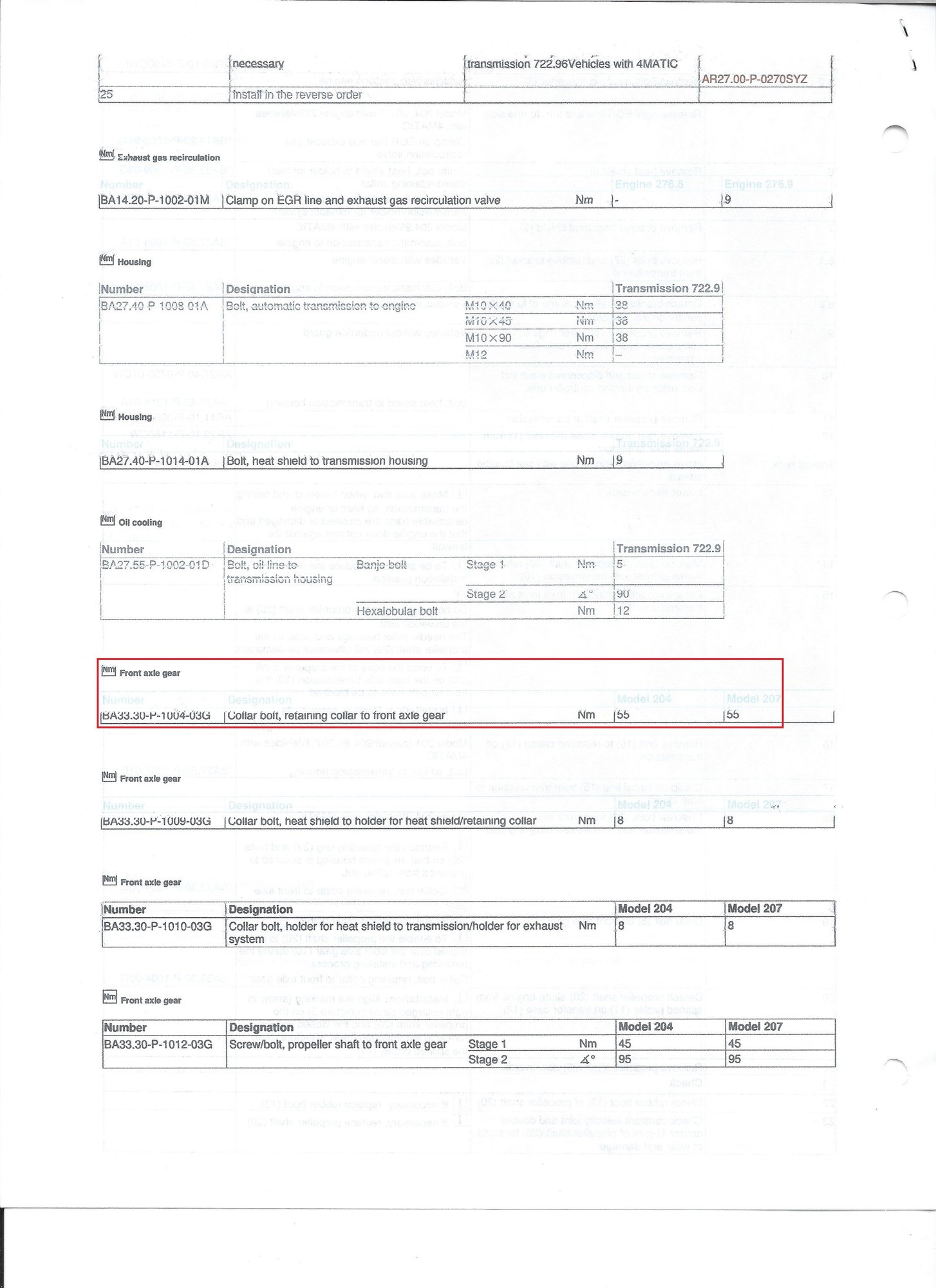

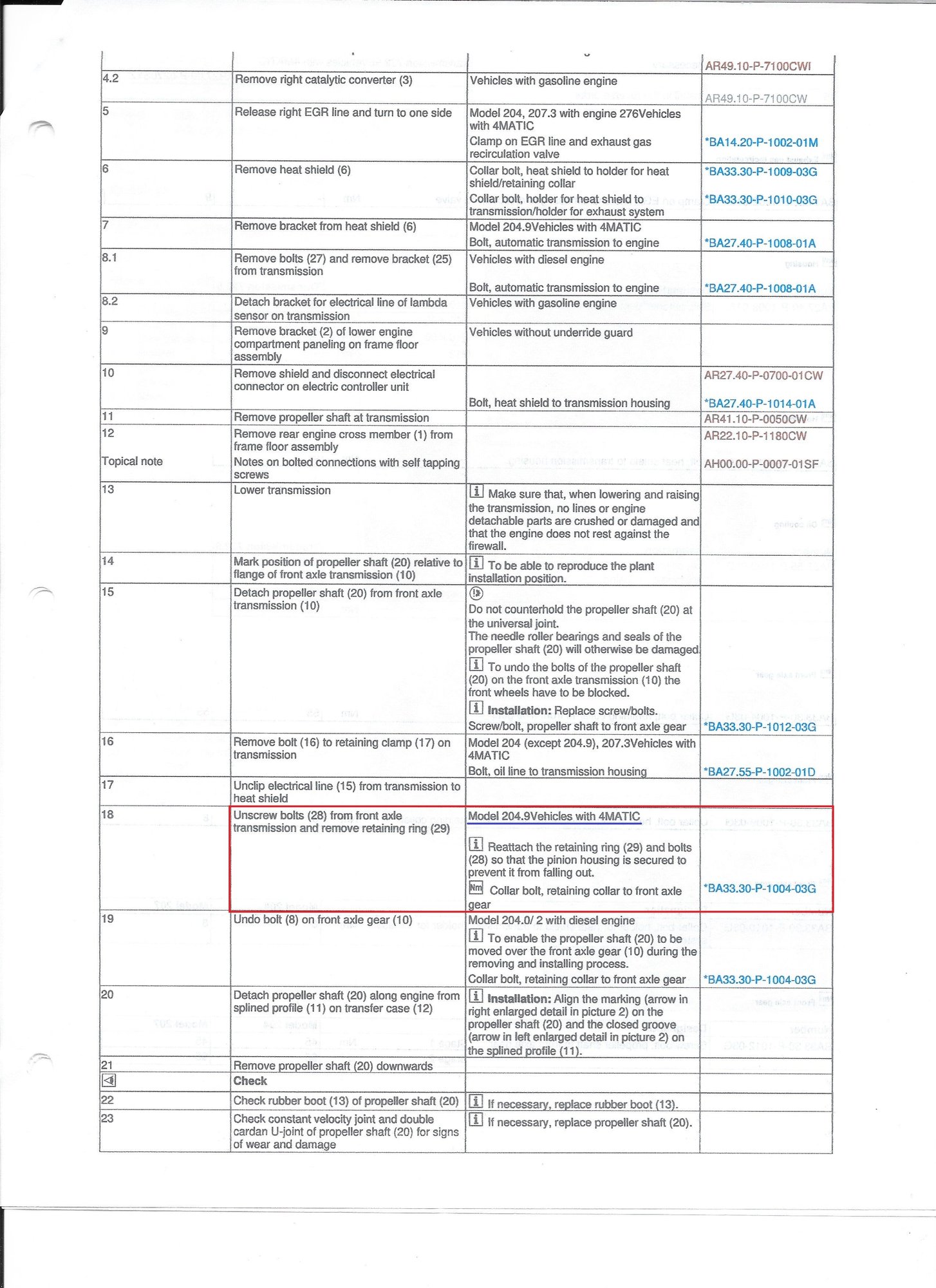

Heres what it shows for a W212. I dont see why it wouldnt be similar. Same transmission.
Says 55nm.

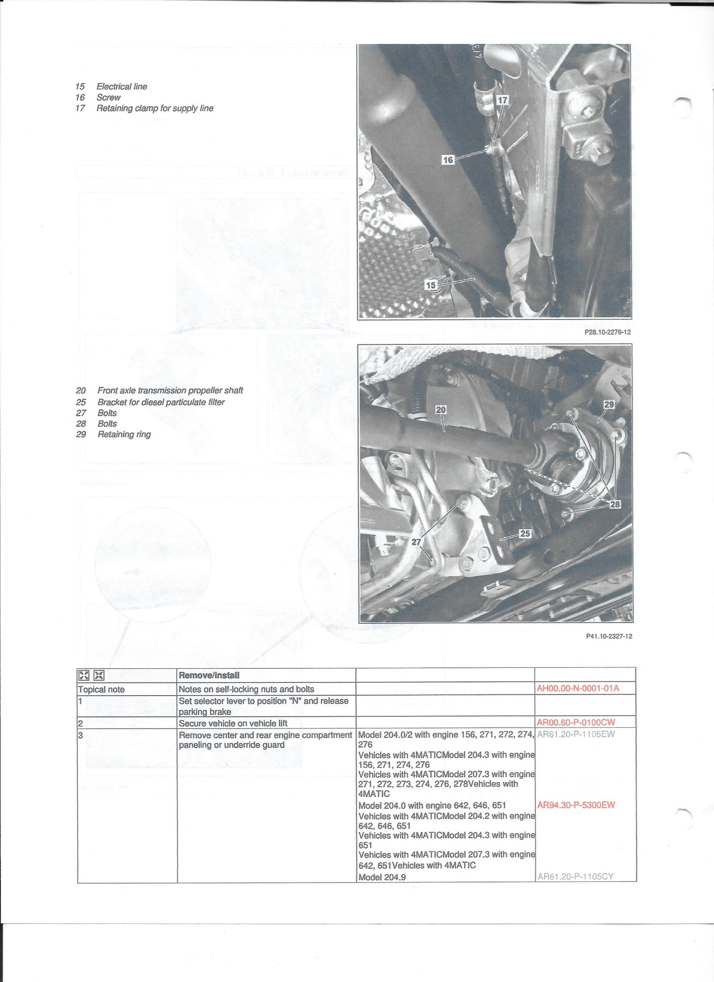

I will have to try and do this job again but thankfully it doesnt appear as if I have to drop the transmission to get to the differential now

I was just digging thru some papers and found the one for the W204. It is the same 55nm torque spec.
I have a habit of printing out every W204 WIS I come across and put it in a binder. But my printer isnt the best so its blurry half the time.
