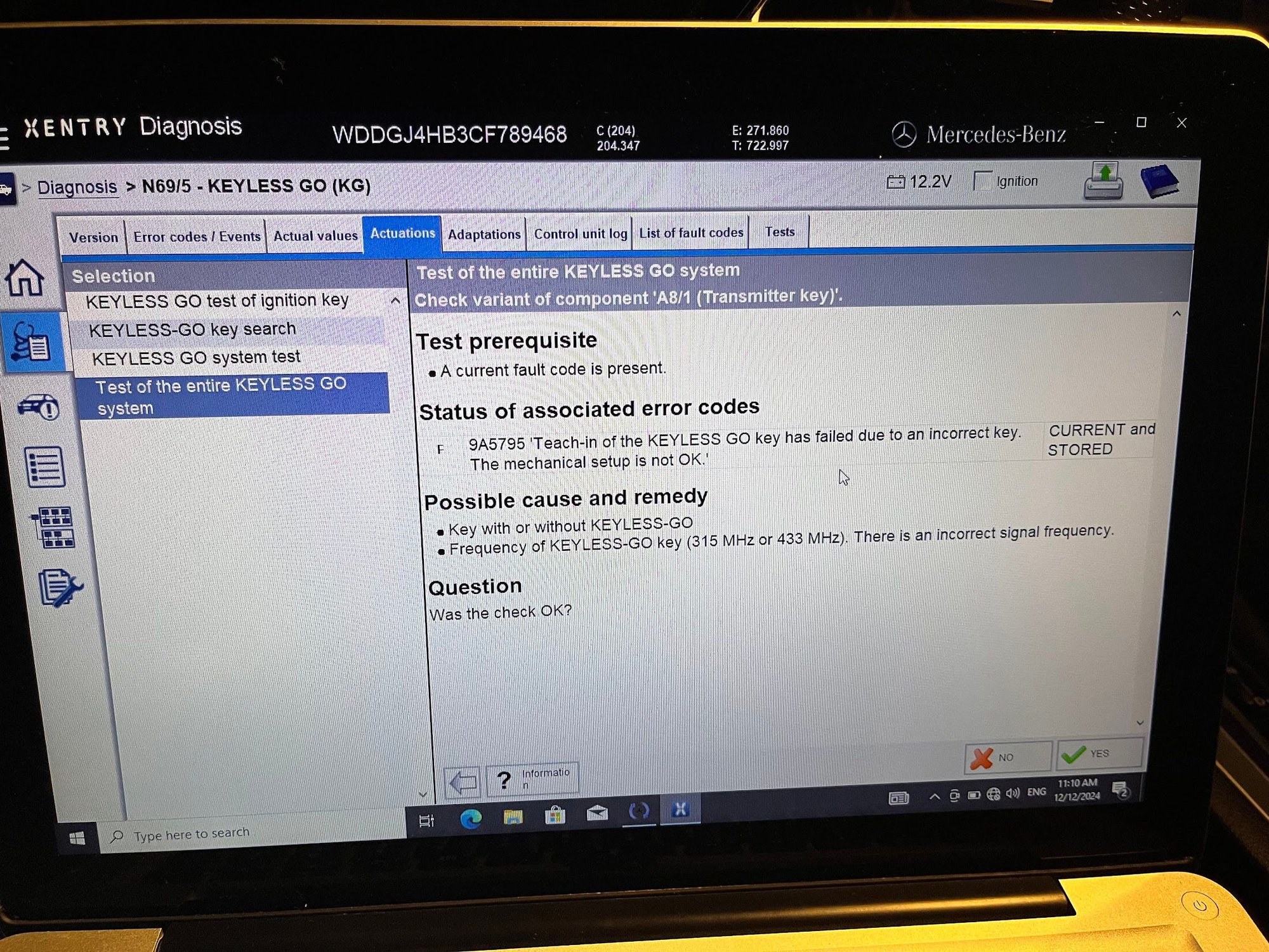

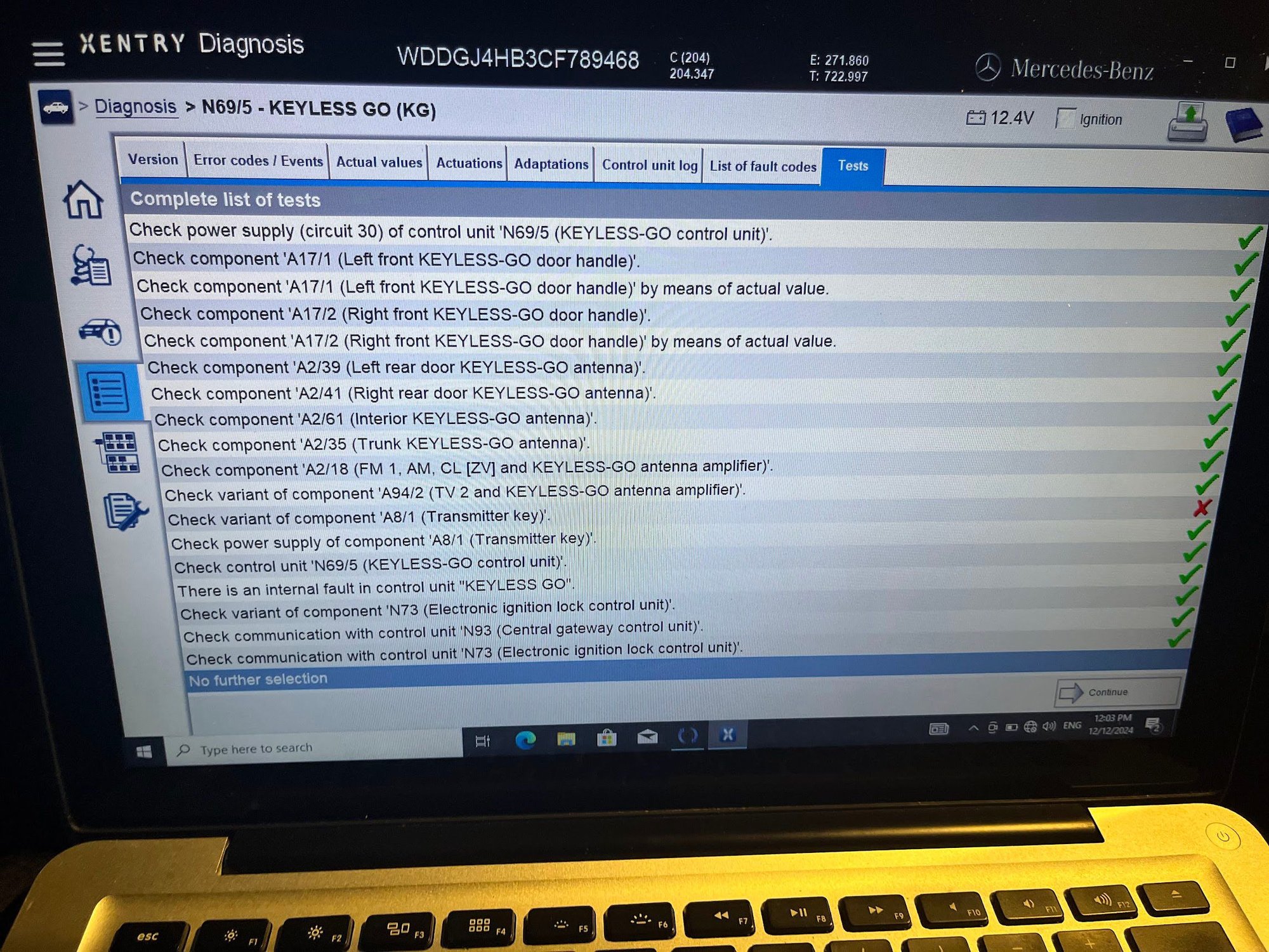

upd.
I found solution by myself. I installed xentry and did a diagnosis by myself.
By some reasone the key works all the way, but car can't find it when running. And the EIS can't recognize the key via keyless go protocol.
I think I should change the ELV and EIS to make it works. Will make an update to the topic later.
Problem is weird and workshops can't figure it out. Only deep diagnosis by myself lead me to the reasons.
