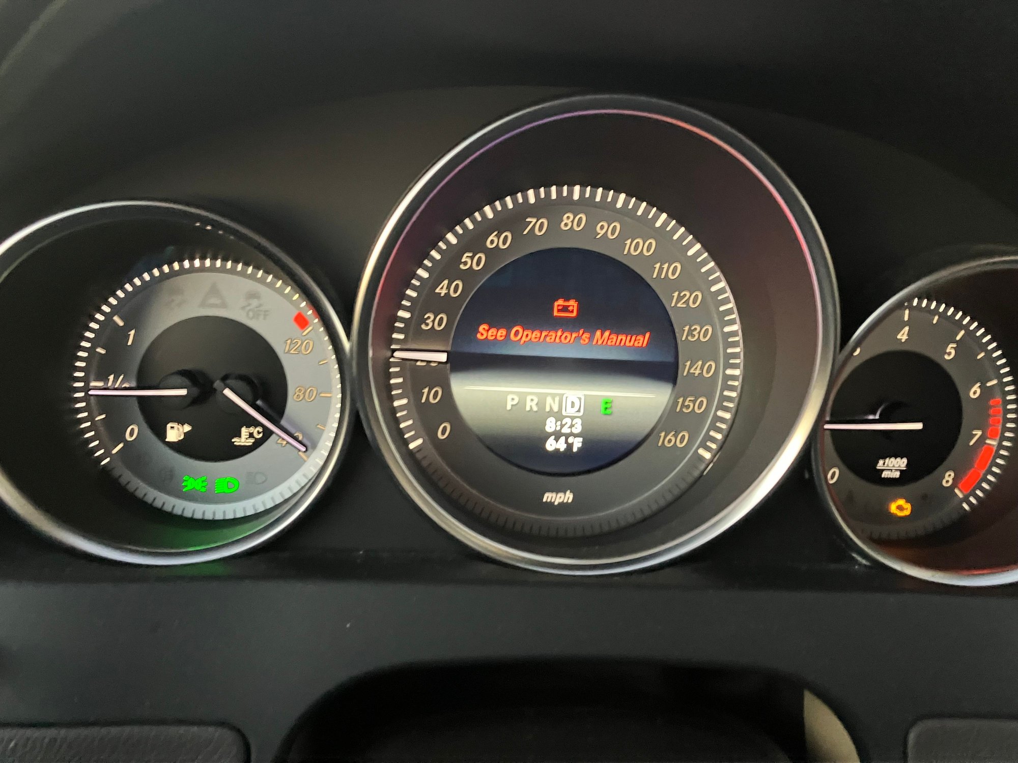

The interior lights, radio, speedometer dash do not work. I charged the battery all night and still have the same issue.

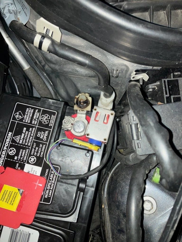

attached is a picture of a component that got hot.

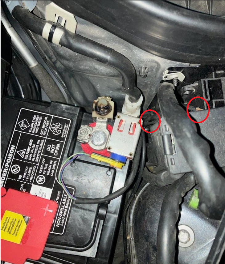

Who installed the battery? From the burn marks id be worried the positive cable may be worn/damaged. Cant really tell from the photo but how is the condition of the wire I circled?
I would check the fuses in the engine bay for anything blown. Heres a link to the fuse diagrams: https://fuse-box.info/mercedes-benz/...uses-and-relay

New battery was installed about 3-4 months ago, the burned part is recent.
