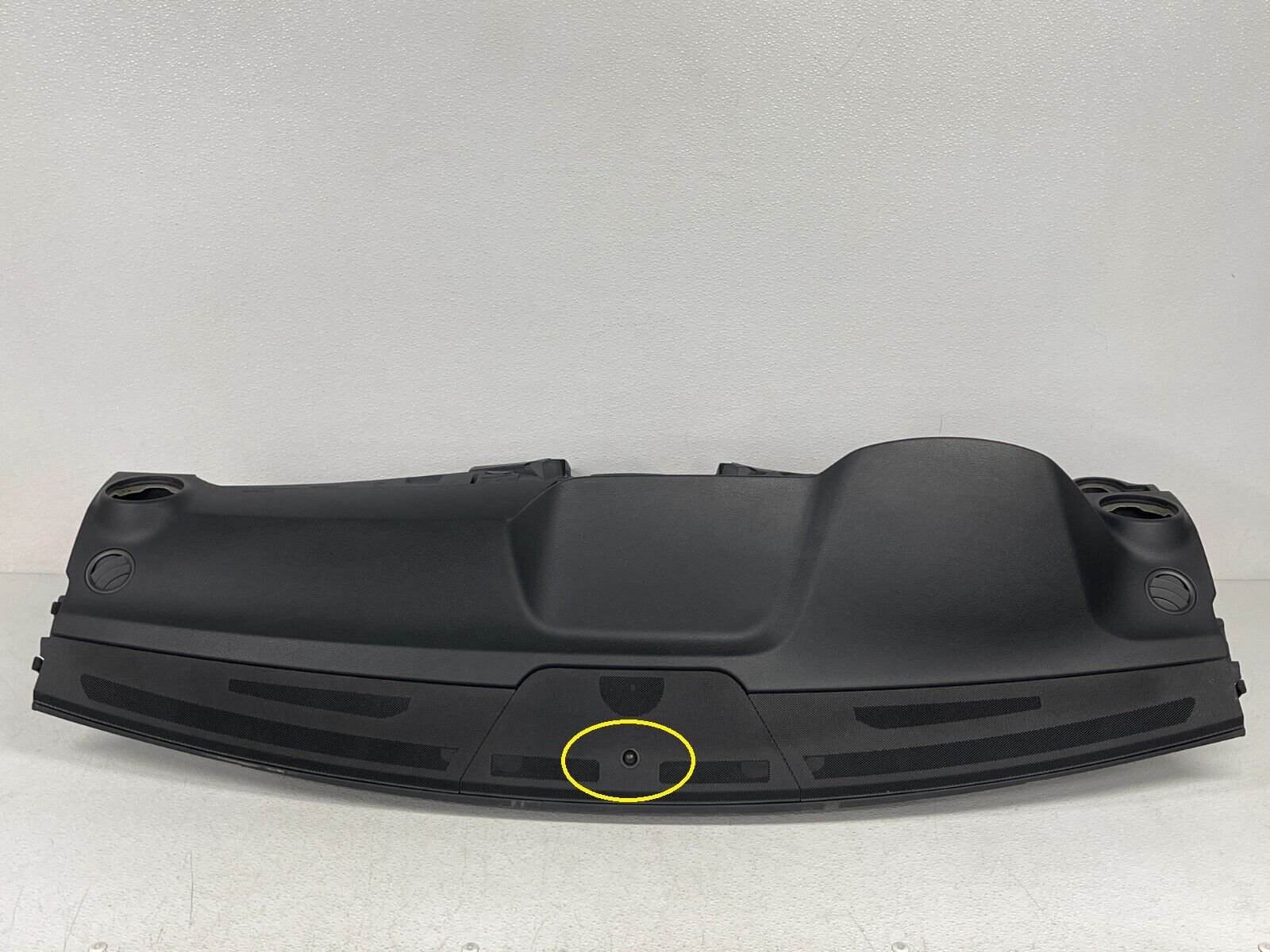

Would you mind help me find out what kind of the sensor locate on top center of dashboard near edge of windshield on C200 W204 2011.
Pls check below photo.

If I am not mistaken, that button looking sticking out is the light sensor that you didn't circle, what circled looks like a speaker.
Dear , Thank you for your reply. Yes i wrongly circled, now corrected.
Light and rain sensor is inside the rear mirror stick on windshield ? Thanks again.
edited: Could you help point out how to replace that sensor video ?

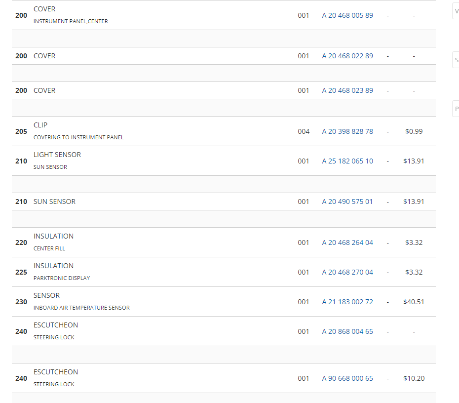

Looks like its labeled as a light/sun sensor. From the diagram it looks like that panel should pop off to access it.
Thank you very much Tim, its perfectly complete info.
You saved my time, i've been finding about light sensor replacement for few days already, only found rain / light sensor inside the rear mirror.
