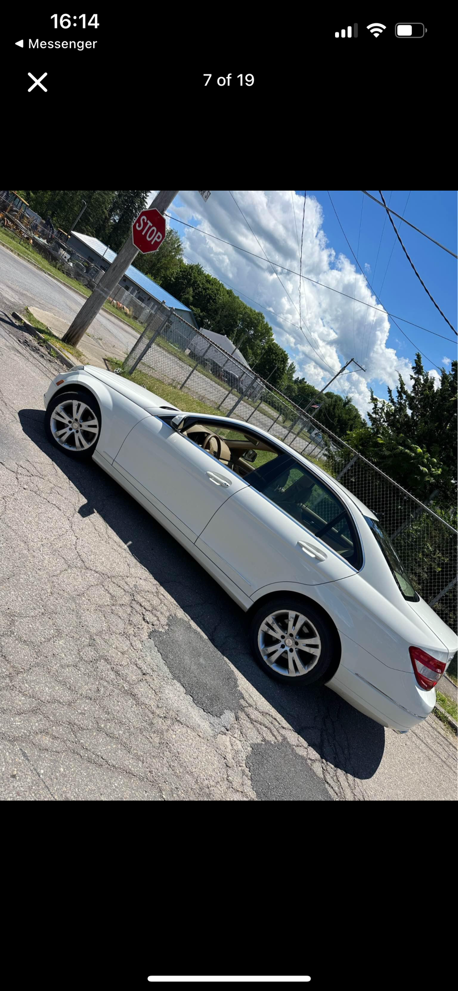

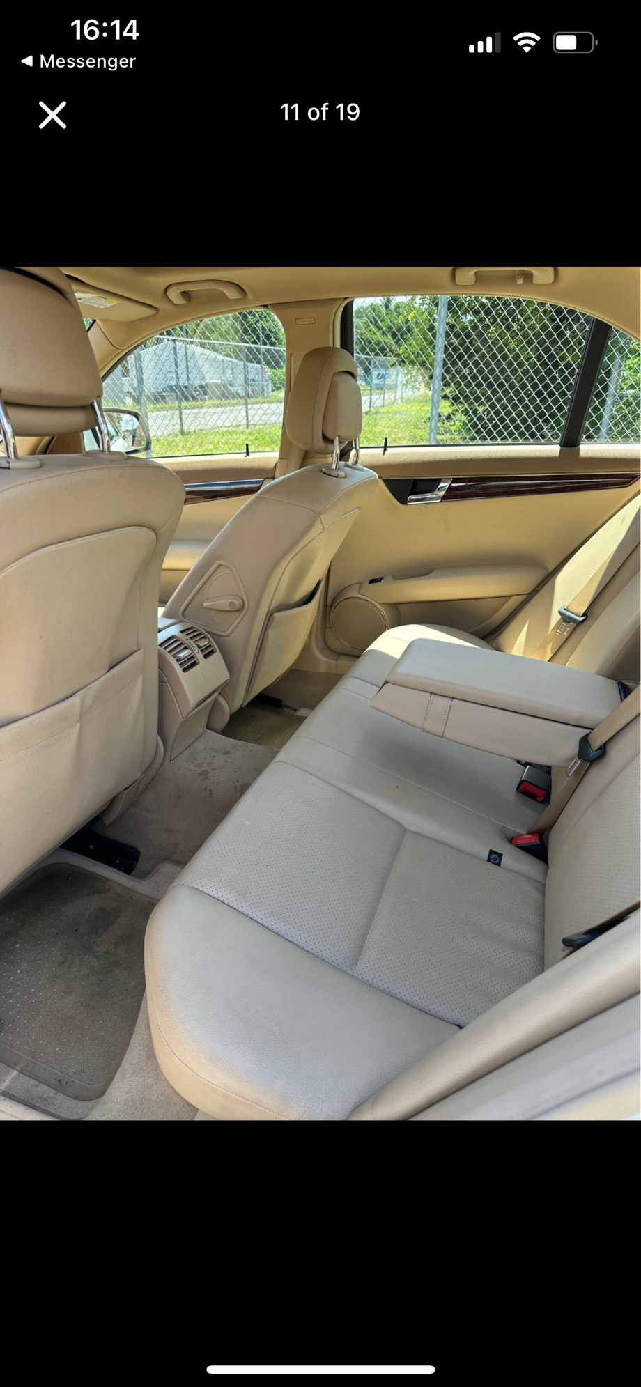

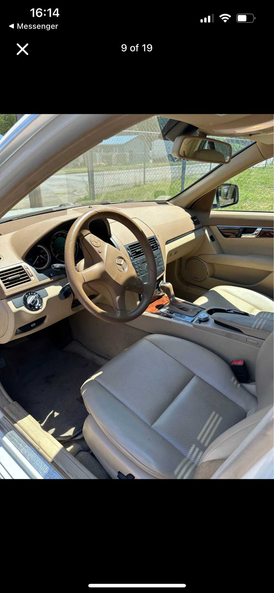

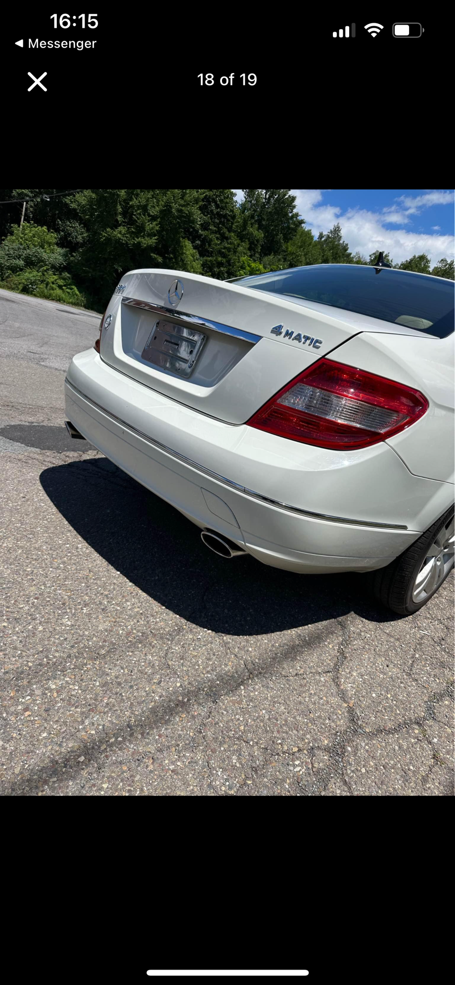

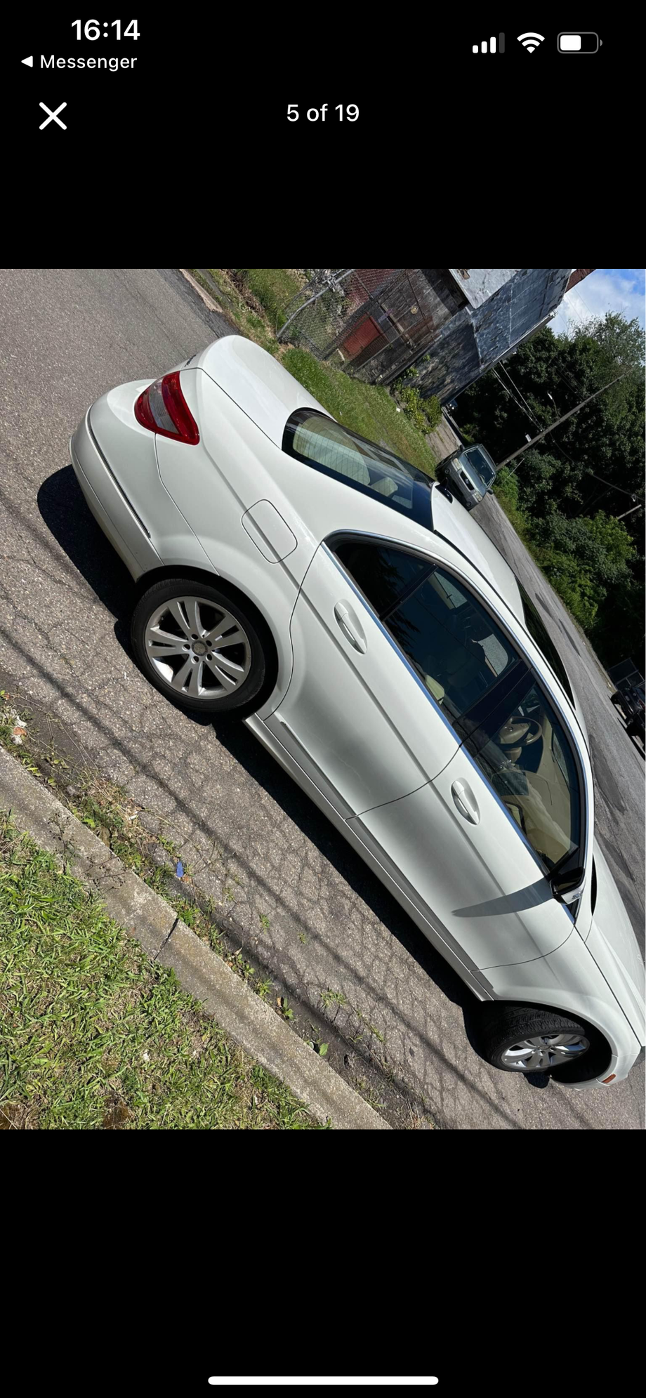

I’ve been posting on here for a few weeks looking for advice on my first MB, and I finally pulled the trigger on one yesterday. I put a deposit down on a 2008 C300 4Matic, pending the car gets the repairs it needs. It has a new MB battery, plugs and coils, wipers, all season tires, pads and rotors, front suspension was all redone as well as the rear control arms, and fluid changes done on time it’s whole life.
I am buying the car with the contingency that the current owner get two new genuine mercedes front axles installed, as well as get the car to pass state inspection before the final sale (didn’t pass due to the axles). The car has 177k miles but has been meticulously maintained and is in absolutely BEAUTIFUL shape. Paint is flawless, interior is flawless besides some button finish wear on the driver side door locks and windows (I plan to replace with new ones just to make it cleaner). I managed to negotiate the price from $5500 USD as-is to $4000 with the work done to it as well.
I’m very excited to be picking it up here in a few days, and I am a DIY’er as well. Any maintenance tips on these? What sort of schedule should I be adhering to for all fluids? I appreciate any advice and I will attach a few photos for all curious to see!

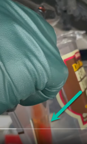

Red fluid used on early 7G trannies.
