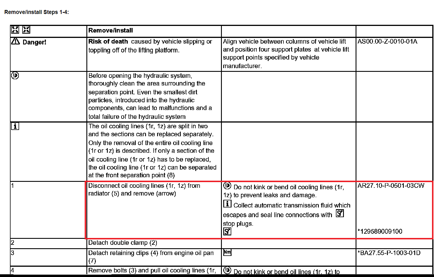

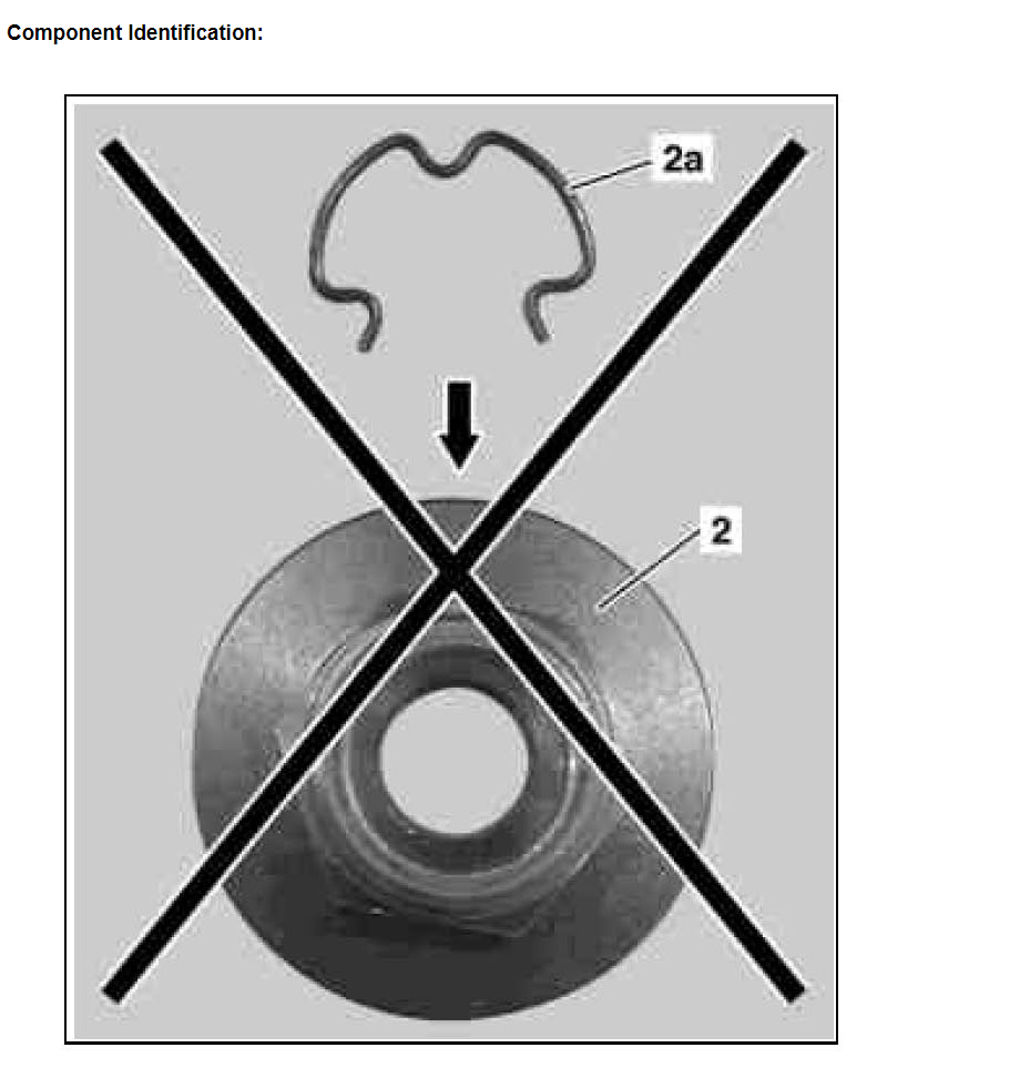

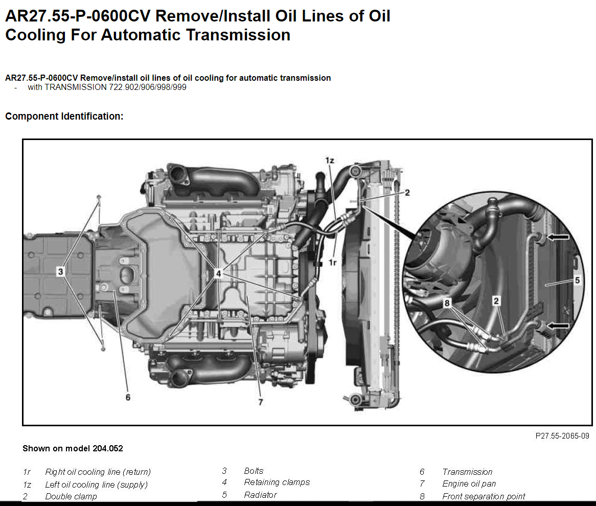

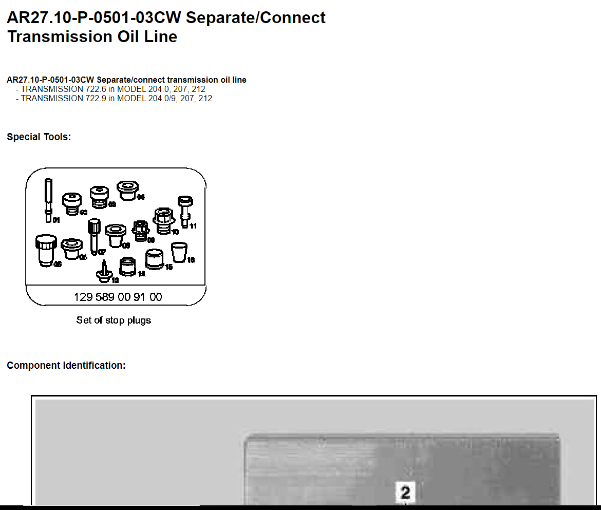

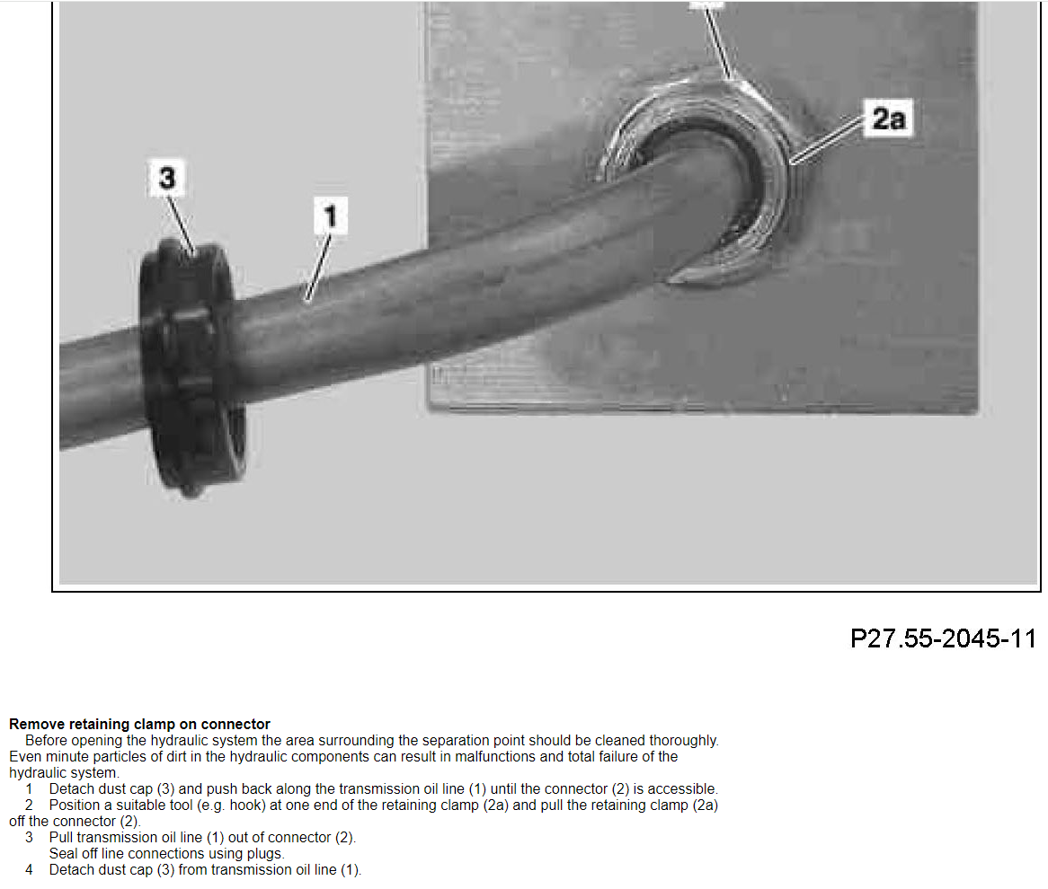

Appears there is a specific way to re-install the clips.
Heres how I found those instructions:
Looked up W204 radiator removal:
The highlighted in red seems to be instructions for removing the lines:
Finally how to disconnect the lines from the radiator:
