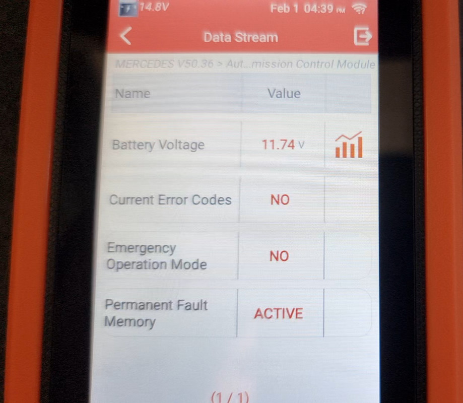

A while ago I commented about 722.9 failures what is happening to me. Today I provide data that I believe is very indicative.
Failure summary: when cold everything works ok. After several km of sporty driving, the gearbox jerks with gear changes and stops responding to the controls and the comfort/sport/manual modes and even the gear/mode indicators disappear from the dashboard.
Yesterday I received my launch x431 creader elite diagnostic machine and today I went to drive the car to cause the 722.9 to fail and that's how it happened; In fact, I have attached links with 2 videos of real-time data that I believe are the most helpful in diagnosis. Let's see if we can find the diagnosis 🤞.
I suspect that the alternator and/or regulator may be failing 🤔; but why does the voltage drop at a certain high temperature and when turning the engine off/on it returns to normal values?

Yesterday before leaving with the car, I deleted all the error codes, we went out with the car to cause the gearbox to fail and several videos were recorded.
I add an edit where you can see the generated DTC codes and what I thought was important.
I highlight the low voltage of the TCM (11.7V) once with the fault (and the car started) and that when turning off/on the car, the TCM recovers 14V but continues to fail.
The battery sensor shows 12.7V with the engine running and the TCM 11.7V. When turning off/on the car, both the battery sensor and TCM show 14V but the fault persists.

And now i have erased all dtc stored and the diagnosis show this:
https://usait.x431.com/Home/Report/r...us/timezone/+1
Is it possible that alternator/regulator fails at high temperature and that it cause low voltage?
Screenshot yesterday when the TCM was failed
Screenshot when car is cold and started
Thanks.

+1 for possibility of voltage regulator not regulating correctly for the upper voltage.
As per your screenshot, an alternator should put out peak voltagw sub 15 volt, depending on battery atate of charge. Screenshot show a much higger charging voltage, if it is indeed the charging voltage shown for that field in the tool. Electronics tend to show their faults more when warm.
Cold start car, check voltage as it warms up in idle? If starting with a fully charged battery the charging voltage should gradually decline.

Cold start shows a 14.6V...this tuesday i have to go to the workshop, i will comment they what you have suspected. Battery is new 🤷

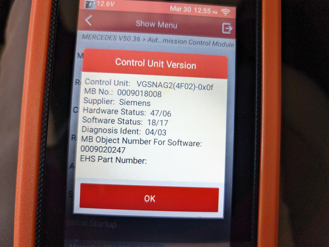

Finally, it seems like the gearbox problem has been fixed, except now it jerks when shifting from second to third gear in automatic mode... when I use manual mode, it doesn't seem to, and I say apparently because I've only had it for two days 😅; I've been told it's normal and that it should smooth out over time, although I have the feeling it hasn't adapted properly to the shift. I'm attaching a screenshot of the TCM module information that the diagnostic machine gives me. This TCM module is the VGS 3, right? From Continental? The board that isn't as affected by heat, right?

You can do a relearning with a good scanner. It will take a road trip and hitting shift points while driving. And there is a downshift/coast relearning too. You should do both of those and you will prolly see a significant positive change.
Most of the time you should never feel ones of these transmission shift at all.

What was the issue and solution to solving the problem? That is a good scanner in a sense but not good for re-adapting the transmission. If you did a fluid change, you could try a resetting the adaptation using the scanner although not always necessary. I am also not sure if you really should reset it as I don't know if resetting it using that scanner is the same as through official XENTRY method.
