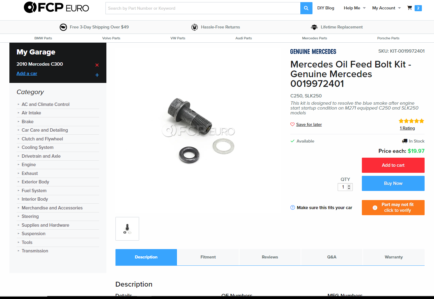

@WWrig - just an FYI- there is 2 crush washers that are needed for the turbo oil feed line on the banjo bolt side.
FCP only provides you with one crush washer in the repair kit, where as Mercedes provides both crush washers for the banjo bolt with the new line.
I purchased the repair kit from FCP as well as, the new oil feed line from Mercedes.
i go over that in the video I made.
ant

MB dealer is probably the best option if you just need the washer and o-ring. The 6513 part is $3.70 and the 8548 part is only $2.70. At least thats what its showing at my local MB parts dept. The bolt is $14.
