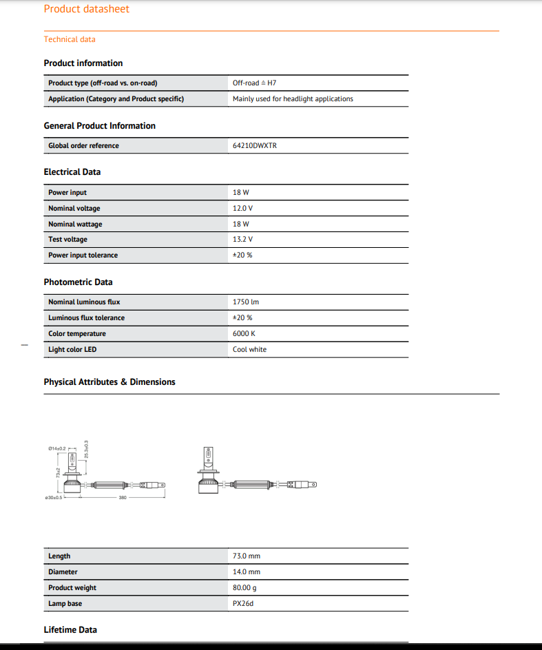

There is some sort of decoder/resistor attached, it says max 25-30w and I think I've seen somewhere else on the forums about 50watts, so maybe it's just not drawing enough power. The lights stay on with the ignition on, but as soon as I start it, I get the flicker. This is what I bought. https://www.eurocarparts.com/p/osram...-kit-48199022x

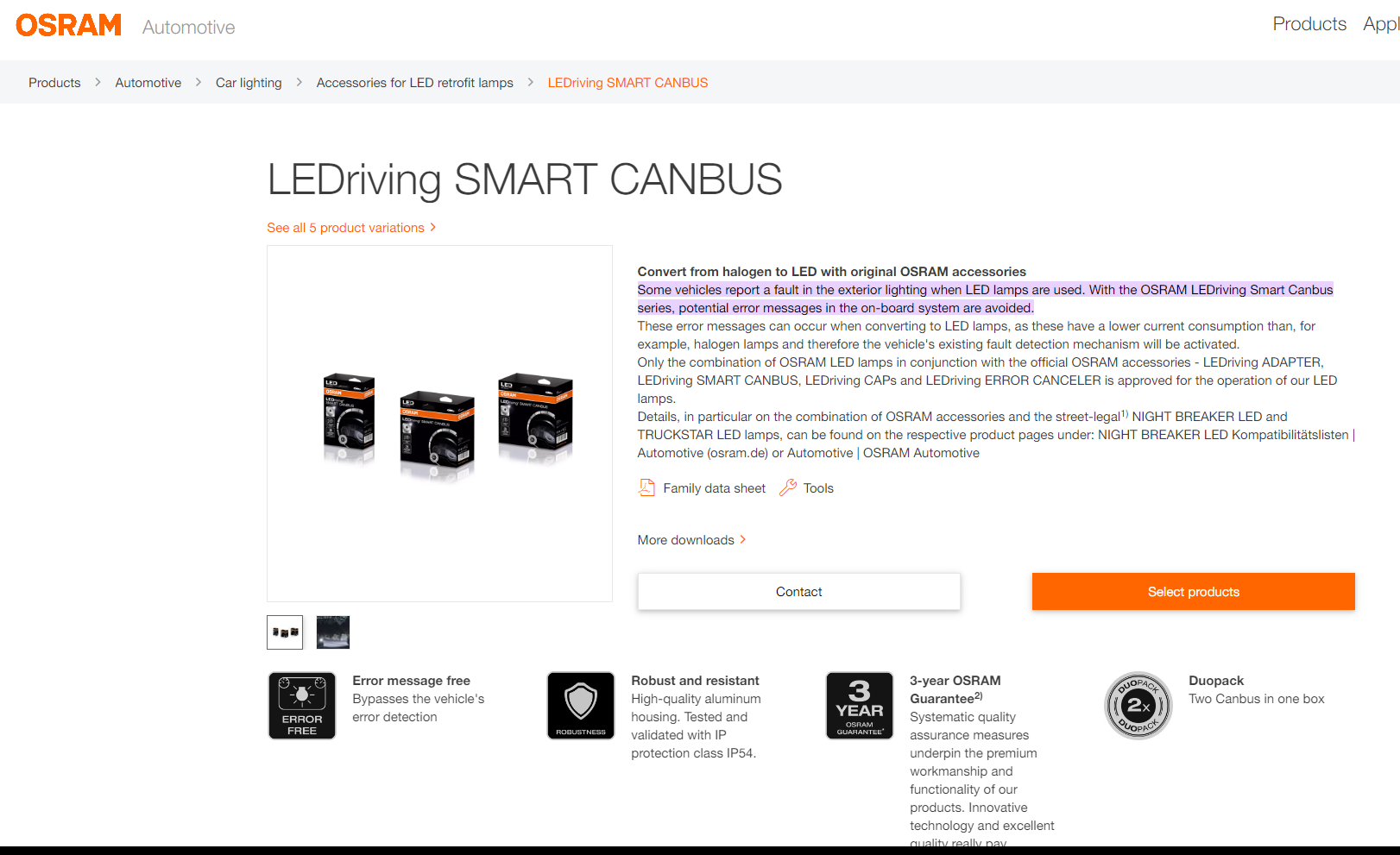

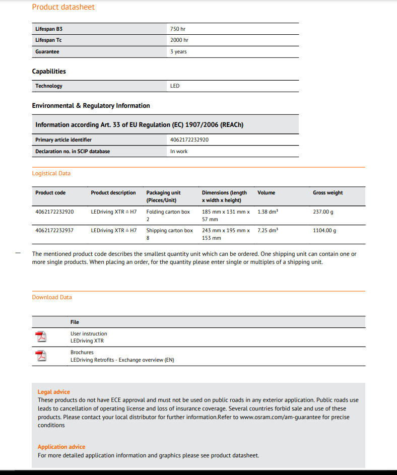

I looked them up and I do not believe that box is a can-bus/error canceller. I say this because it doesnt specifically mention it in the product info. And then those specific bulbs say off road, not legal for street. So im thinking off road applications wouldnt be running off can-bus, would they?
I think a specific can-bus adapter is needed. Can see the different can-bus options here: https://www.osram.com/ecat/Accessori...GPS01_2941742/

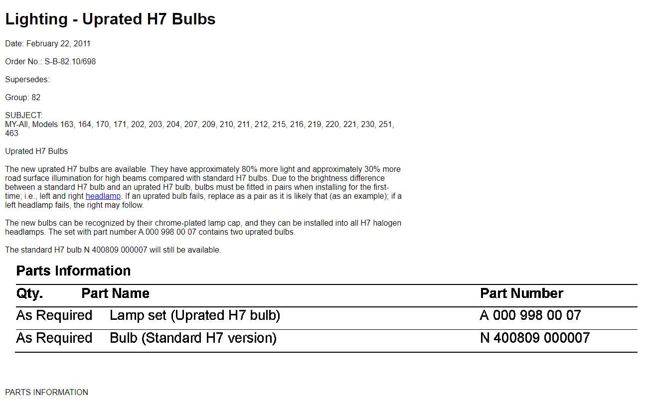

Mercedes has an "uprated H7 bulb". I believe they are philips X-treme vision bulbs.
