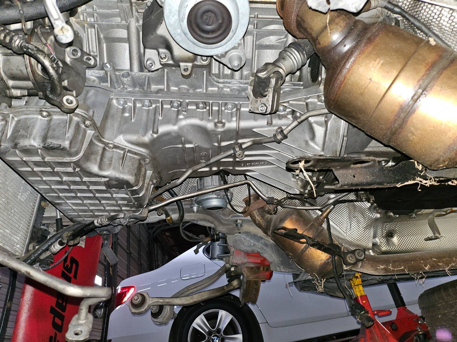

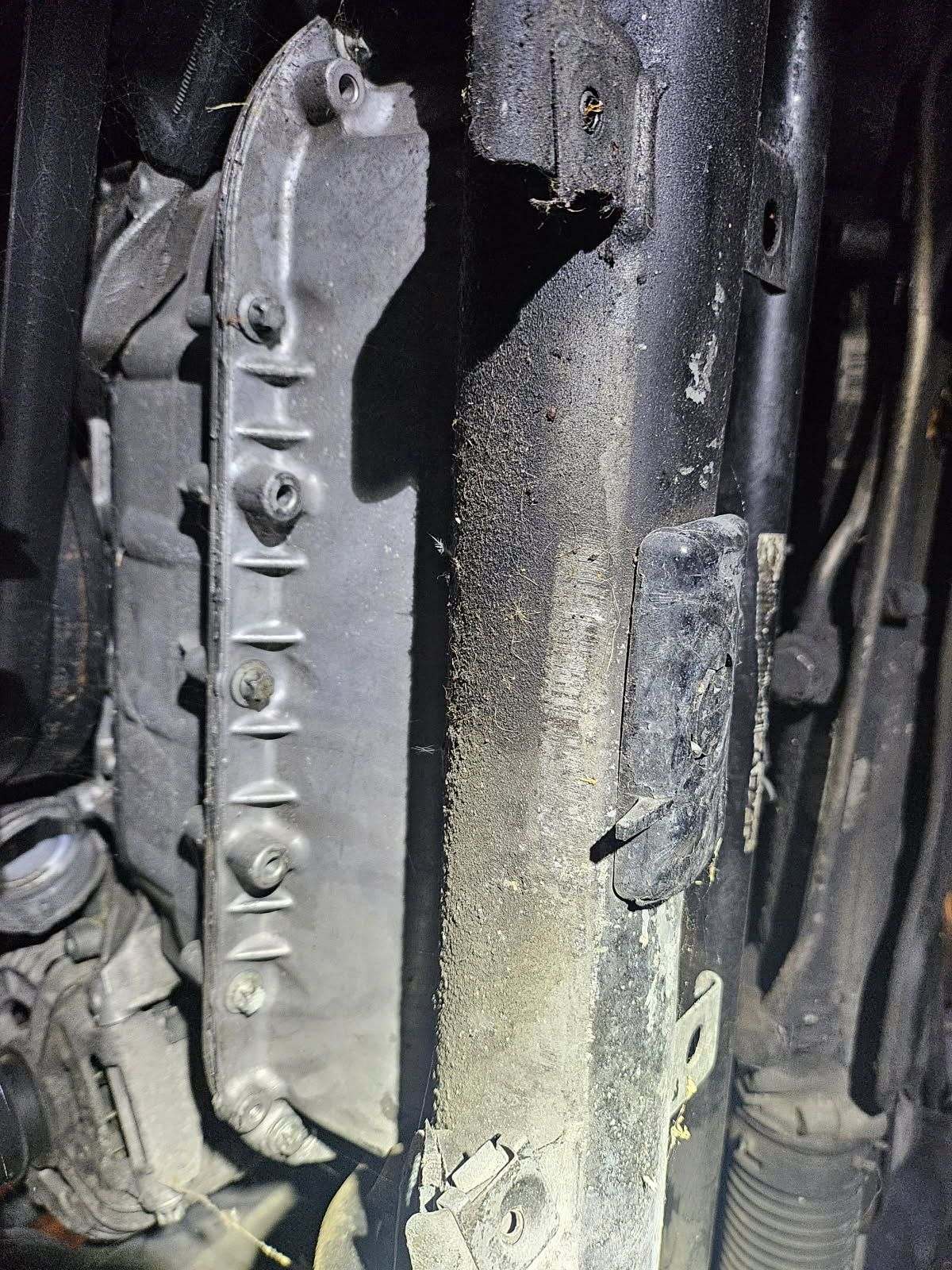

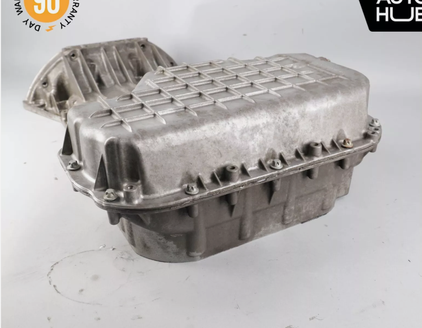

Good afternoon y’all, this is a question for those that did the m273 engine swap on the w204, so we ran into a little problem about the oil pan, since my friend that I bought the project from got the s550 engine, I was told to get the e class oil pan and I’ll be fine, well the e class oil pan has 4 bolts but the s class has 3, now it probably won’t fit. I know of somebody that also used the s class engine but lost contact with him so I am hoping there is still somebody out there that knows the exact correct oil pan I can use. Your help will be very appreciated.
The first picture is the 2010 e class oil pan and the second picture is the s class oil pan, still on the s class engine (not sitting right because the sump is in the front)

If im understanding correct those two pans you show will mount to the engine. The bottom photo shows the bottom pan, but above that inside the pan are the 4 bolt holes to mount to the engine. The bottom photo showing "3 bolts" are the bolts going to the upper pan.
Im not familiar with the M273 but I have the M272 and I know there are two different pans depending on if its 4matic vs RWD.
Heres the top view of the pan in the 1st photo: Forward on right side
Heres the top view of the pan you show on the bottom. Forward on the left side.

So basically what I’m getting is that the sump bolted to the front is what makes it seem like it has 3 bolts instead of 4 and if the sump is removed, I will find where the 4 bolts fits? Thanks so much, makes a lot of sense, I will keep yall updated.

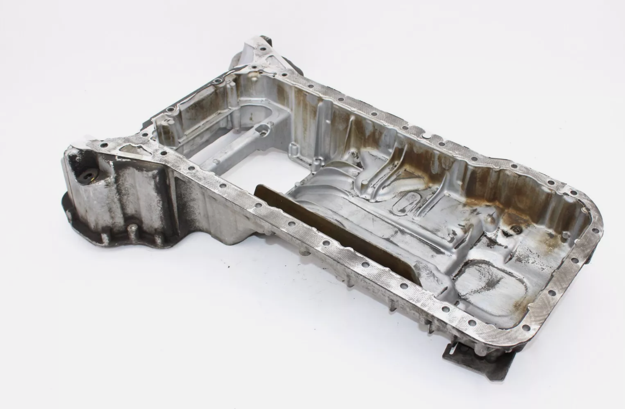

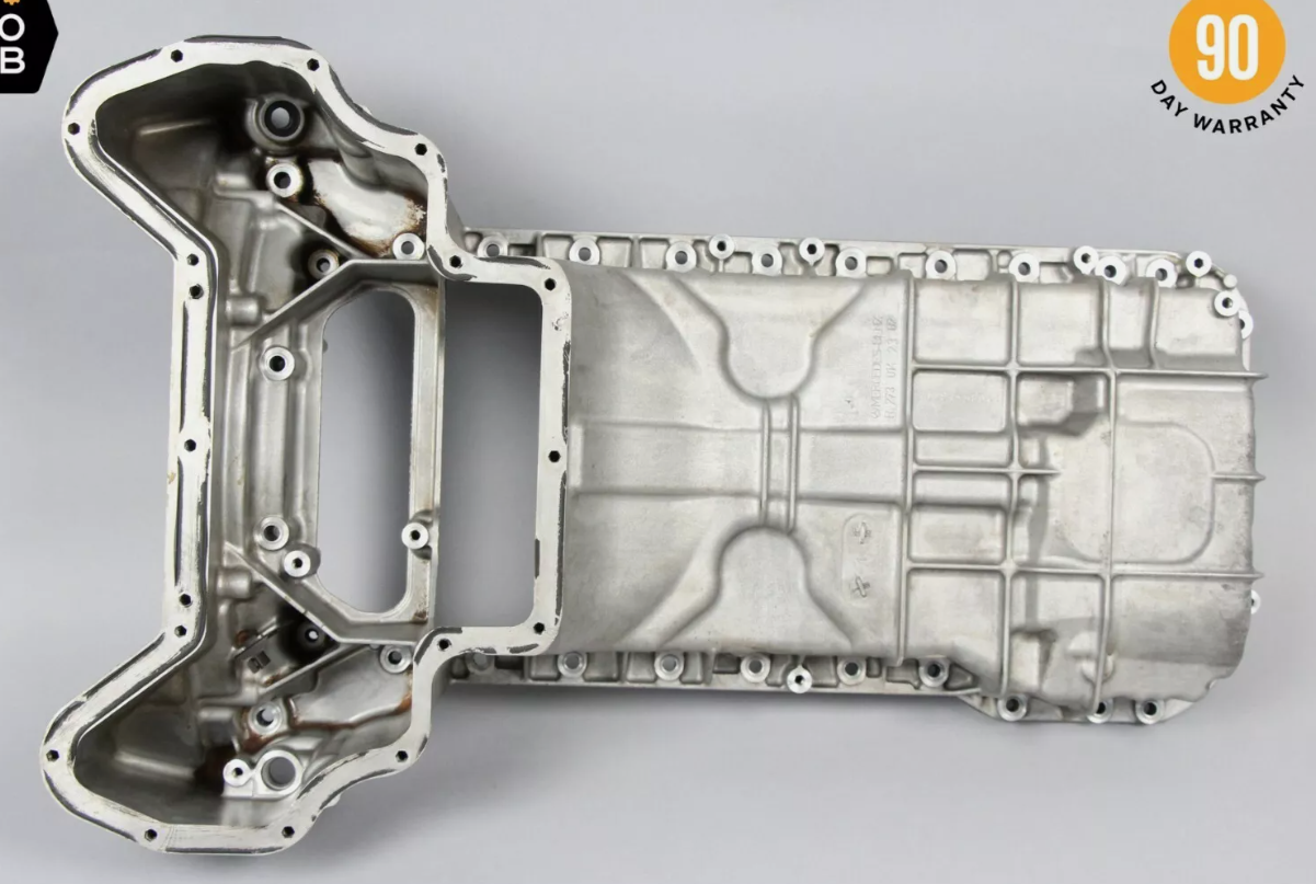

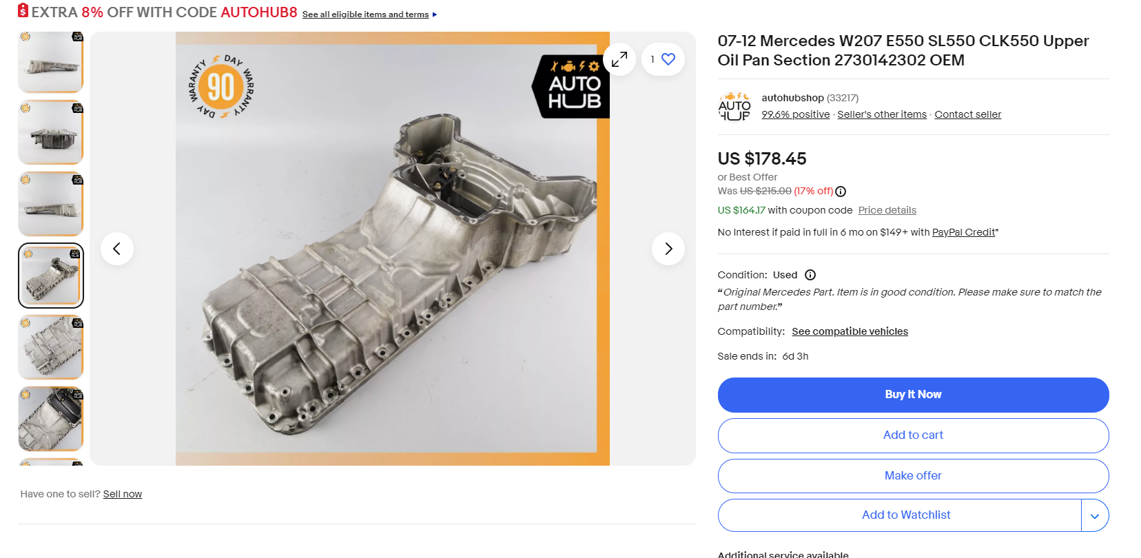

I went on eBay and searched for "Mercedes M273 oil pan". Then scrolled through for all the different oil pans that are shown.
This pan has part# 2730142202
This pan has part# 2730142302:

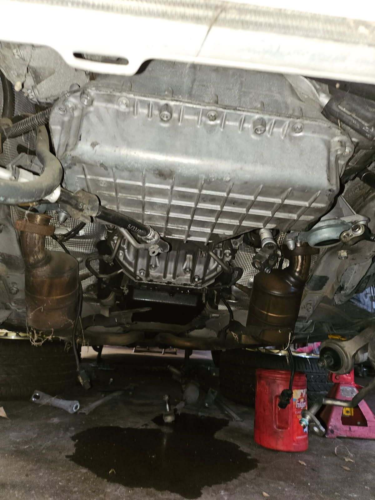

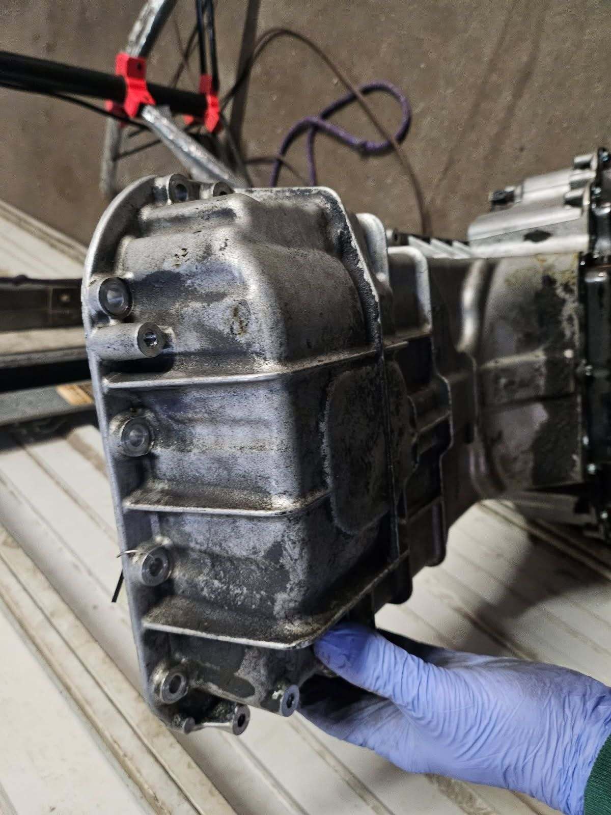

I got the C550 up in the air today and got a picture of the front of the pan for you. It's kinda hard to see in there with the full radiator stack in place, but you can see the 4 bolts on it.
C550 Front of oil pan
you are correct, currently in the process of taking it off.
thanks so much, this made me confident that I should be fine, I was about to start looking into getting a custom pan made, thanks so much, I will keep yall updated.

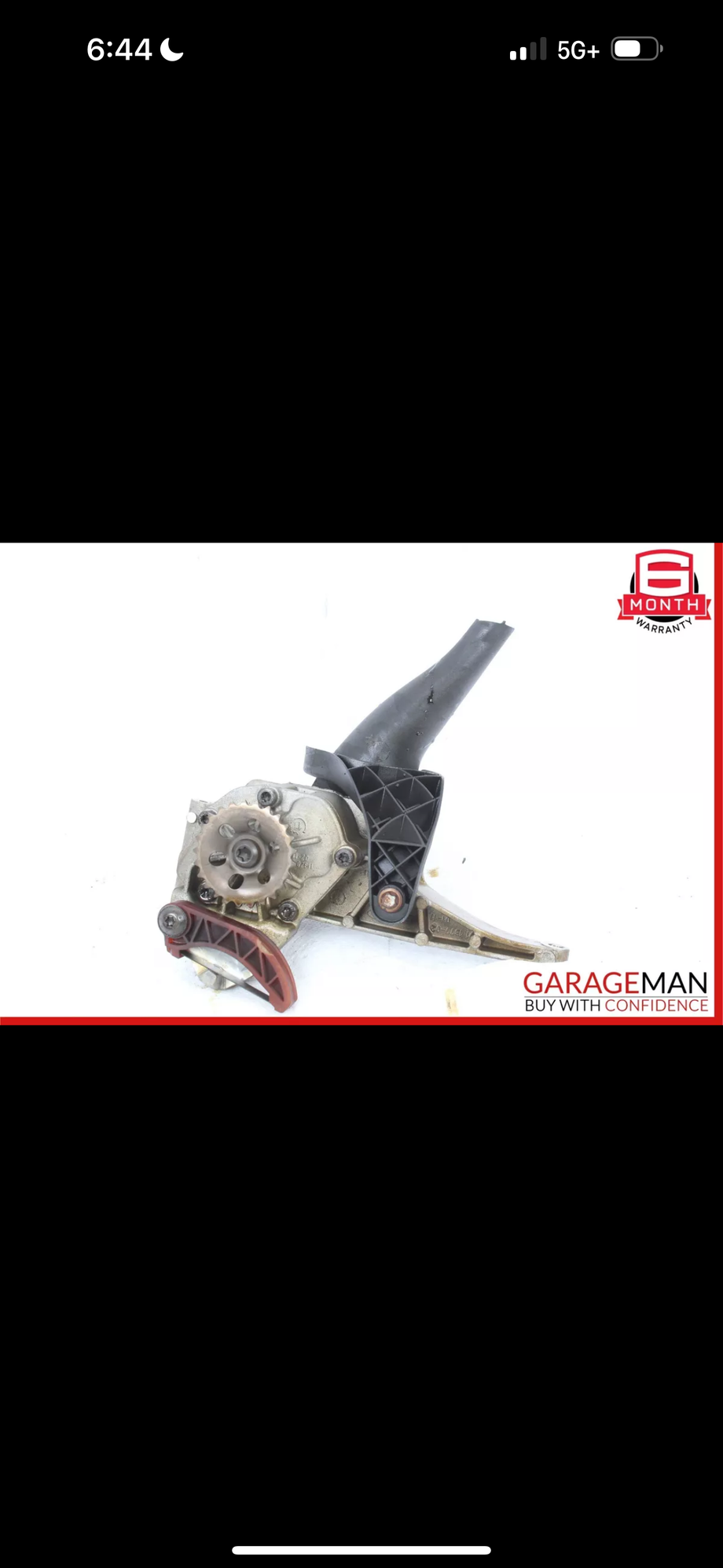

yea I figured, is it the black plastic type of pick up tube? Just trying to know if I got the right one.

Did yours look like this? Or you had the metal tube?

You'll need the long one. The pump stays at the front of the engine, but the sump moves to the back when you swap the e550 pan on.
Cls550 oil pickup tube

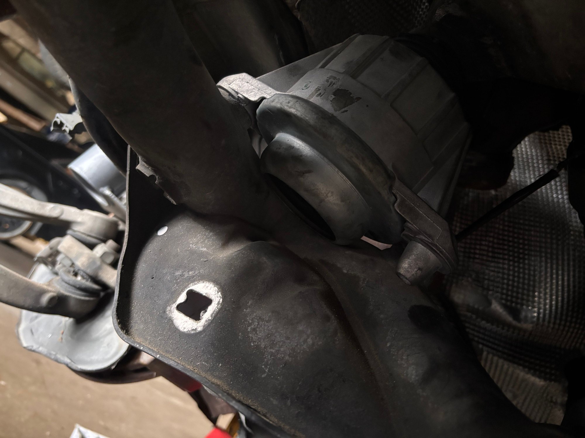

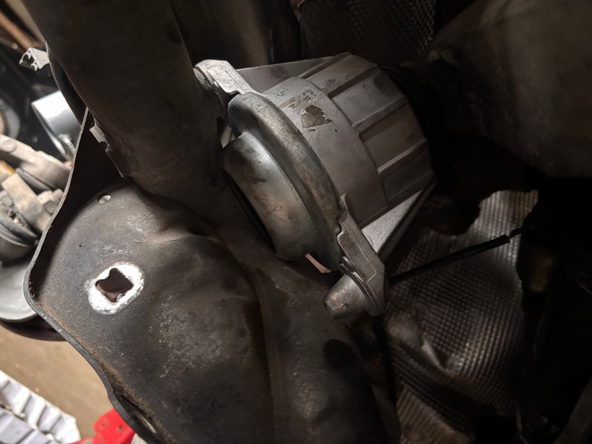

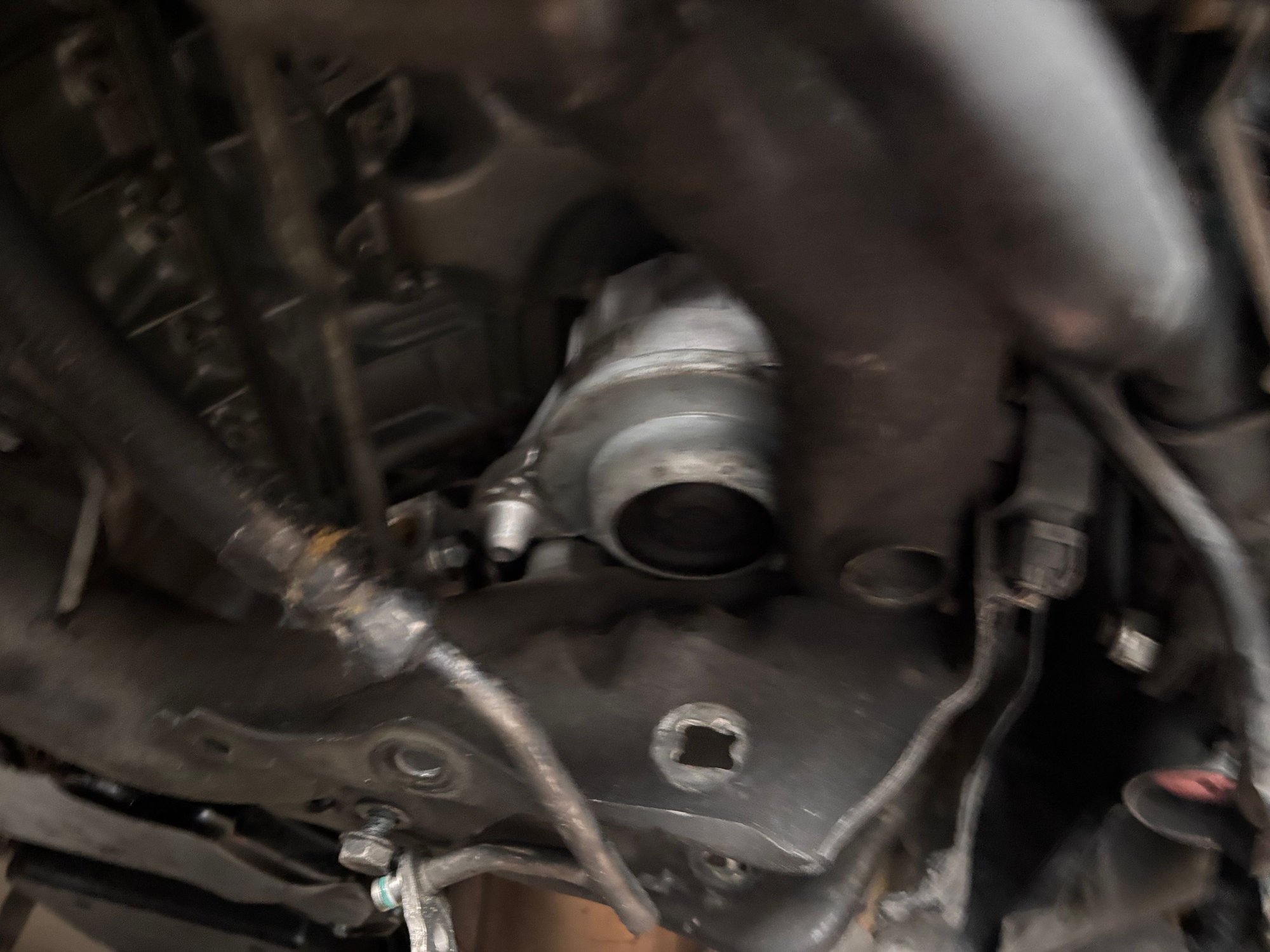

thanks, just got the pickup tube a couple days ago, the oil pan fits perfectly, new problem is the motor mounts, the offset is not right so the bolts are not allied, what did you do? Did you get custom mounts? Or what part number did you get? Thanks.
Can’t really get a good picture but yea it doesn’t sit right.

You'll need the V6 motor mount brackets and C350 motor mounts. The brackets directly replace the V8 brackets minus the rear AC compressor brace. I just cut that part off the V8 brackets using a hacksaw. You'll see what I'm talking about when you look at the brackets.
Don't do what I did initially and use an abrasive based cutting disk or tool on the aluminum brackets or you'll ruin it. The aluminum is soft and just fills the gaps in the abrasive instead of sparking/burning off the way steel does.

Sorry, can you explain the ac compressor brace part a little better? Are you saying I have to cut it? Thank you.

You need the V6 brackets to offset the motor mounts to fit the subframe. The left and right brackets bolt directly onto the V8, but because the V8 is longer, the V6 AC bolt hole is too far back. You'll need to add something to mount the rear of the compressor and the easiest way is to just cut the section off of the V8 bracket.
